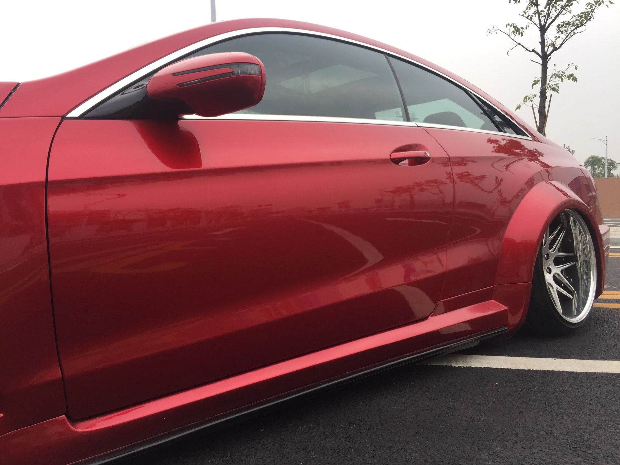

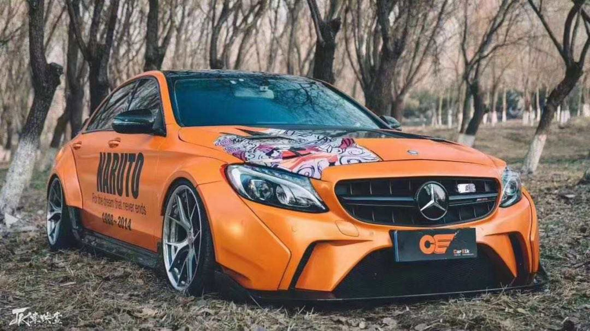

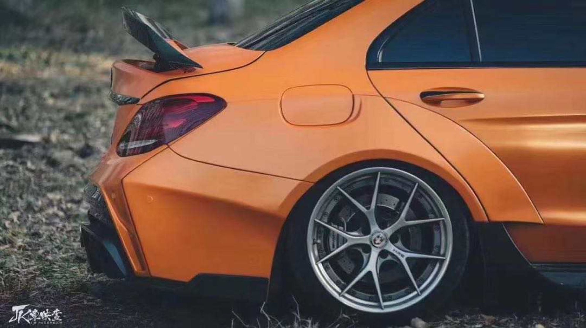

UPDATE. Happy 4th!
Thanks for following and Happy 4th of July to everyone.
Been a minute but here is an update on the project.
Finally glad to see things moving again, car has been shipped and taken delivery by my man Cesario and his team at SVG, Silicon Valley Garage.
Motor should be pulled next week after initial dynojet dyno and engine build begins.
Also decided to take it in the direction (apologies to the purists, couldn’t resist) with custom carbon fiber trunk and interior work as well as a full wide body kit and wrap.
Thinking about going with the Pearl AMG red.
Hopefully the build keeps moving forward to get this out to AMR for turbo installs/Meth/Tune upgrades and TCU tune.
cheers!
Silicon Valley Garage. Thanks for the connect Chris!
Wide body pic 1
Wide body pic 2
Wide body pic 3
Pearl red wrap to match carbon fiber/red interior & exterior

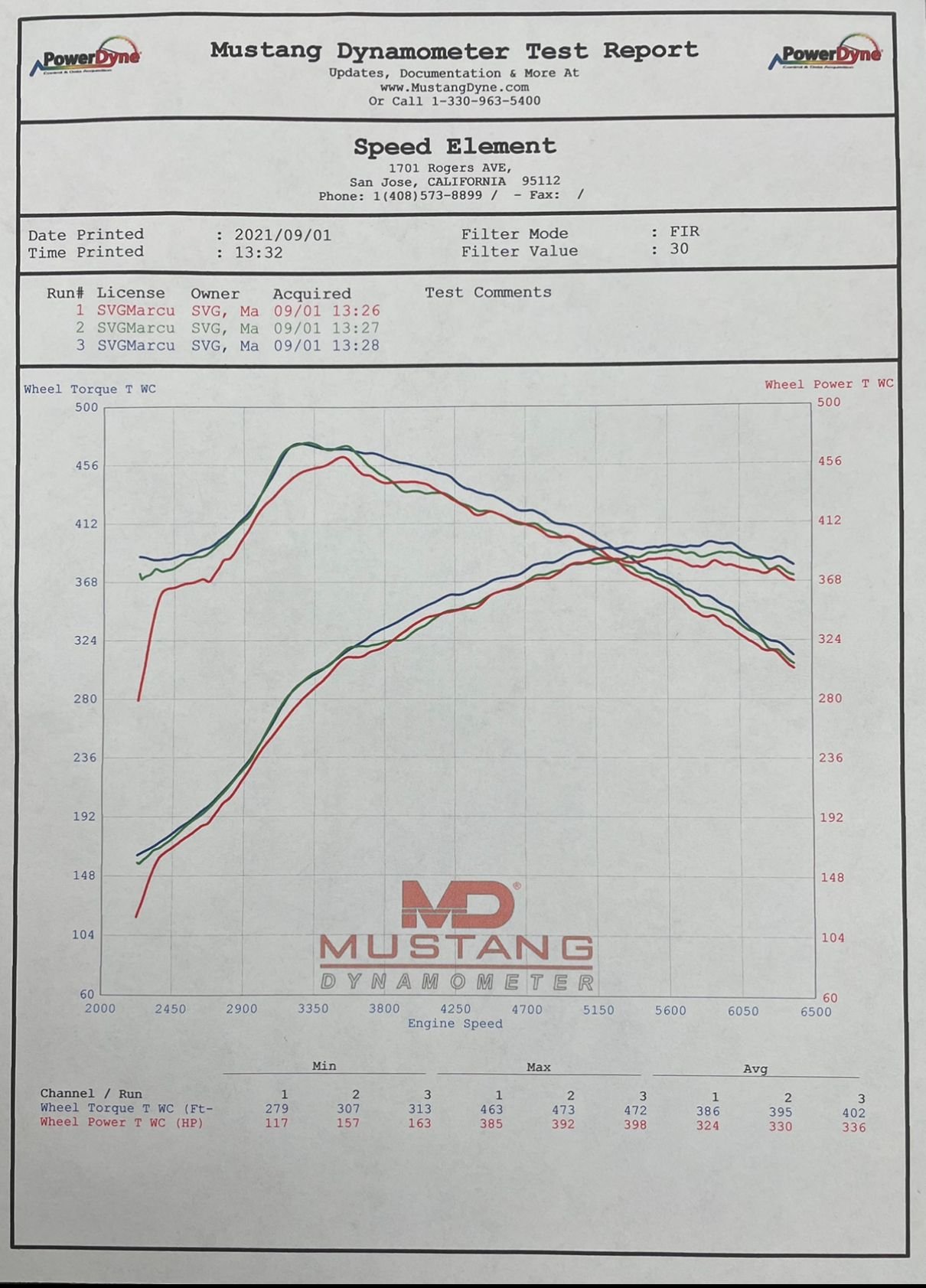

Hello all and hope this finds you all well.
Just an update, so SVG has been doing well and has expanded to a much larger shop so things have been moving along as expected for a “no rush” project.
That said we have been looking for a
dynojet dyno similar to the one AMR in CT has so that apples can be compared to apples with the pre build dyno and post build final tuned dyno.
unfortunately where my man Cesario is at there isn’t any to be found around within a reasonable distance. What seems to be common is the Mustang Dynometer.
So before the engine is pulled decided just to get some base dyno numbers.
So the base is with the AMR Stage 2 bench tune, Weistec DP’s, VTA’s, and AWE track exhaust on 93 octane pump on Sport+ mode.
Pre-build dyno
When all is said and done this will be compared to dyno numbers with the upgraded turbos, forged Pauter rods and low compression JE pistons, full upgraded fuel system, Wagner intercooler, upgraded HP and LP pumps, Water/Meth, AMR custom tune and TCU tune running on E85.

Are you pushing for 550-600 awhp? The stage 2 numbers are impressive by them selves. I'd be curious about the tq curve with the new set up. Stage 2 would be like a quick punch than fades. New set up would, I assume (gasp I know) be more linear?
Keep it up dude. It's only money, right?!

I believe Mustang dynos read low compared to Dynojet ?
​​​​​​As on a Dynojet this car would typically Dyno 415-425 whp with those mods .
