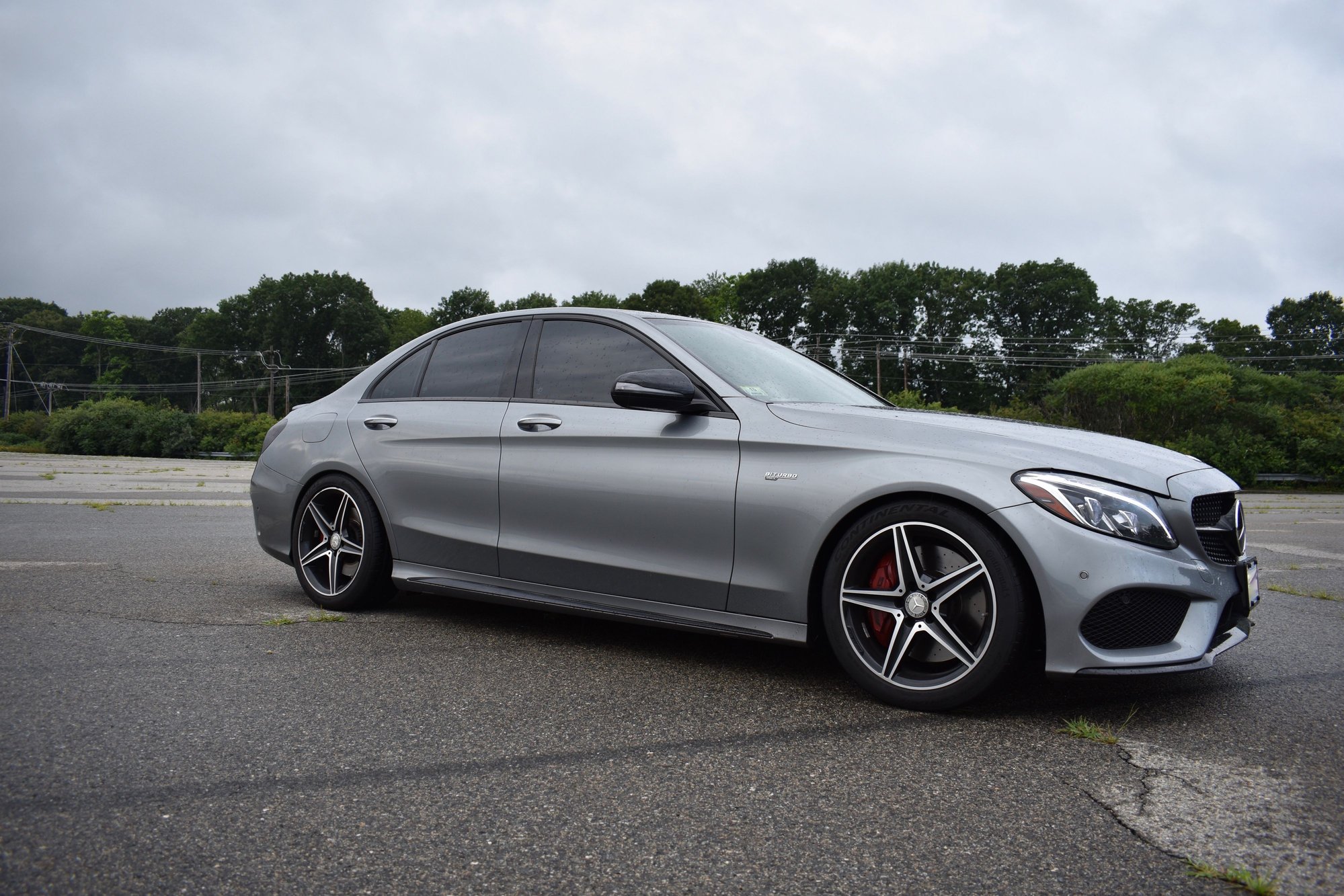

H&R 15mm spacers part# 3075725SW
H&R 20mm spacers part# 4075725SW
https://www.ecstuning.com/b-h-and-r-.../3075725sw~hr/
https://www.ecstuning.com/b-h-and-r-.../4075725sw~hr/

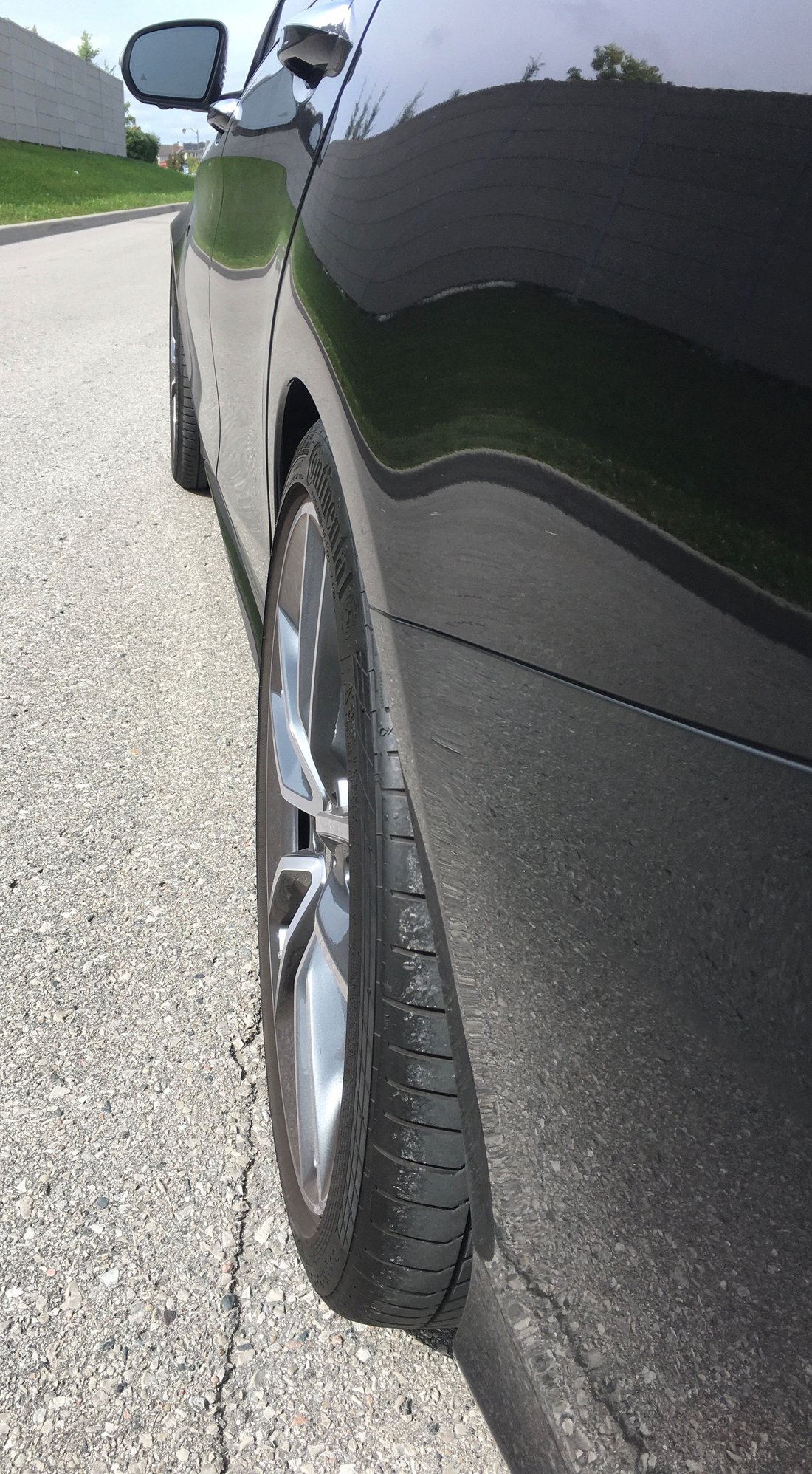

This is the setup I have on my C450 sedan as well as the H&R sport springs and it looks perfect.
Front: 15mm Rear: 20mm on stock 18"

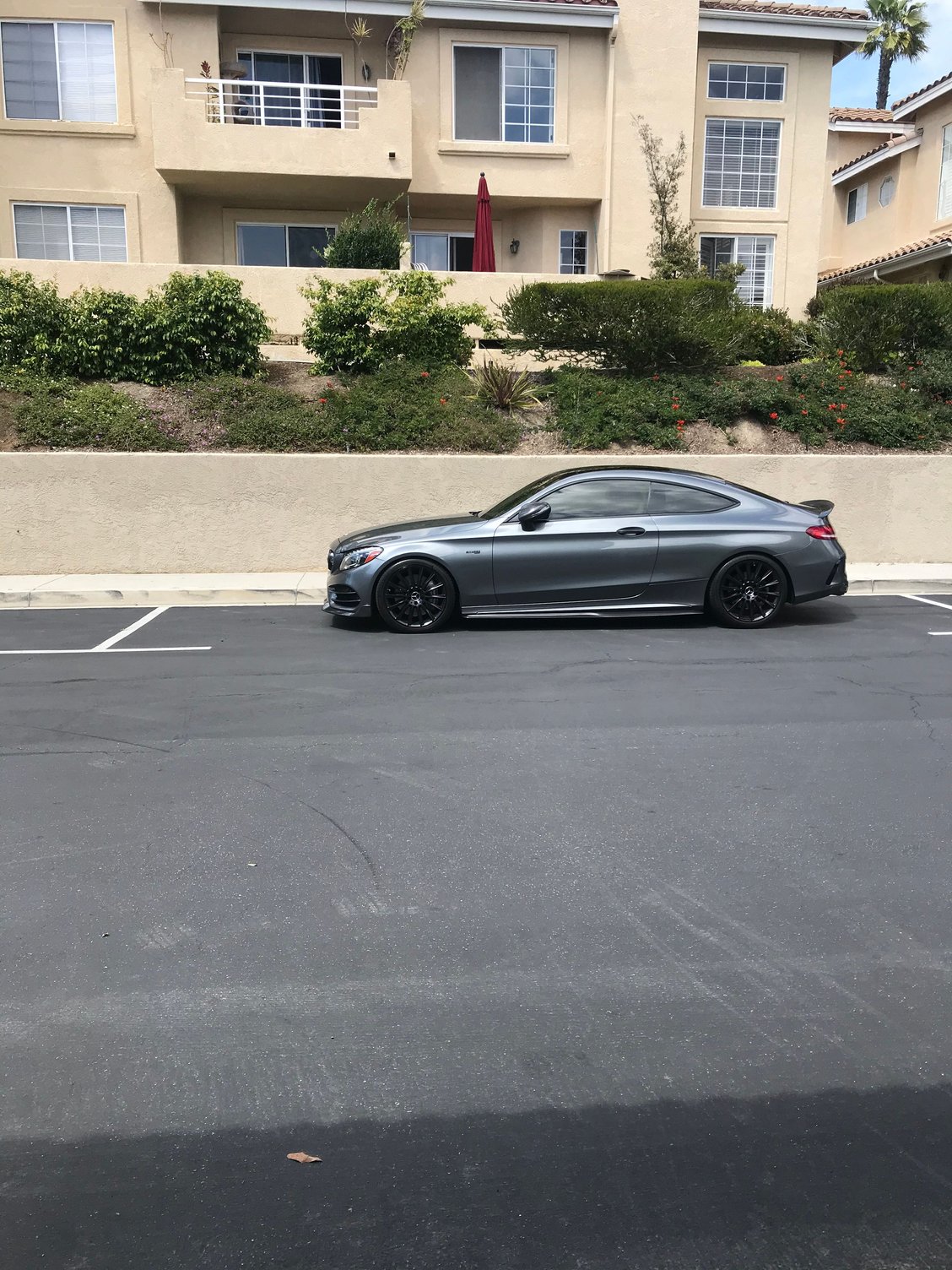

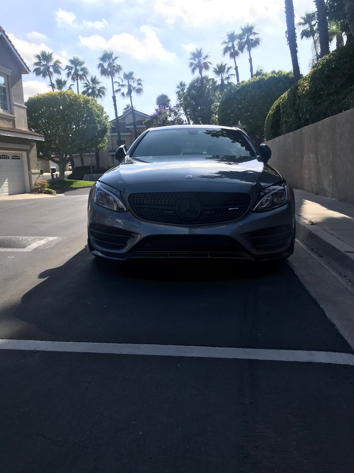

Looks sweet! Any more angles (side, front, rear)? Looks CLEAN!
Old Oct 10, 2020 | 03:15 PM
toosteeley's Avatar
Joined: Jun 2017
Posts: 447
Likes: 138
From: Toronto
Present: 2019 C43 Estate

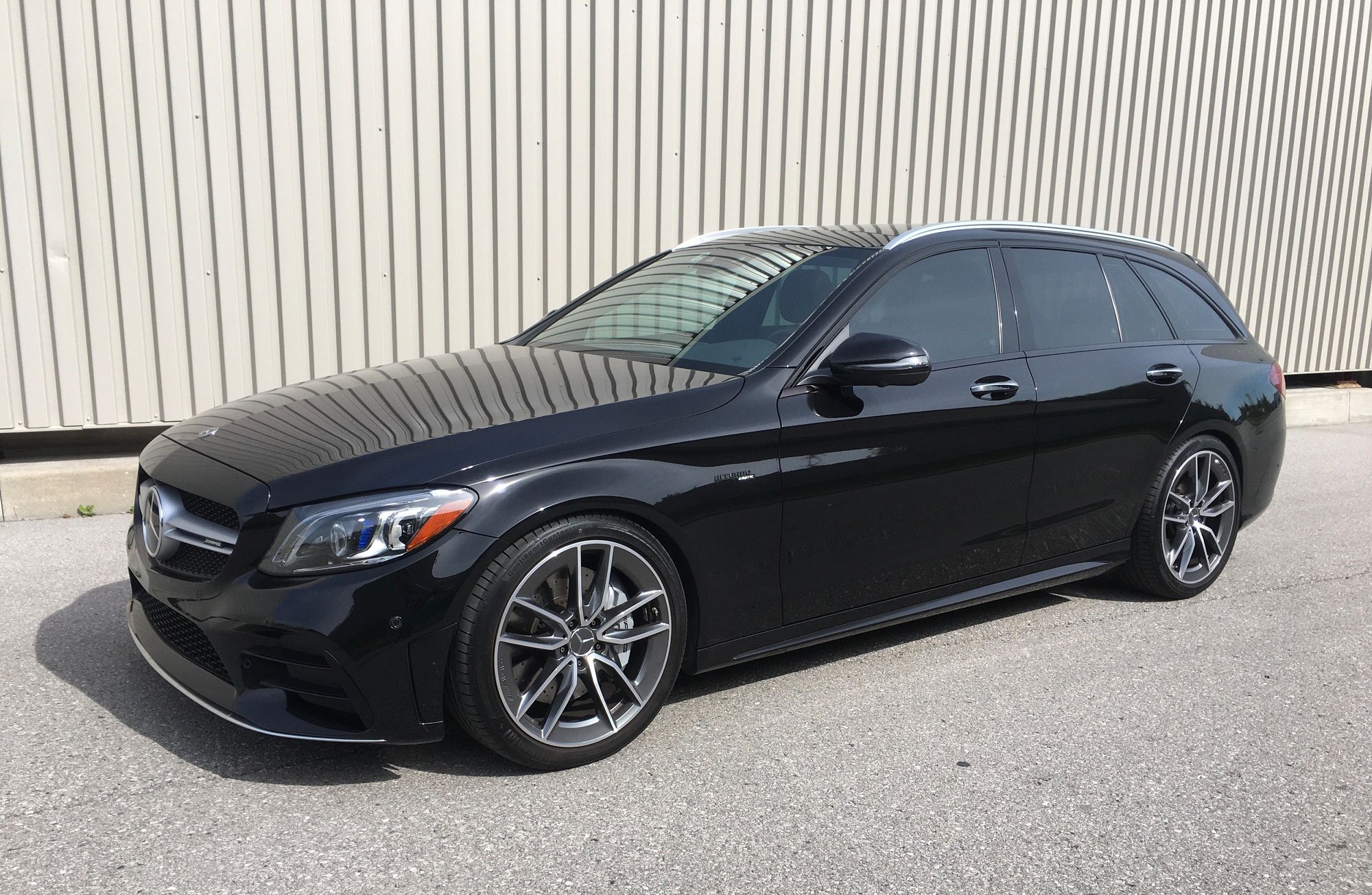

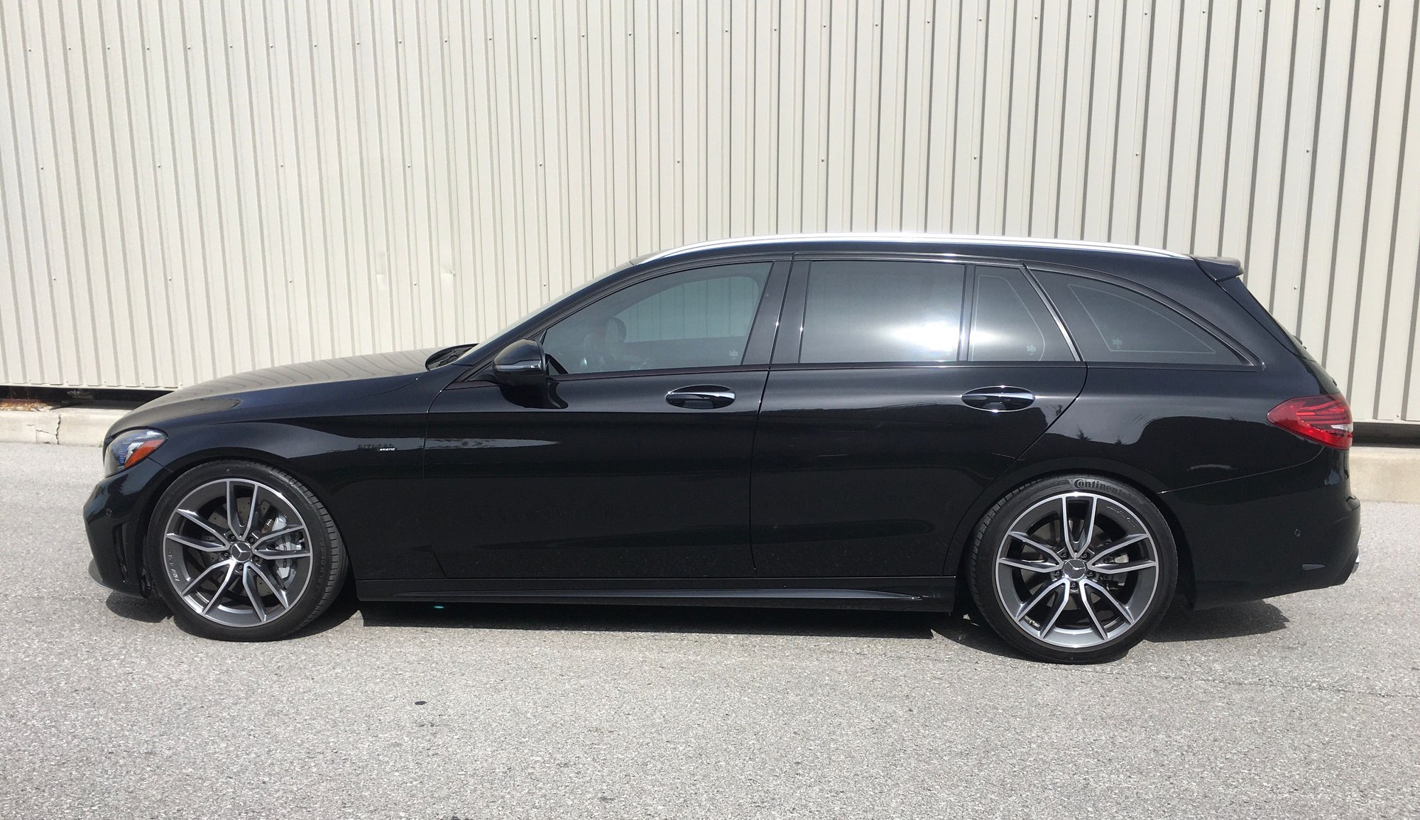

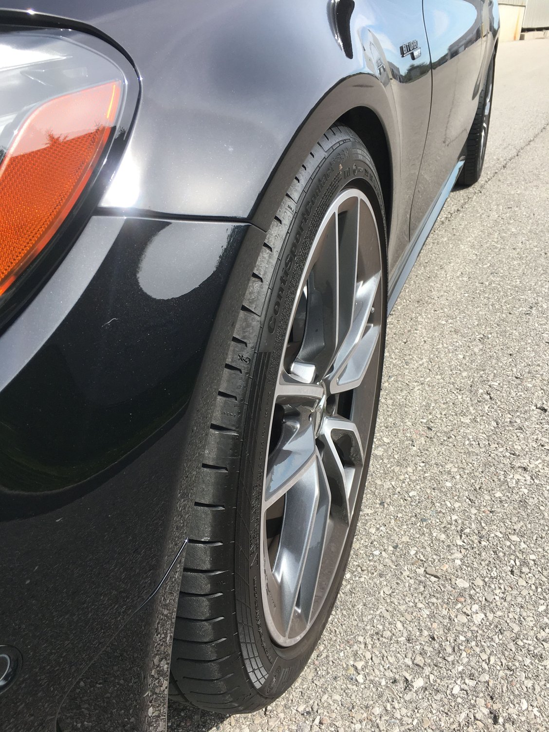

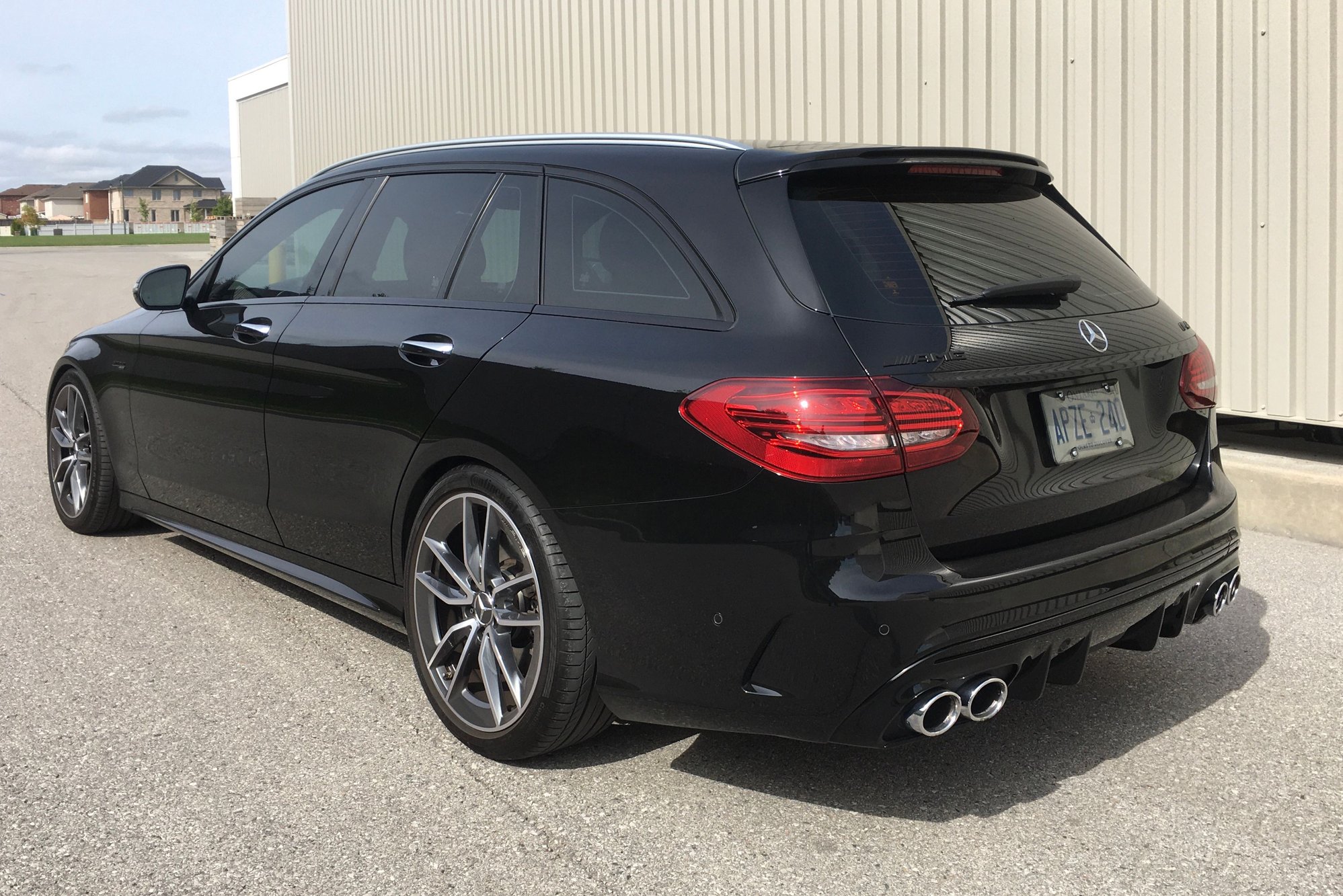

H&R wagon springs, stock 19” wheels, wheel stud conversion and 10mm front/15mm rear spacers:
20mm in the rear would definitely fit.
Old Oct 10, 2020 | 05:22 PM
C43HeartBoost's Avatar
Joined: Oct 2019
Posts: 841
Likes: 315
C43

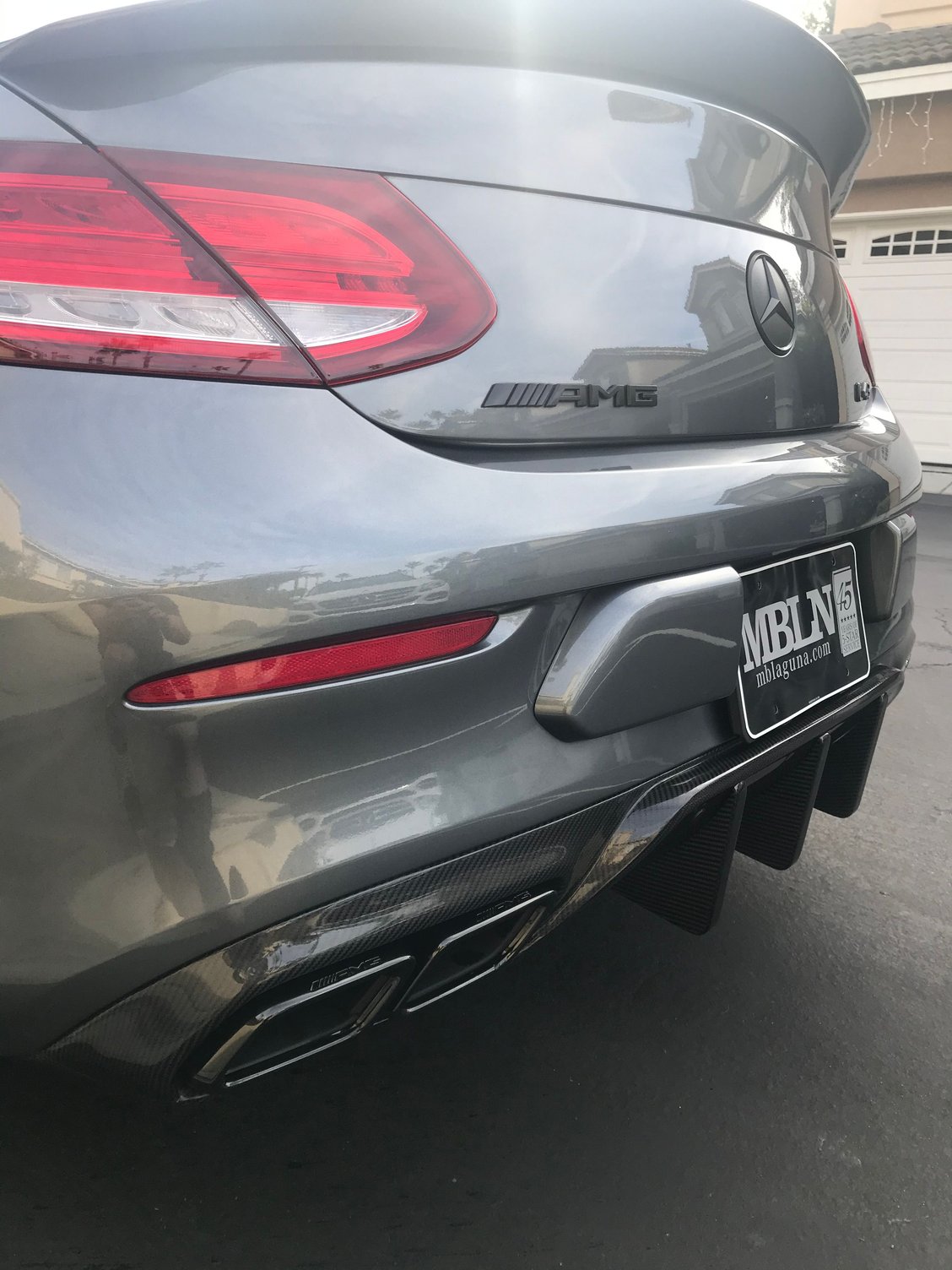

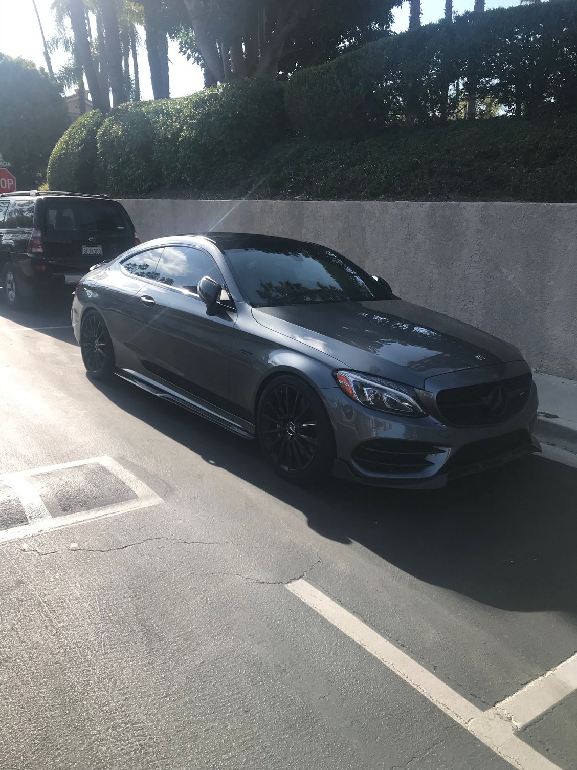

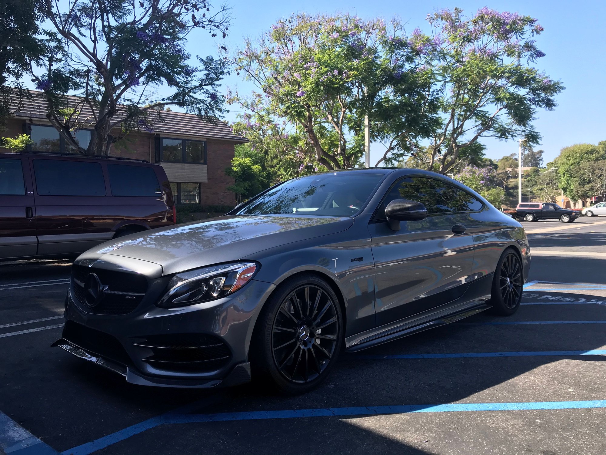

Thanks man. Here are a few more:

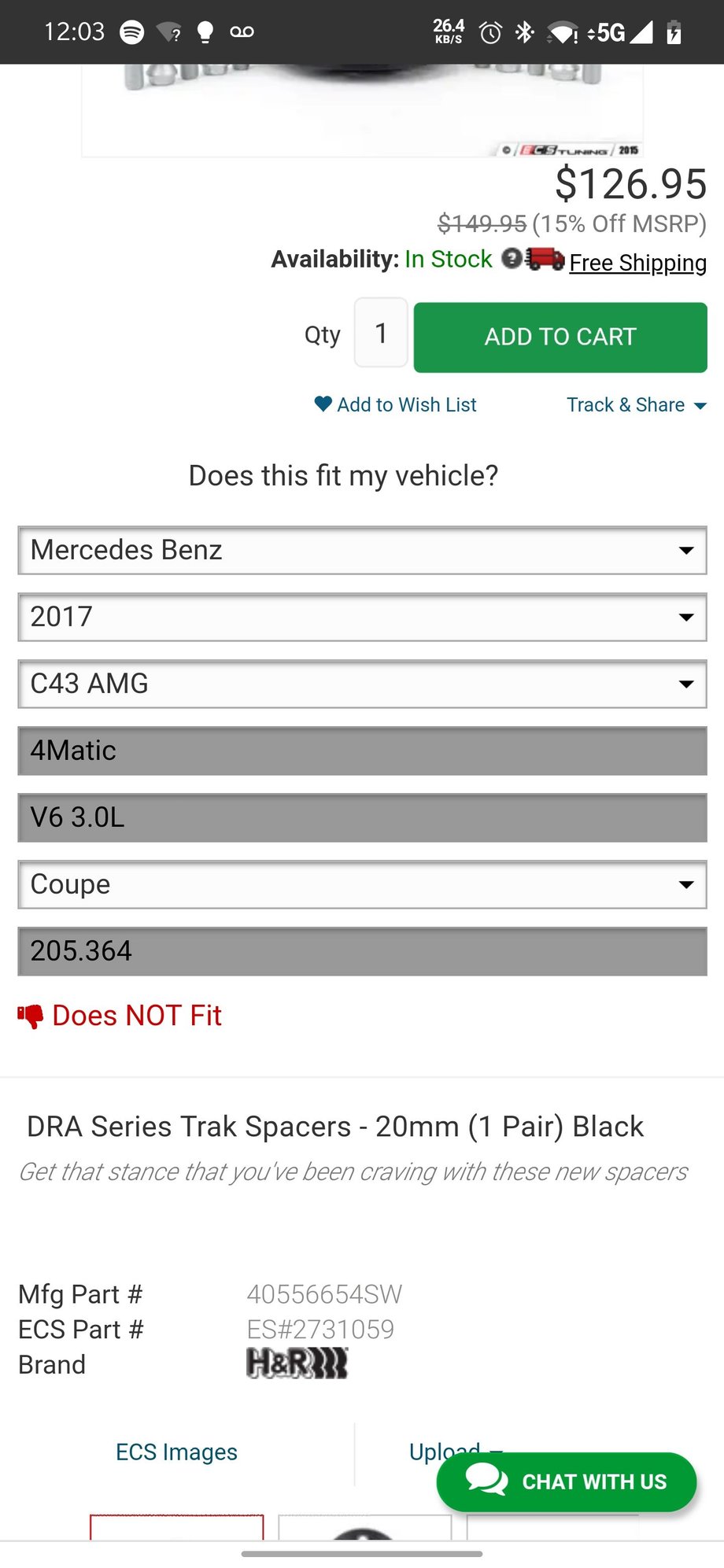

Why when I select these do they say they won't fit? I bought HR VTF springs
