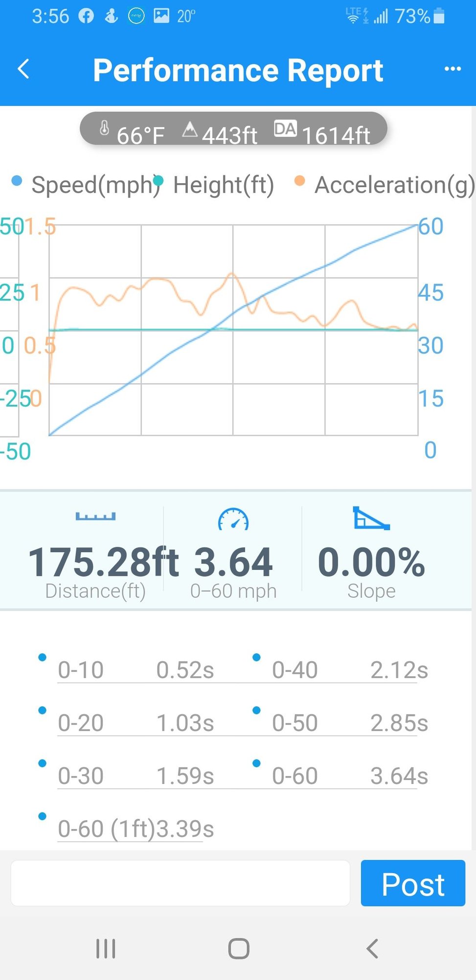

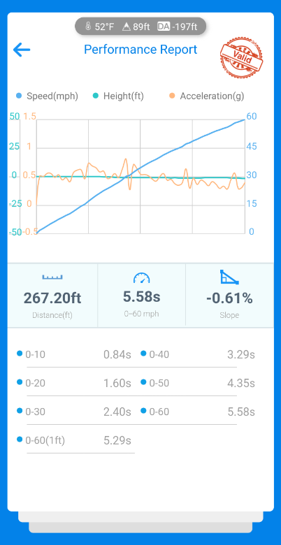

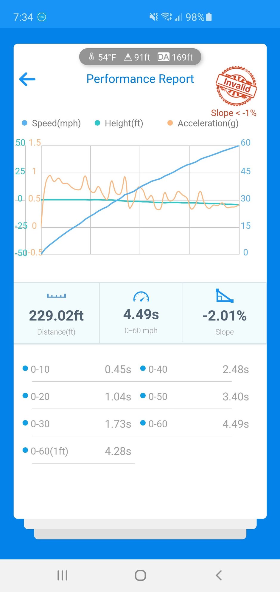

Trial # 1
Trial # 2
Trial # 3

Tried again and got better results. I reduced the tire pressure to 37/38 both front and rear. I turned traction control off completely and got following results when I brake boost off the line. If I don't brake boost and just mash the gas pedal I still get 5.2 seconds (only one time managed to get in 4.7 seconds)
With Brake boosting

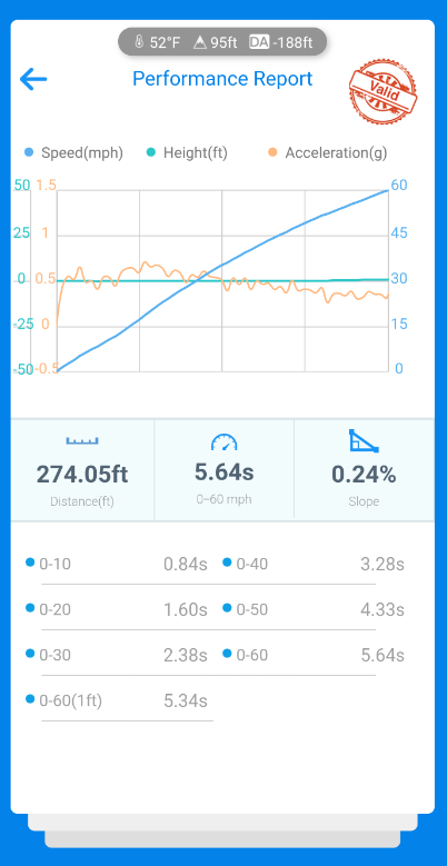

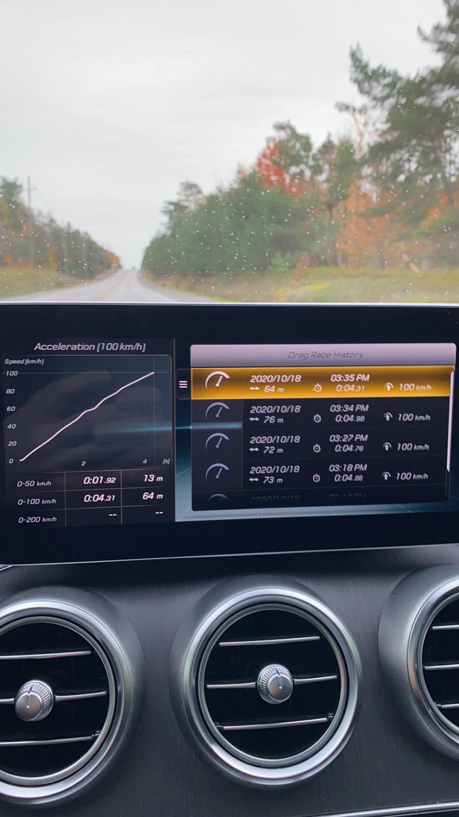

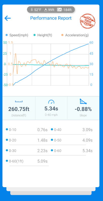

I still think there's something not quite right right. Below are my 0-60 times from the Track Pace app in the car. 91 octane gas and car maybe warmed up for 10 mins.

LOL! Yes, the rain started after the few runs I did. Nothing wrong with my car though - I was more showing OP that I'm getting 4.2 - 4.7 sec 0-60 times with little effort.

I think the wording of my post was misleading - There's nothing wrong with my car
