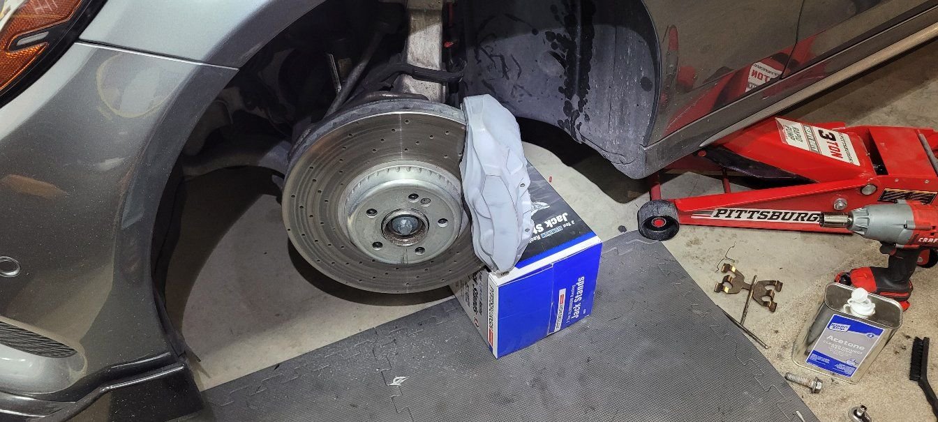

Do it yourself man. It's not that hard. There are YouTube videos which are pretty helpful. Set aside a weekend, take your time and prepare and make sure you have any tools and parts to do job correctly. I did mine a few months back and changed the color of my rotors while I was at it .

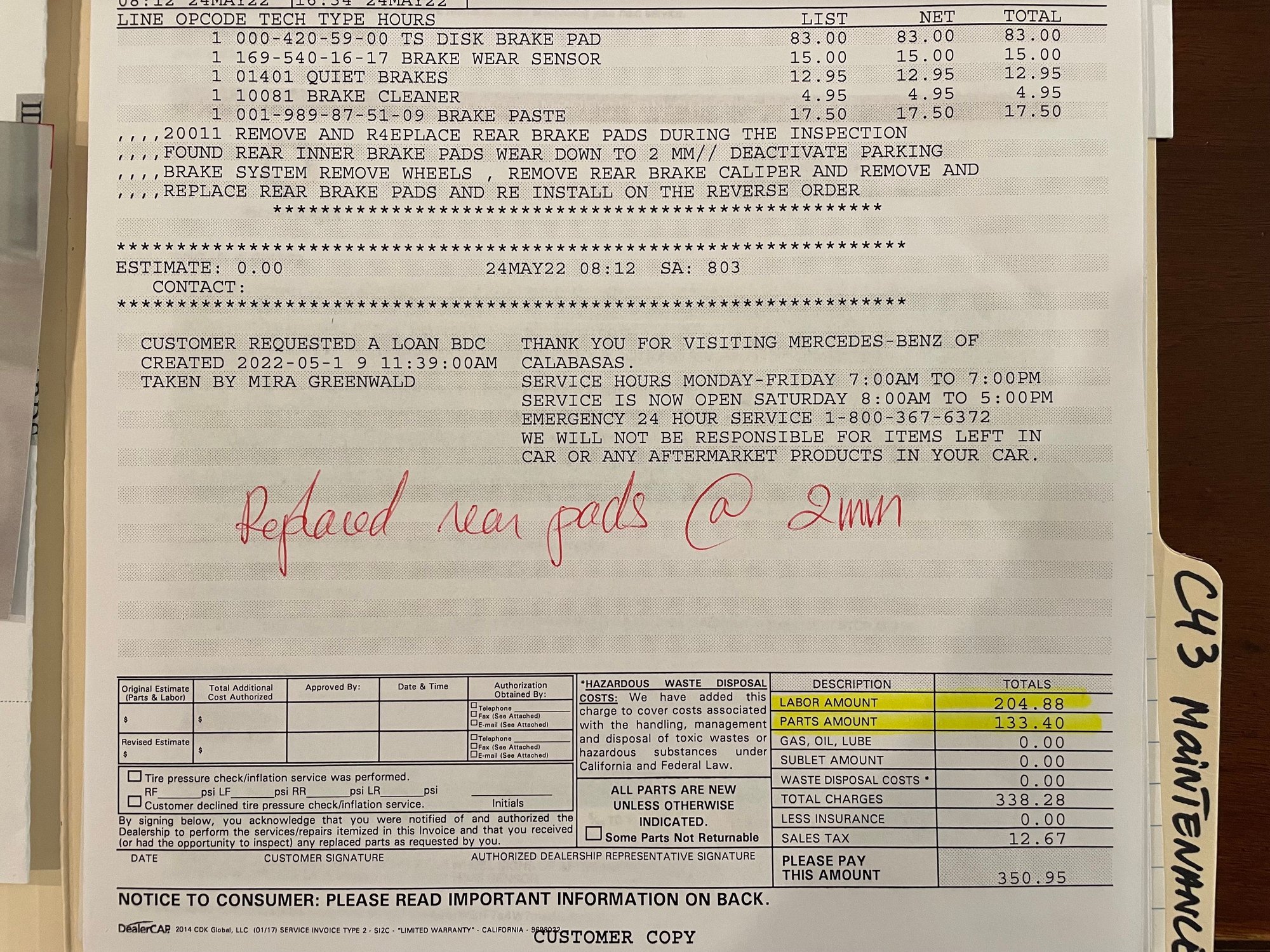

It's been awhile since this question was asked, but I would like to share the cost I paid for replacing rear brake pads at Mercedes Benz of Calabasas in California. While having my B service at the dealer, rear brake pads at 2mm were replaced. The cost was $350 which I think is fairly reasonable. I am a woman and I do not work on car or DIY and thanks to the informative discussions on this forum, I know that I was not being taken by the dealership!

That was 20,000 miles (Service B) on my car. They said the rear pads were 2mm and needed to be changed. Only pads, no rotors which sounds about right. I drive my car as a daily driver, and my commute does consists with lots of short trips with many stops and gos.
When I had my Audi S4 previously, the dealer said I needed to change both pads and rotors at 15,000 miles. I was dumb enough to listen and paid $700 for it. Later on, with a new boyfriend and checked with him, he said no just change it every other pads change. Dealers are notorious to scam, especially women.
