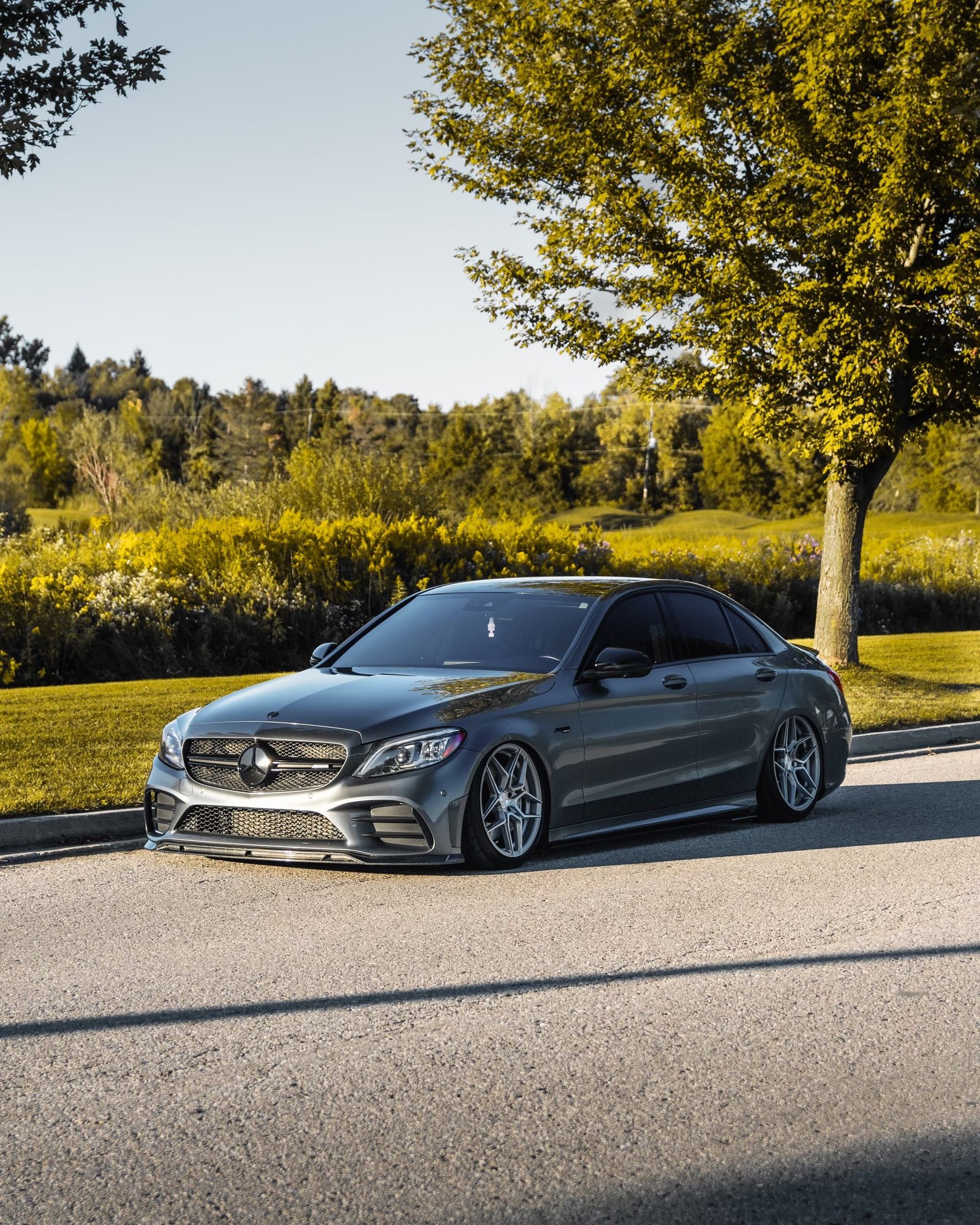

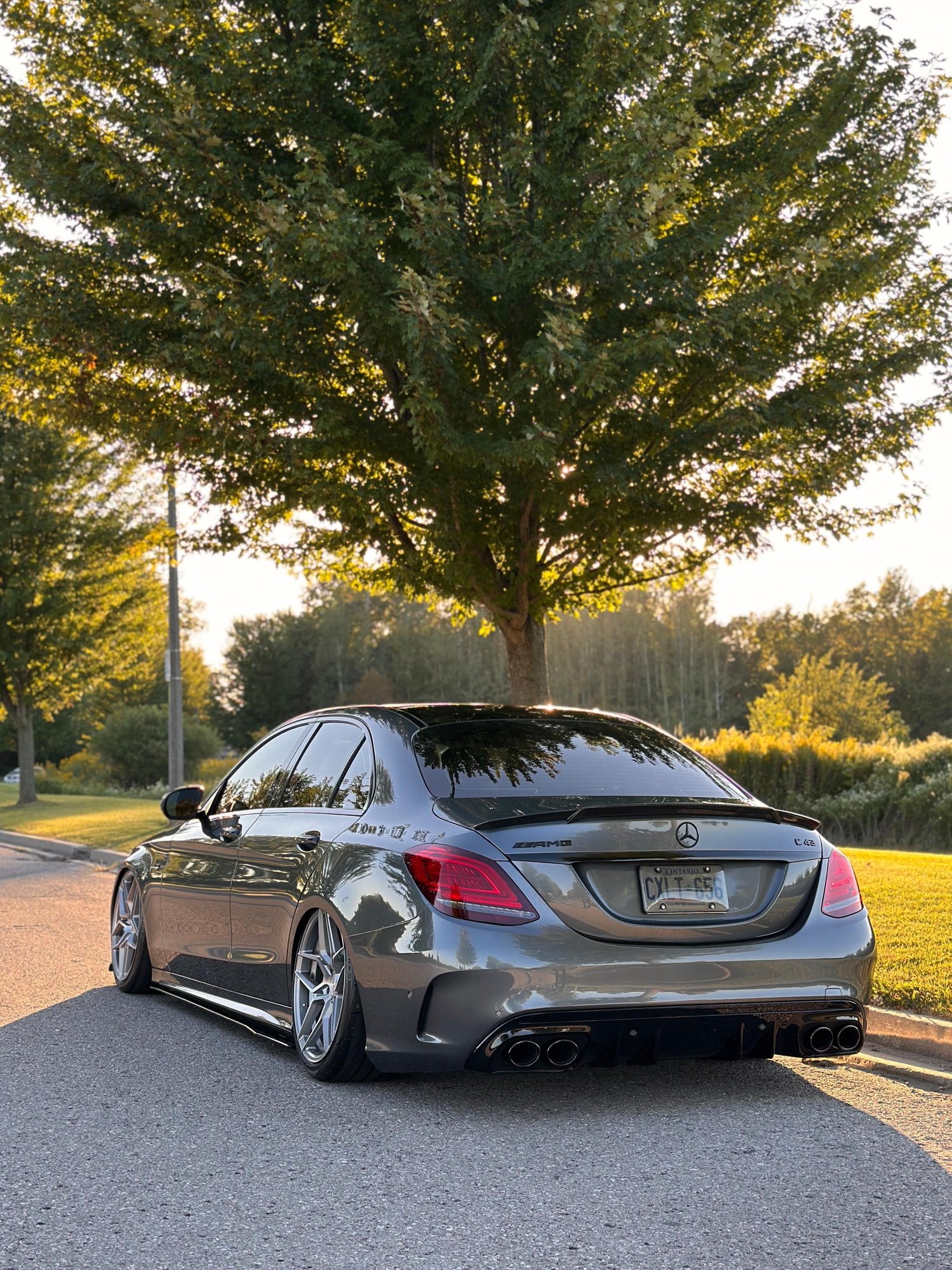

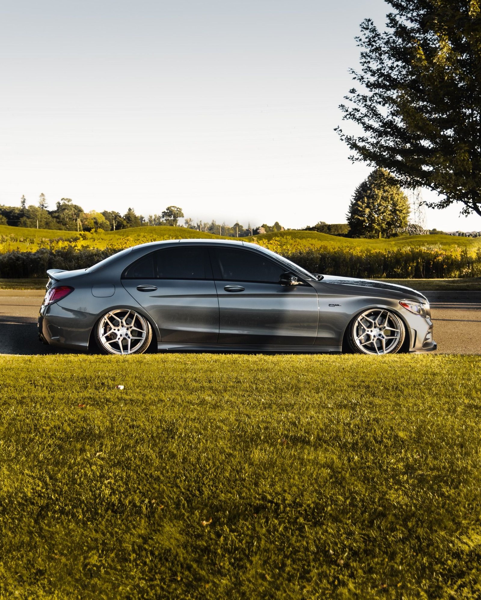

Nice, do you have pics of the setup? How is the new ride?

It feels like you're driving with sport+ suspension activated all the time. I had lowering springs previously and it feels just about the same if not a little more bouncy. I didn't really expect it to be a cloud or an S Class but hey if you want that low lifestyle you have to sacrifice the comfort.
