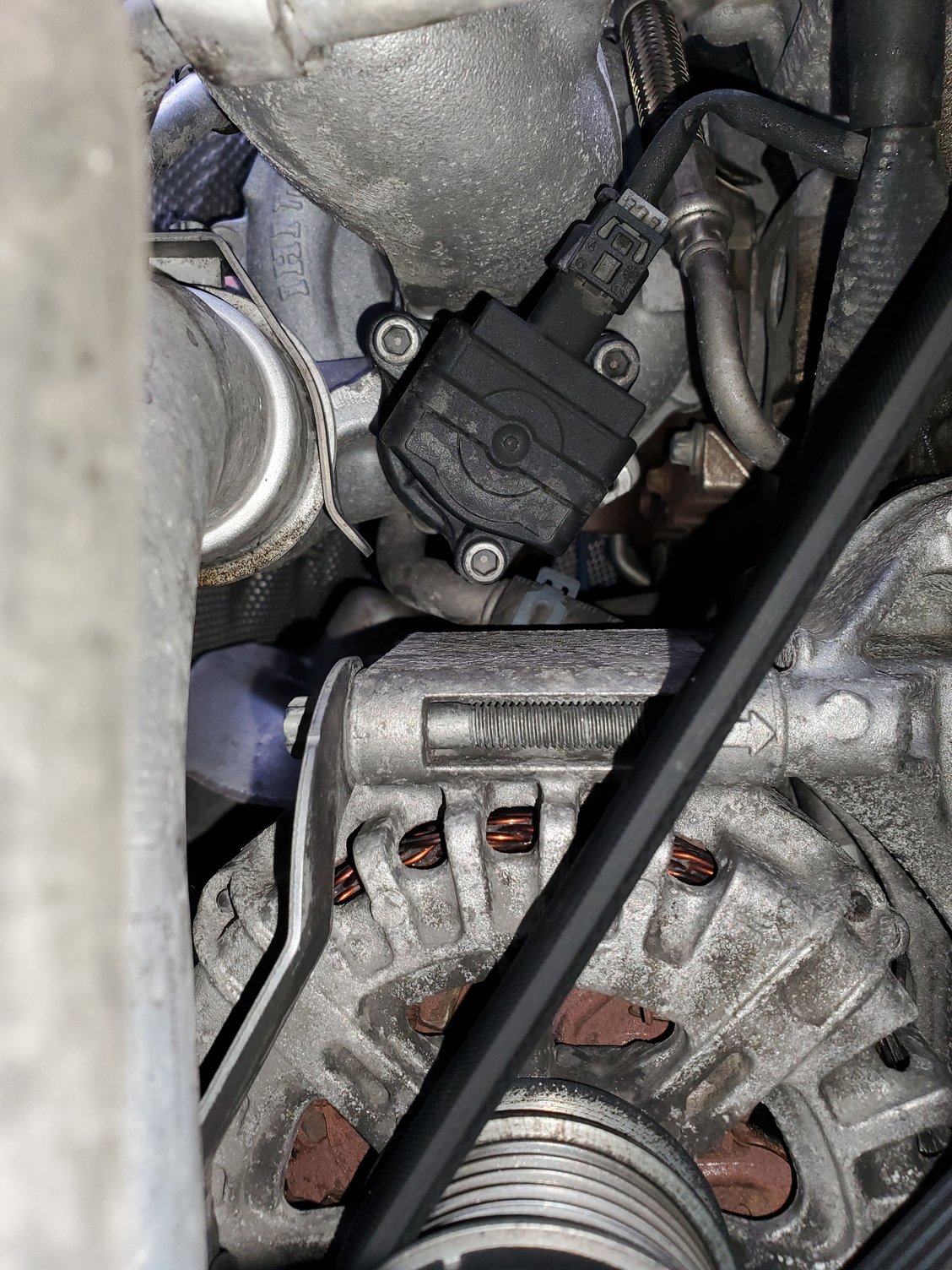

It is NOT an easy place to get to, but is possible. I removed the intake on that side, as well as the black plastic intake part that is attached to the aluminum rail for more hand room. Then prepare to curse and moan, and have some bandaids for your bruised and battered hands.
I used a 3in socket extension (too long is a problem, but too short doesn't work either) and used both hands to guide the tool to the bolts. The hardest one is the bottom one which you can't even see in this photo. Its there... just tight to get to above the alternator.

I found a shot of the stock bov too. It's easier to see.

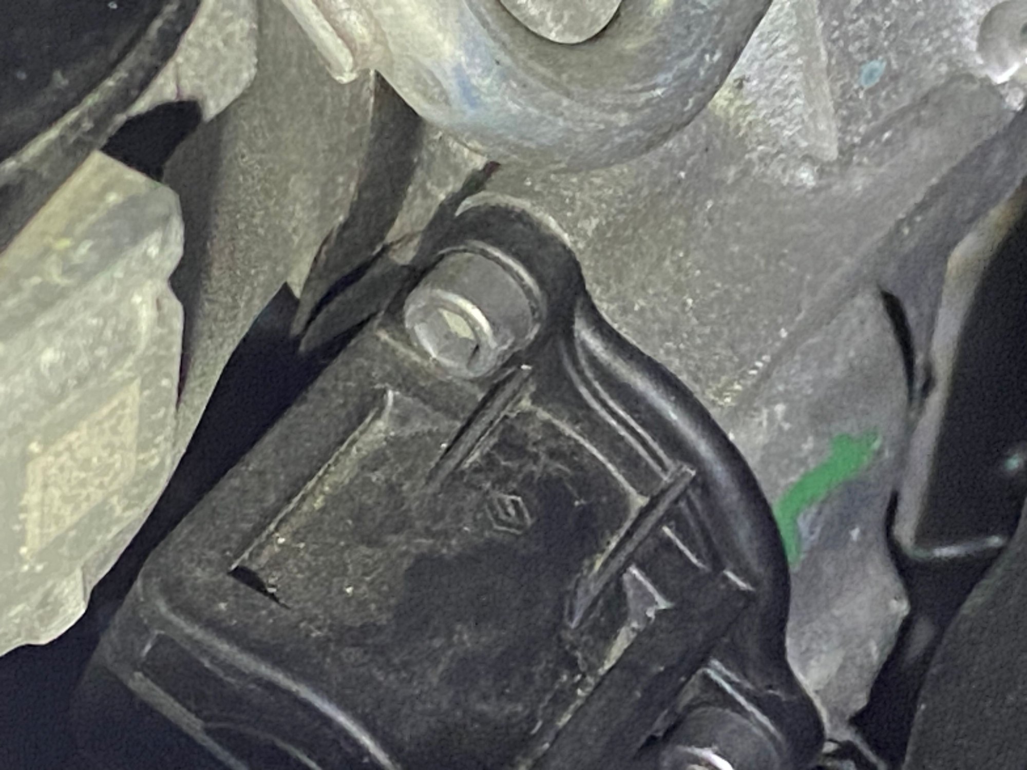

hey I’m trying it out as we speak, I can’t seem to find the right tool to take off the blow off valve. Is it a 3 in Socket to remove the intake or 3 in socket for blow off valve. It’s really hard to even see the other one . I give you props for doing it.

It's a 6mm Allen key. I use a 3" extension to reach

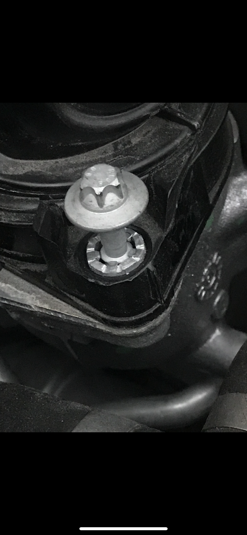

another question , how did you get past this main bolt when unscrewing the black plastic piece to access the blow off valve. It seems to be blocking it . I tried it on the other intake and it still did the same thing.
That's an E-torx head screw, either 8 or 10, I don't remember.
It's captured into the plastic piece, so you just lift up on the plastic tube once it stops unscrewing.

Yep, as mentioned above... Just yank, it will come off.
