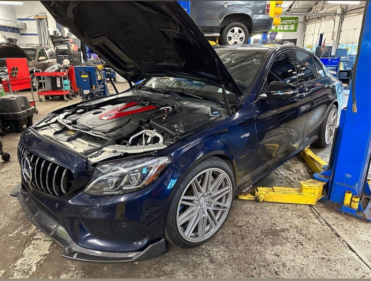

Right now I’m on stage 2+, down pipe, res delete, mst intake, weistec blow off diverter valve, H&R super sport springs, 15mm front 12mm back spacers, hybrid forged vossen rims, Perelli p zeros all around, and non performance exhaust. I’m looking for ways to make my car faster and louder. Was wondering if anyone knows where I can buy headers for the car and also the steps I need to take to run an e30-50 blend reliably. I want to be as loud as possible without sounding rice, tried to find an exhaust dump and I couldn’t really find anything also looked at valve tronic mufflers which sounded basically the same and armytrix which sounds like a vq. Any big turbo c43 owners please let me know what you have done because I eventually want to run a bigger turbo and I’m not to sure on the exact steps I need to take. I’m pushing about a little under 500hp I want to get it to 550hp before turbo and at least push around 620hp with turbo. All advice is appreciated thank you.

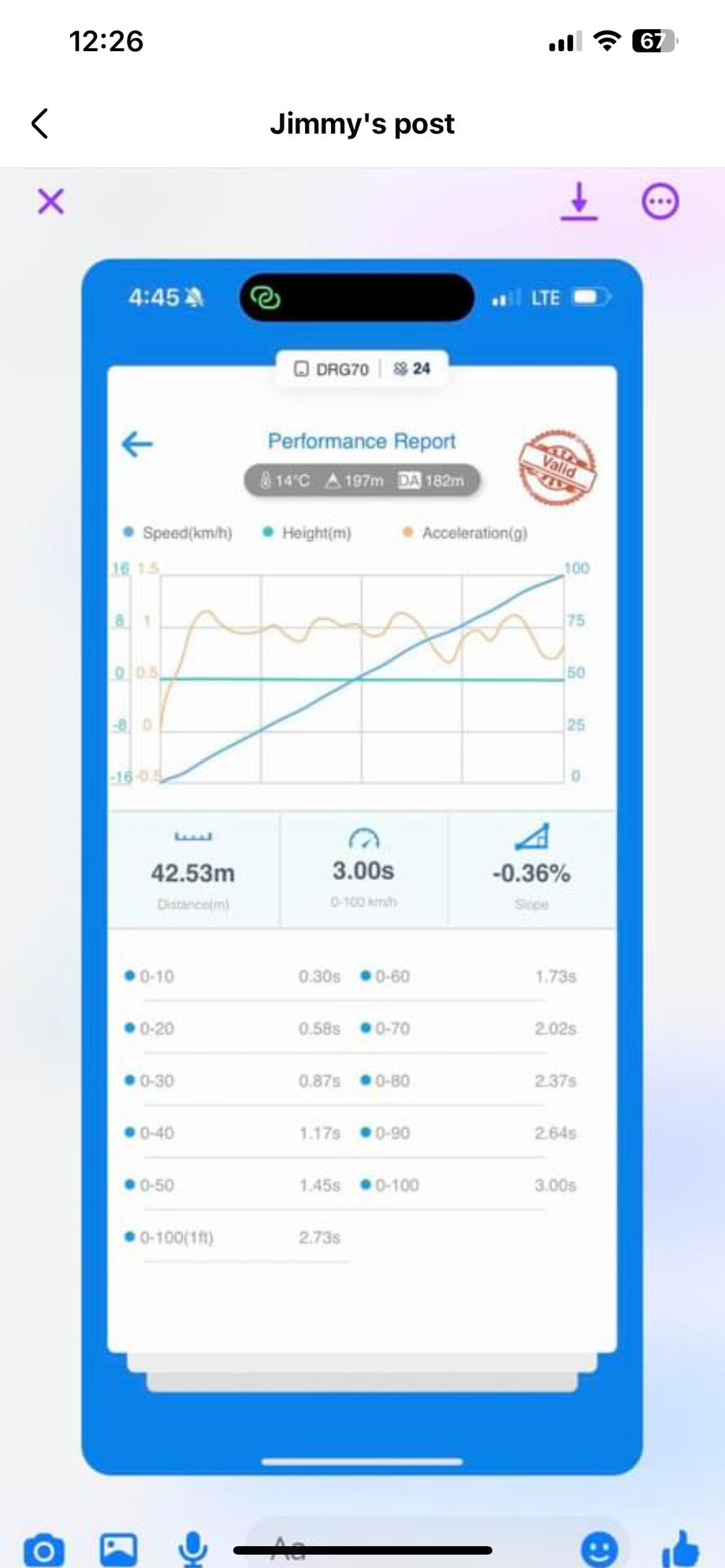

rods, pistons,by Carrillo LPFP&HPFP ModalWorks CAI and there hybrid turbos.spool intercooler. Downpipes PE Exhaust Dyno tune TCU tune running e50 612/582 whp best 1/4 so far 10.62 at 131 mph with. 1.76!sixty foot.
