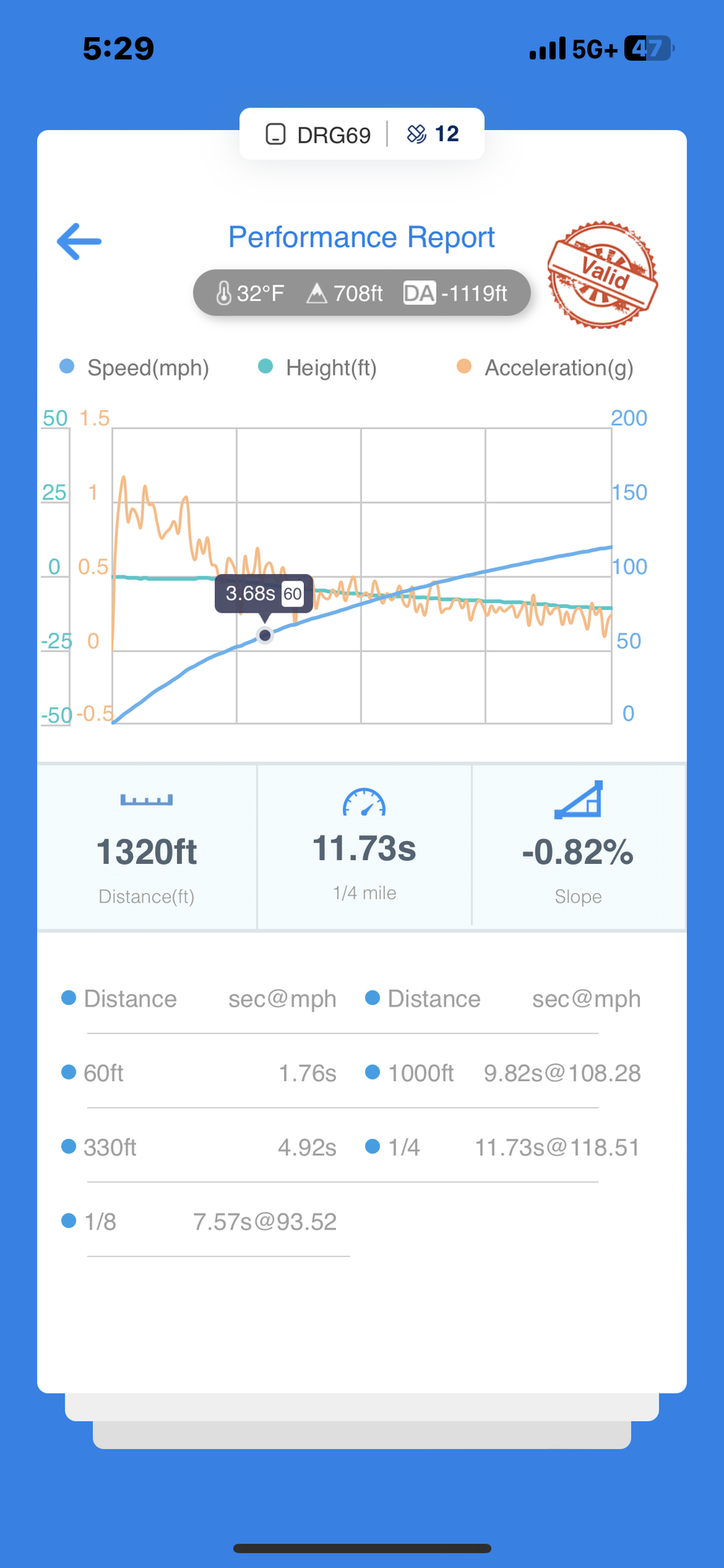

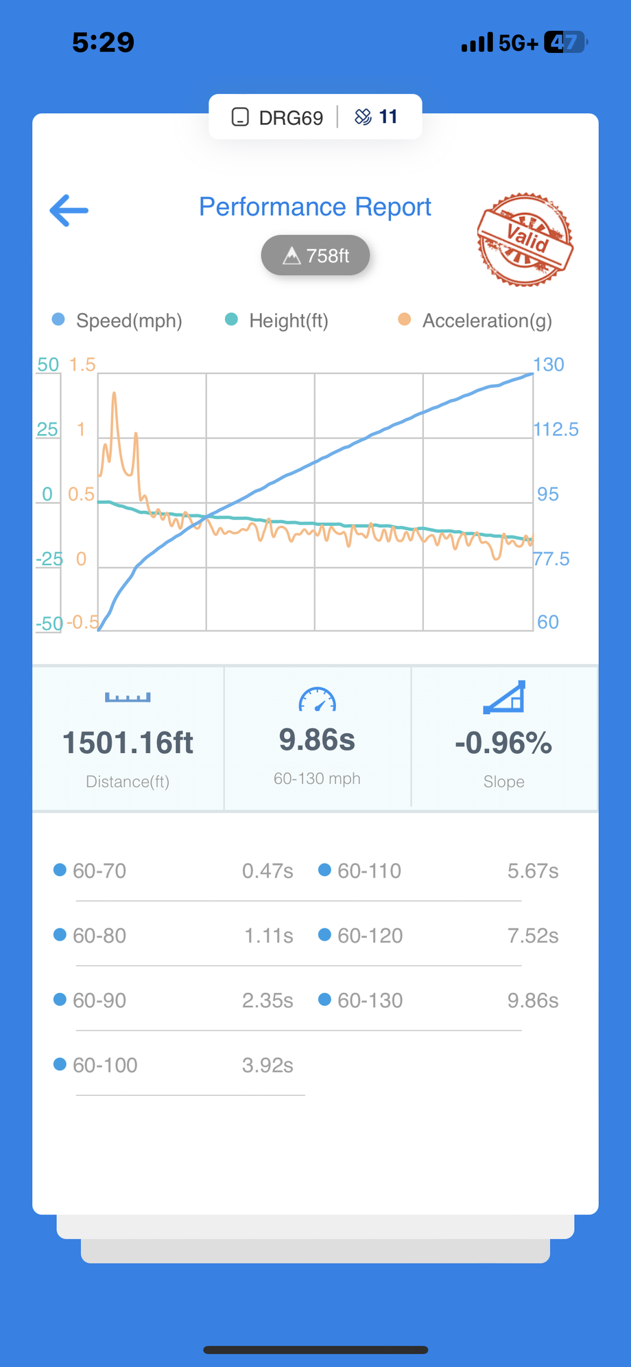

Off the top of head
0-60 stock vs jb4
4.01 to 3.58
1/4 mile
12.22 to 11.71
I got my 60-130 under 10 sec
I have the logos intake but no other mods or tuning

Just wondering, how did you launch when you did these runs? I recently took off a JB4 but never had a reliable way of testing differences aside from the good ol' butt dyno.

Brake boost (maybe 2 sec) just to build up boost on guage
Individual mode ( sport plus with trans on comfort basically) with trac all the way off for 0-60
Running mich ps4s tires
it took practice to get good launches
and I had launches that all FELT great but would end up being .2-.4 sec diff.
Unless u actually have a private track
there are so many outside variables that can effect times
I just kinda wanted to see how low I could my times, but mostly bc of the “caveman” in me I guess
im not winning prizes. lol

Based on this map to run those times, do you know ~ how many HP you have?

No idea where I’m at power wise. But I would think hp would be pretty consistent with every jb4
i think bms had some dyno numbers with a ‘20 c43 on their site or maybe on the tech 54 page
