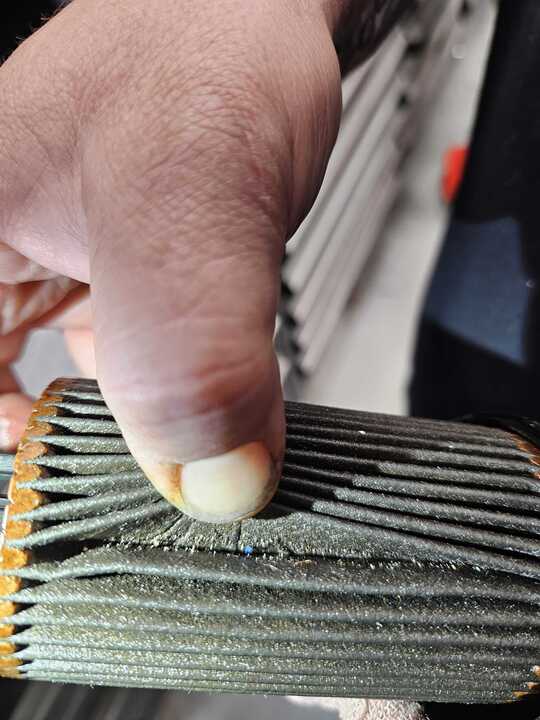

Oh, they've already done all of this then. I had them diagnose the engine noise and their findings were that the oil filter and oil filter housing had a bunch of bearing metal present in each. My service logs from non-MB dealer indicate that they used 5W-30 for my 50,000 maintenance, and 5W-40 for my 60,000 maintenance. They also used a BG115 oil additive for each interval. The manual states that AMG models should only use 5W-40, and no additives, as they can lead to engine damage. They used an aftermarket oil filter for each interval as well.
I haven't had them run any diagnostics on the ECU. Didn't know that was a thing so I can circle up with my service advisor tomorrow and see if he knows anything about that.

These are some of the images they provided me with during their inspection:

I think you got all you need to place blame on the non bnz dealer....hopefully the ecu has no stored codes to potentially let them off the hook.
It will not be easy to make them take responsibility and dish out money so be aggressive and dont give up.

Seems as if the old oil was drained, the filter replaced and the engine was fired up to check for leaks before the new oil had been poured in.

You're looking at the wrong oil qualities. Was the oil MB 229.5 certified? that's really all that matters, weight is irrelevant (your owner's manual can be superseded by newer tech documents at any time).
There's almost no way "oil type" or oil filter caused this unless you put actual track miles on the engine. You mentioned you put the car up for the winter, so unless you put 9K (hard) miles on the oil, put it up for the winter, and then immediately took it out of winter storage and flogged the ever-living snot out of it; this isn't an oil issue. Any MB 229.5 spec'd oil would've easily met all lubrication demands. I've personally put over a dozen 1/4 mile passes on Castrol Euro 5w30, driven it all winter, and then put 4 spring 1/4 mile passes on it before doing an oil change with zero issues.
Now, the oil additive COULD be an issue. It's obviously NOT MB 229.5 cert'd and doesn't belong in your car AT ALL.
Unlikely the filter had any play either unless it obviously failed (ie collapsed) which the MB dealership should have noticed.

I’m not sure what type of oil they used unfortunately. The service record only says viscosity. It sounds like the filter they used is from a reputable brand (Mann HU 7025 Z), so I’m sure that wasn’t a problem unless it was installed improperly. MB didn’t mention anything about that though when they inspected.
Just to clarify, I drove the car over the winter after 50k maintenance when the 5W-30 was used. The car never sat. I put maybe 150 miles on before garaging it from November to March after the 5W-40 was put in for the 60k maintenance. The car warmed up for about 25 minutes before I put it in drive in March. I have never once pushed the car hard before the transmission temp turns white on the AMG screen, which is always well after the oil temp warms up.
