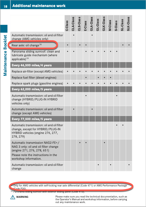

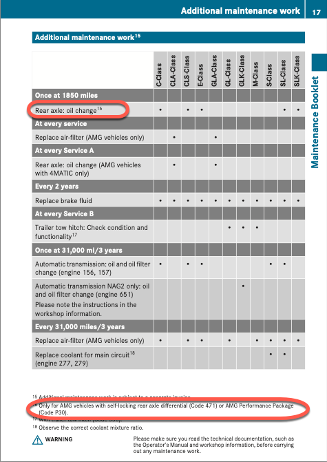

Old Oct 17, 2024 | 12:07 PM
JettaRed's Avatar
Veteran: Army
iTrader: (1)
Joined: Nov 2016
Posts: 7,847
Likes: 3,495
From: Maryland
Even though the attachment says 2015 SL Maintenance Manual, that is only what I renamed the file. This is a general maintenance booklet.
