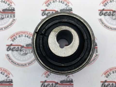

The NORMAL lower control arm bushings are already built with the accentric camber adjustment feature!! Now, the dealership says they never R&R the same bushing. They always press in new bushings. I searched my parts resources and found OEM (not sure the actual mfg yet) bushings on sale for 50% off (!!!!) so I bought a pair. Here's a random internet pic showing accentric design. Part number A2053333800.
I found a few YouTube videos on LCA replacement. I think they were all on C300 model, but I can't imagine my C43 being drastically different. I just need torque specs for each attachment. I'm going to make sure I have all the tools and do this in August. Next track day is in September. Woot woot! Can't wait to see how much tire wear improvement 0.5 degrees negative camber gets me on the track.

I've determined by the part number, and associated part diagrams, that the adjustable bushing goes on what I'm calling the Spring Arm. (The strut & spring assembly also attaches to this arm. Part 200 in the pic.)

Everything moves a lot more than I imagined. So, it seems sensible that one arm can be pushed out from the frame more with a bushing, and the tie rod adjusted for toe. Anyone have torque info?

This thread answers my questions. I'm going forward with using stock accentric bushings to get a touch more negative camber.
