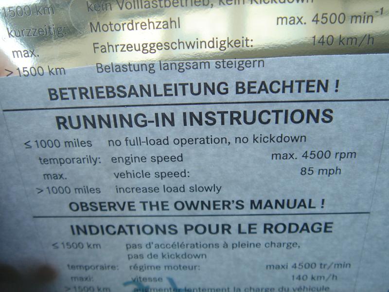

To follow or not to follow. That is the Question
I hate to bring this up again but.... after looking at this- what should we owners be doing?? Going mad over here lol
I have been very careful with running in but after reading this and that about the "drive it like you stole it" concept.... But then you see the manufacturer's instructions and think twice.
Opinions and advice welcome

honestly, i think that after about 500 miles it good to go, don't track it until about 1500-2000 but after 500 feel free to dare the cops.

If you drive it like you stole it your automatic gearbox will learn that "drive it like you stole it" mode. At least that's what I observed in the M5. So drive according to your taste I guess?

wut does it mean by "no kickdown"??

This topic has been beat to death.Do a search.If you want to beat the snot out of your $60,000+ AMG&not let all the intricate parts inside the engine bed in properly then have at it.It's your money.If you leased it then I'm sure you really don't give a crap.
What happened the first time you stuck your private parts in a girl who was "never broken-in"...did you just hammer the crap outta her from the get go?Worked out real good that way huh...
Beat on it from day one,I'm sure the piston rings will thankyou for it in a few years
Bottom line is it's your car,do what you want whether it's ignoring the manufacturers recommendation or not

I've done both and I can say from my personal experience that breaking it in properly is important. A few years ago I decided not to listen and overall the car simply didn't run as good as it should and it ended up needing a fair amount of engine work after only a few months. It could have been the way that car was anyway but it makes me wonder.
Of course after that you might end up getting lectures by the police because although your car has "6.3 liters or whatever the road is not the place for it". Last weekend I received a lecture not because I was speeding but because I accelerated very quickly and the roar from my engine is hard to miss.

I think it's when you press the gas pedal all the way down and the car shifts.

Not to flog a dead horse, but when I was at the dealership yesterday, all the mechanics were on break, and I decided to ask some of them what there thoughts we're on the subject. Suprisingly there were some mixed opinions. I expected them to give the standard Mercedes answer and cover their asses but they didn't. What I got from the conversation, especially later on when I went one on one with one of the guys who was getting off shift, he said, Quote; "they've had more cars in with problems that have been babied, as opposed to cars driven hard". That being said he still felt that trying to stick to the outlined break in schedule was best, but then drive the snot out of it!!! After that. This would be the best way to do it, and since it's only the 1st 1000 miles, it woudn't soften the car, especially if your going to beat it hard after that. Just my 2 cents worth. Each to their own I guess.

the key to breaking in a motor, whether it be a car motor, a bike motor, a boat motor, or any 4-stroke internal combustion motor for that matter, is seating of parts.
the absolute worst thing you can do for a new motor is to hold it at steady rpm and load. at that point, nothing is going on inside the motor that will help break-in. the rings are not being pushed against the cylinder walls, the bearings are not being compressed by the crank journals, and the valve seats and guides are not being worn in.
i would strongly suggest not beating up your brand new amg, and by beating up i mean high-rpm, high-load driving (driving it like you stole it...), but i would suggest constantly varying the engine rpm and load (to about 75% or so), and going through the gears. whatever you do, please do not go on the highway and cruise at 70mph thinking you are breaking in the motor.

I'm a believer in taking it somewhat easy the first thousand miles but i must say my current C55 that i let "break in" is now burning about a quart of oil every 1-2 weeks. Thanks god shes not mine, i have less then a month with her but it makes me wonder what im going to do with her sister...

the easier you are at the beginning will cause big problems later on.
if the rings don't seat properly (caused by too little oil pressure at the beginning of the engine's life), the oil will pass by the rings and enter the combustion chamber, causing you to continuously have to add oil.
this is one of the problems with breaking it in by the book.

He's got the point correct. For engine break in, you may not stay in similar rpm range, as piston rings need to groove into the cylnder walls. If not, i've seen 1000 mile on the clock motor burning oil. When I build race car motors, usually their other parts are broken in i.e. trans, diff, brakes, etc. For engine, you just gotta floor it to give the rings some pressure to set them into the grooves. However, stressing the motor would not be good, so use variety range of rpm as you drive. all in all, if engine wasn't built properly, it would be no good on day 1, floored or not.

hard breakin, but change oil very very often during that breakin period imo
