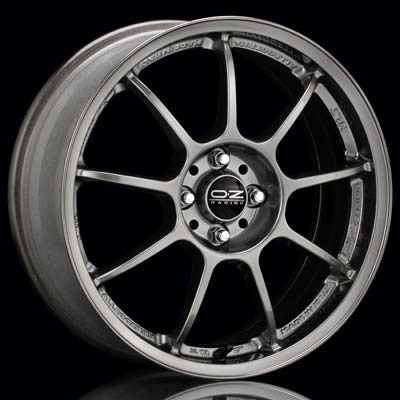

Old Nov 30, 2008 | 05:13 PM
FishtailnZ's Avatar
Joined: Feb 2004
Posts: 497
From: Canada
Looking for a new toy.
Originally Posted by CDNROCKIES
The offset is 18 x 8 for mine. I thought the offset was the same (that's what it lists on tirerack for the C63?, but the OZ don't appear available.) Maybe give them a call, they were great to deal with.
"18 x 8" is the wheel size in diameter x width...not offset . Offset is the distance from the hub mounting surface to wheel centerline and is critical in getting right to prevent interference with either the fender lip on the outside or wheel well/suspension/brake bits on the inside.
P.S. there's a handy offset fitment calculator at the following link:
http://www.1010tires.com/WheelOffsetCalculator.asp
Originally Posted by otoupalik
I very well have an Enkei Racing application for you guys if you want light. Remember, these are from the same Company that MBZ F1 uses!
Let me know and I can check on Monday.
thanks
brad
I would also be interested in any info you have on lightweight 18" wheels Brad...TIA!

Old Dec 1, 2008 | 08:14 PM
otoupalik's Avatar
MBWorld Founder
Joined: Nov 2001
Posts: 2,599
From: Scottsdale (aka The Surface of the Sun)
Some options:
BBS RX - 18x8, et32, 24lbs - $370/each
Enkei Racing RPM2 - 18x8, et35, 19.4lbs - $275/each (silver or hyper black)
Enkei Racing RP03 - 18x8, et35, 20.2lbs - $350/each
Enkei Racing RPF1 - 18x8, et35, 17.8lbs - $325/each
Enkei Racing NT03+M (the McLaren F1 wheel) - 18x8, et35, 19.4lbs - $335/each
OZ Alleggerita HLT - 18x8 - $375/each
OZ Superturismo GT - 18x8, et35 or et50, 24lbs - $334/each (black or silver)
OZ Ultraleggera - 18x8, et35 or et45, 18.6-19lbs - $348/each (black or silver)
My preference and recommendation would be enkei. Best value, strong, could be winter wheels now and track wheels in the summer!
I have the RPF1 on my MRoadster, and we use the NT03+M on all of our race cars.
We obviously sell these. We are direct with BBS and Enkei.
thanks
brad
Old Dec 1, 2008 | 08:34 PM
FishtailnZ's Avatar
Joined: Feb 2004
Posts: 497
From: Canada
Brad, I already have a set of 18 x 8 et35 Ultraleggera's that I used with my previous SLK55. So you say these will also work with the C63?! Seems like a big disparity in offset from stock C63 specs, especially the rear? Unfortunately I don't yet have the new C63 to test fit them on...but if you say they will work, I'll have to take them off the for sale list *L*.
Old Dec 1, 2008 | 08:58 PM
otoupalik's Avatar
MBWorld Founder
Joined: Nov 2001
Posts: 2,599
Well, lets look at this in more depth.
Lets look at the front:
  • Assuming the front is 18x8 with et45 (taking this from the second post).
  • The stock wheels can easily take a 10mm spacer, giving an essential offset of et35
  • Thus, an et35 wheel should give you the proper look without needing to add a spacer to the stock wheels
Lets look at the rear:
  • Assuming the front is 18x9 with et54 (taking this from the second post).
  • 1" is approx 25mm, and you are using a 1" narrower wheel, thus you are taking 12.5mm off each side of the wheel.
  • Thus a 18x9 et54 and an 18x8 et66 will have the same outer profile.
  • To give you the correct look, I would use a 30mm spacer kit
  • The 30mm H&R spacer kit is very safe to use (all H&R spacers are TUV approved and hub-centric). The 30mm kit bolts to the hub, then the wheel bolts to the spacer. Thus you are not using 30mm longer bolts.
So net/net, I would go this route with my car, especially if I already had the OZ's. If I was buying new, the Enkei RP01 is light and affordable, and would be my choice.
