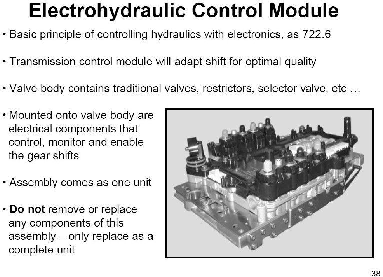

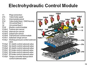

Some facts
The ECU and TCU can be seperately programmed through the data port under the dash. TCU takes about 10-15minutes and the ECU takes about 20-25minutes. Whether the communication routes through the ECU, is a moot point. It may do that or the TCU may simply be a different address on the bus.
The TCU is located in the valve body. Here is a picture from the 7spd training.
Edit. I will also say that just the TCU tune can make a big difference in the butt dyno.
Attached Thumbnails What does Andy @ MPH really know or do?-transcontrol.jpg   What does Andy @ MPH really know or do?-transcontrol2.jpg
Last edited by Jon2007E63P30; Feb 10, 2009 at 05:01 PM. Reason: Added second picture and typos

Jon - what did the AMG guys at Laguna Seca for the SL BS launch have to say about flashing the TCU via the ECU ?
Cool diagrams, btw...thx.

Thank Jon!
I guess this address the statement of just opening up a 7g and ONLY seeing solonoids.
