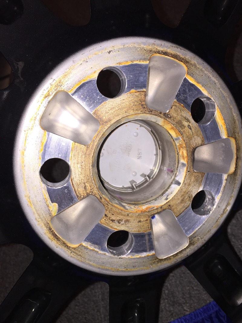

Originally Posted by clichere1
Thank you Roswell
I'm surprised that he have no issue in the front too. He's not lowered.
As you said, it rubbed in bumps and it's worst when two people setting in the back seat.
We'll go first with the 255 wheel.
can you post a picture where to trim the wheel, just in case we need to go for option 2, please?
Thanx
I don't recommend u that option unless ur wheel hub is thick enough to shave few mm. It might affect the integrity of the wheels if u shave too much.
Here is a pic of the are u can shave:
