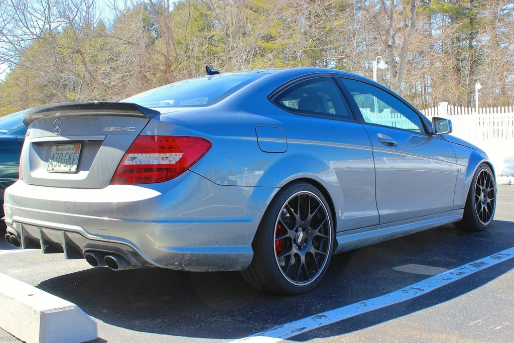

Posted this in the official picture thread but figured I would throw it in here too and see if it got any more love.

As I'm selling my 507 coupe to a friend shortly, I will pick up a W204 sedan (until the W205 coupe comes out of course) and this is the look I'll be going for. Simply stunning.

I appreciate that man

Love those wheels on the 507 man!

Your car is so clean. What size tires are you running?

Thanks man, love hearing that.
Im running a 19x9.5 (could be 9 ) up front and 19x10.5 in back. I believe that its 245/30/19 in front and I know its 275/30/19 in back. Not positive about the front width but I'll check when I'm home on Friday. I went through wheels boutique and they knew exactly what would fit and shipped them to me perfect and ready to bolt on.
