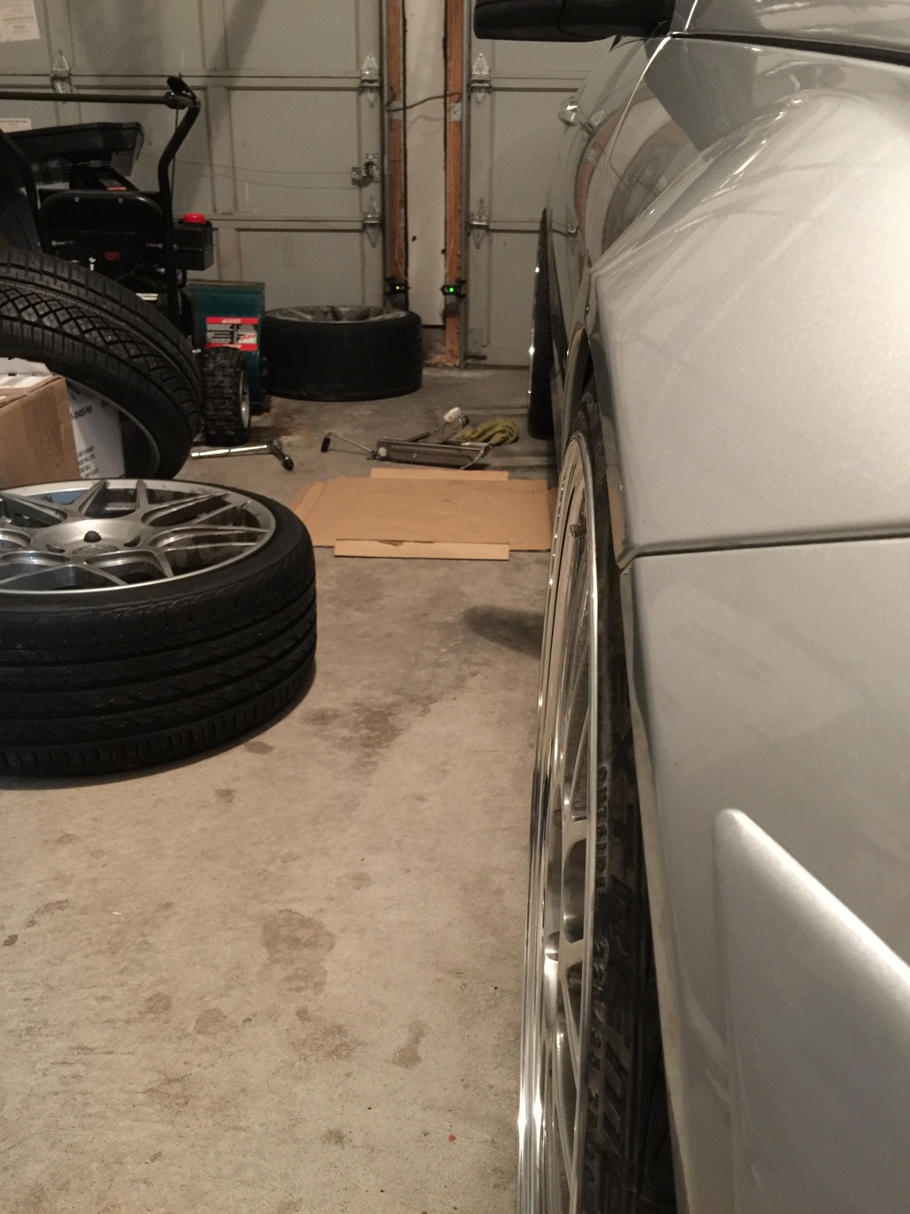

In the next 2 weeks the car will be done, I was up last night doing some measuring etc my beast's about to get some wide hips.
Wanted to ensure the stance was perfect before sending her off to get some fender work done.
PS: It was always hard for me to photograph really how much concavity those HRE's have out back. This picture gives you a good idea. They are sitting on the floor

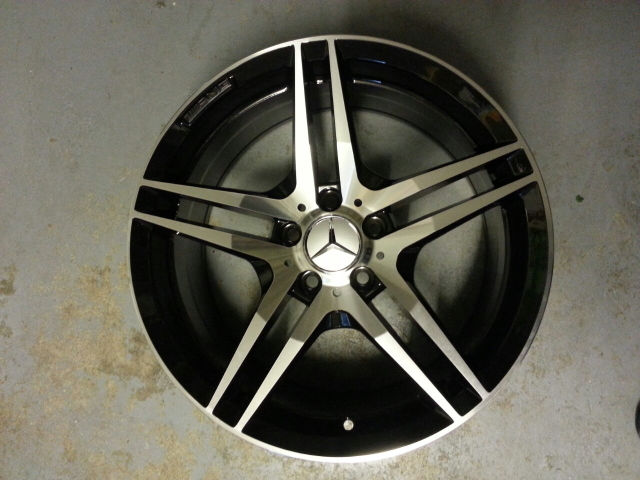

Replica Rims Question
Hi I am in Europe and a guy is selling some replica AMG rims (picture attached), but before I buy them I wanted to ask the forum if in the US do your rims come with an general operating licence for aftermarket rims or in general for rims?
He told me normally no as the information is engraved in the rims but in Europe things are a bit more difficult as everything needs be documented. Does anyone know how to get an operating license if such exist?
Info I have:
18x8j et45
Bolt circle 5x112
JWL and VIA stamps
Load per rim
Info I have:
18x8j et45
Bolt circle 5x112
JWL and VIA stamps
Load per rim
In America we can buy pretty much any wheels available on the market, replicas included. No licensed needed when you purchase used wheels.
I would go 19's though, 18x8 is weak.
