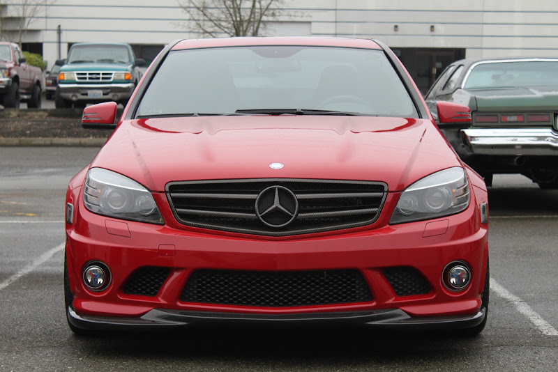

PS. What kind of CF lip is on the red C63? TIA

ditto on what lip is that.
and DAMN red looks good... kinda thinking I should have bought red instead of white

And the lip is from JBSPEED. See here: https://mbworld.org/forums/c63-amg-w...-diffuser.html

Great numbers and pics! That red C63 with CF looks
