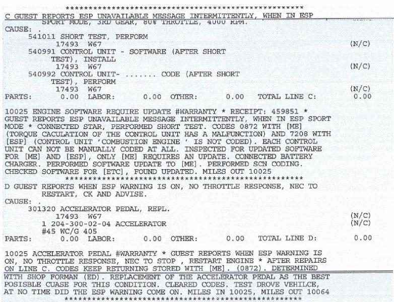

Interesting diagnosis by the dealership..... Can you please post the service record once it is fixed?
Here you go... it looks like its written in some foreign language. Looks like they fixed by the "best guess" scenario. I'm still pissed to say the least. I can't trigger the event now. I guess its a good thing for them because if I do then this car will become a lemon.

So does anyone know what these codes are?

DTC P 0872 - Transmission Fluid Pressure Sensor/Switch C Circuit Low
The Sensor/Switch is showing low pressure in circuit C but I am not sure why or what the cause/repair is.
Cannot find any info on 7208.

Just in case someone missed it the 1st time. In my example...
IT WAS NOT AN ECU ISSUE IT WAS A FAULTY ACCELERATOR PEDAL.
However in the process of troubleshooting your car the dealer will usually flash it with the latest software that they have. Which also means you will need to re-flash your car once its fixed. Which should be covered under warranty.
