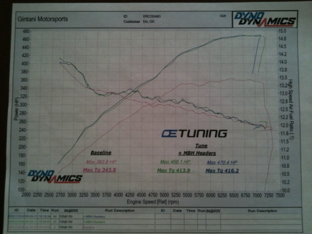

So the results are in from my recent MBH header install. Much thanks to James at ACGSD for the great install and professional customer service.
I have to say I couldn't be more pleased with my choice of mods. The MBH headers are truly a work of art, and one cannot truly appreciate this until they see them in person. With the resonated catless midpipes, the sound is perfect. Very mellow and subdued during cruising and partial throttle, but MADNESS at WOT. Also, the ACGSD Stage 2 tune that James flashed me with (written specifically for this header setup) feels great. And that's coming from a guy who's had several different vendor tunes.
Attached are my before & after dyno results, the first graph showing the power curves, the next showing AFR.
"Baseline" = bone stock (charcoals and stock paper filters intact)
363whp/343wtq
"Tune + MBH Headers" = charcoals removed, AFE Pro Dry filters, MBH headers, MBH resonated catless midpipes, ACGSD Stage 2 tune, 91 octane Chevron fuel
470whp/416wtq
Needless to say I couldn't be more pleased with these power results, especially given the safety of the almost stocklike AFR curve. Now I just need to get to the track to back up these dyno figures.
For anyone considering going the header route, I highly recommend this combo.

gaining 107whp over stock makes me laugh. Its crazy how much power the C63 picks up. BTW, James at ACG is an awesome guy. They go great work.

Originally Posted by bushburninc63
So did he dyno tune it, or he just loaded a map he had on hand for that setup you have?
No custom dyno tuning, just a map load that had already been developed for this specific setup.

Originally Posted by badu
I'm a little confused. You said you have several tunes before you put in the ACGSD stage 2 tune. Does the "baseline" dyno contains any tunes or did you flash back to stock first? Congratz on the crazy HP number!
Baseline dyno does not reflect any tune and is simply stock flash.

Yep, him and I were talking about that. We already did a graph overlay of his results vs mine and although we make almost identical peak power, he's got me by a bit in the midrange. I still expect him to pull on me, but should be a lot closer than before.

Congrats...with a tune your were around 400 so the headers gave you around 70whp! Thats insane!
