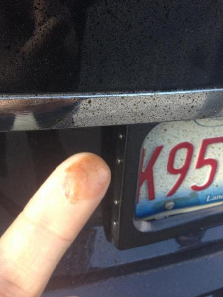

Coolant is all normal, it is an oil issue.. the catch can is not filled but the back of my car is covered with oil that got sprayed from tailpipes. The ECU was scanned for fault codes and there are current and stored codes for cylinder 5 and 8. A compression test and a leak down test are being done next. Both Steve and Speedriven have been on top of the issues

Here is a pic of the trunk

Quote: Sounds exactley like what my brother had with his SL63. Either your Tune is Rich or the SC isnt installed properly and is causing a vaccum leak through the manifold. dont worry, Steve will fix it for you
Wouldn't a rich tune be a darker coolored smoke? I run the CLK a little on the rich side to be safe and at times I get a quick puff of a dark smoke. OP said white smoke which would tend to tell me it's water/coolant or oil. The nose test should tell him if it is fuel, coolant or oil. Maybe the sniff test has gone by the wayside LOL, back in the day of 2-stroke motorcycles I relied on the nose test to tell me if I was running a lean or rich mixture lol
Reply 0
Apr 22, 2013 | 02:53 PM
  #129
Quote: Wouldn't a rich tune be a darker coolored smoke? I run the CLK a little on the rich side to be safe and at times I get a quick puff of a dark smoke. OP said white smoke which would tend to tell me it's water/coolant or oil. The nose test should tell him if it is fuel, coolant or oil. Maybe the sniff test has gone by the wayside LOL, back in the day of 2-stroke motorcycles I relied on the nose test to tell me if I was running a lean or rich mixture lol
Yes, I believe you are correct. Smoke wouldnt be white. It would be a little dark just like we had with our SL when it was running rich.

Quote: I wonder how many miles were his motor? I have not heard of anyone else having these problems. I wonder if this had anything to do with human error during install? I hope it is just some silly little mistake with no serious damage.
I have 21K miles on my car, I am praying its a silly little mistake too! But does that picture look like it could be something little, I am just asking because I don't know if something little would make oil come out of the exhaust like that?

Sythetics will burn white or blueish white. After seeing the photo of the oil drops on the bumper it is pretty safe to assume he was burning oil. I am still convinced this is a blowby or crank case breather related issue. I have had white smoke and exhaust oil blow by on the CLK a year or so back when my crank case breather and catch can got reinstalled inproperly by one of my diesel mechanics that usually works on my semi's. I crapped myself then was releived to find it was just a simply silly mistake that cuased no damage other than costing me a roll of paper towels to clean out my airboxes.
A simple leak down test would tell him if it is rings, have they done a leak down? It is a fifteen minute task and should have been one of the first things they checked.
