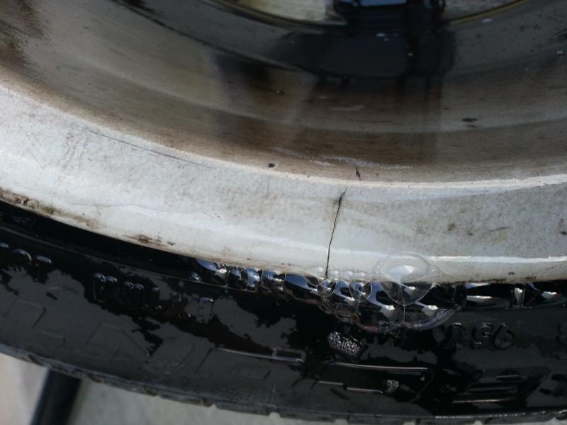

All,
I took the tires off today and it turns out there's a fracture on the back side of the rim.
I'm so pissed.
Anyone know where to get cheap rims? I only need 1.
Thanks.

I guess its so bad that a weld is no good? Try eBay .

If you do not plan on tracking, and depending on where the crack is, it can safely be fixed. You are in VA, guessing around the DC Metro area. I will have to remember where I took mine to. I had a crack as well, cost me around $100. the crack was on the inside lip, they cut the area out, and welded new metal in place (you cannot just weld a crack). The shop was located near Annapolis, although I am sure there is probably a location closer to you (was not a chain, but there are a number of similar shops around)

Originally Posted by _timothy
Sorry to hear that
It's not bad. Just a fracture that must go in deep for air to come out.
Picture attached.

That is exactly the same as the damage to my rim, same length as well by the looks of it.
Here is mine.
Here is mine.
Damn...identical.
