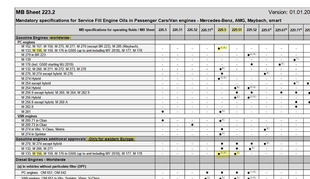

Originally Posted by Ingenieur
according to MB any 229.5, .51 0r .52 is OK as long as it is 0W40 or 5W40
this is directly from MB
I posted the chart
That's right - see my post #44 above (https://mbworld.org/forums/5802431-post44.html). Confusion I may haz had it.
I posted the chart
It's interesting how we make this so complicated. 229.51 is the latest spec and is the MB recommended spec for the M156 engine. But the previous 229.5 is also still valid for our engines.
Regards,
Joe
Hi Joe,
This is what I was trying to explain in my previous post. Unlike software revisions for example, 229.51 is not a later spec of 229.5. 229.51 supersedes 229.31 (oils that were originally approved for diesel engines), whereas 229.5 supersedes 229.3 (oils that were originally approved for gasoline engines).
In the past, 229.5 and 229.51 oils were mutually exclusive - the first was for gasoline and the second for diesel engines only. Recently, MB approved the 229.51 spec for use in their gasoline engines as well, but the 229.5 spec is still better for gasoline engines due to the higher ash content and HTHS values. Mobil 1 0W40 is a 229.5 spec oil whereas Mobil 1 Formula M 5W40 is a 229.51 spec oil.
There is an old thread on this board that discusses this in more detail at https://mbworld.org/forums/c-class-w...il-change.html.
I am not familiar with 229.52 so I can't comment on it, but it's also a low ash formulation so likely better suited to diesels than to gasoline engines. AFAIK the only Mobil 1 oil that meets the 229.5 spec (the "better" one for gasoline engines) and approved for the M156 engine is the 0W40.

There is actually nothing confusing when you read the PDF.......229.5 is MB approved WORLDWIDE where for Western EUROPE it is MB approved for both 229.5 AND 229.51................So yes it will be fine in any M156 engine to use both 229.5 and 229.51 (if it is ok for western countries it is ok everywhere from an engine build point of you.....it is just different emission laws between western Europe and other countries in the world)...PEOPLE need to read and stop being lazy waiting for others do the work for them...
