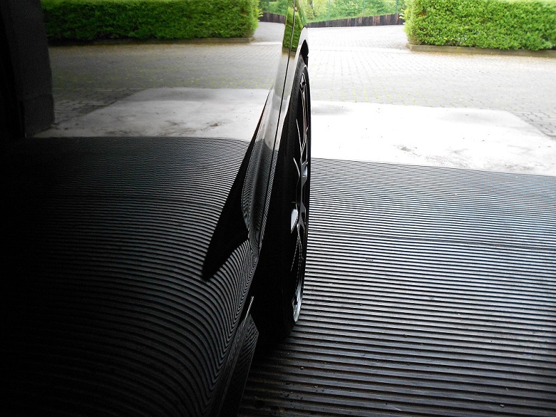

I would go with 8,5x19 ET38 in the front and 9x19 ET42 in the rear. These sizes are availabe for the OZ Ultraleggeras HLT. It is a lighter version than the standard Ultraleggeras.
In the front there is no problem even with a drop. But in rear it depends which tire you are driving and how much the drop is. I was running the HLTs with 235 and 255 tires (Continental SportsContact 5P) and a drop of 30mm. With this kombination there was a need to roll the fenders in the rear because of the wide tire protection lip.
