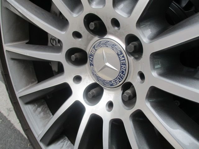

CLS550
M14x1.5 Wheel Studs Installed
Pics showing the wheel conversion studs installed in our shop car CLS550 under OE 19' wheels with RB 390mm BBK.
Both DIYers and shops shall truly appreciate the convenience and trouble saver of this conversion.
