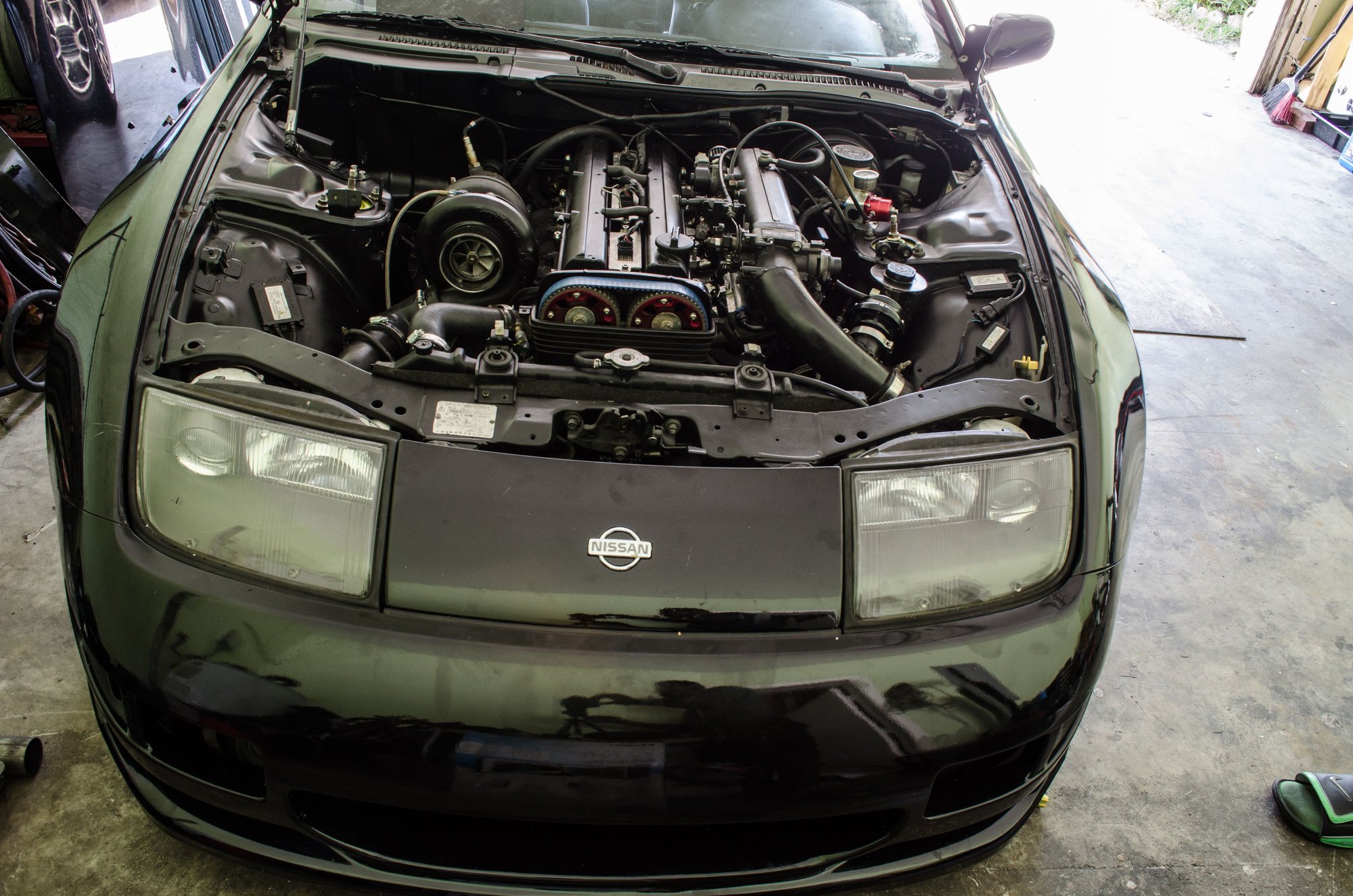

Its not being relentless isn't correcting bad and incorrect info. alot of this is hard to explain to people that drop cars off to be worked on(nothing wrong with this) as aspose to people who do the work them selves for fun.
I've been doing so with my 2jz swapped 300zx that I built in my garage, it would take a huge amount of power to make the daily as fast as the sport coupe that weighs 1klb less already making 683whp on 1200cc injectors on e85 at 25 PSI. They are being swapped out for 1700cc injectors after xmas to max out the ablity of the turbo (32psi) on the car as we stopped tuning once the injectors reached 90 percent duty cycle which is high.
I haven't found a need yet to do so on the c63 as it's just a fun daily. If we decided not to sell in this coming spring to buy a c63s then I may go a head put a blower on the car with tuning from frank smith of TTFS in maryland who I as well had tune my m3.

Given the comments you made it's appears you didn't work on the car when you say the fuel system is maxed out but don't even know what parts of your system are doing what. That's the problem. And what do you think is parts of a fuel system? Tank, pumps, lines , regulators, fuel rail and injectors. You can try to take shots with snark comments but you are the one making comments about your car and then when questioned on the statement that you were so bold to make can't speak to it.
You went from its to small to at some point now it's too small make up you mind, has it ever I mean ever occurred to you that people are sold things they don't need? I meant **** if I can talk you in to buying4k worth of parts for a fuel system when you really only needed injectors then more mony in my pocket. If you have your blinders on so much that are making the statements you are with out having numbers to go with them you are just letting someone tell anything.
I didn't have to run a inline pump on my car I have two i tank fuel pumps throught -8 an lines that supply more than what is even needed. It was an example of what can be done. And if I had to redo my fuel system I would a surge tank with two inline pumps. But I do know the choke point on my fuel set up was my injector size. This something the tuner as well spoke with me about and showed me in the logged for my car on the dyno
Maybe instead of tryna fight the information and just taking weistec word on it you can look in to it your self with research and see everything I said is true. No you don't have to use a surge tank and inline pumps it was an example.But on new cars it's wiser to instead of messing with the stock intake pump setup and havin issue with the tank not a scavenging properly and you end up finding out you are only using half you fuel tank.
