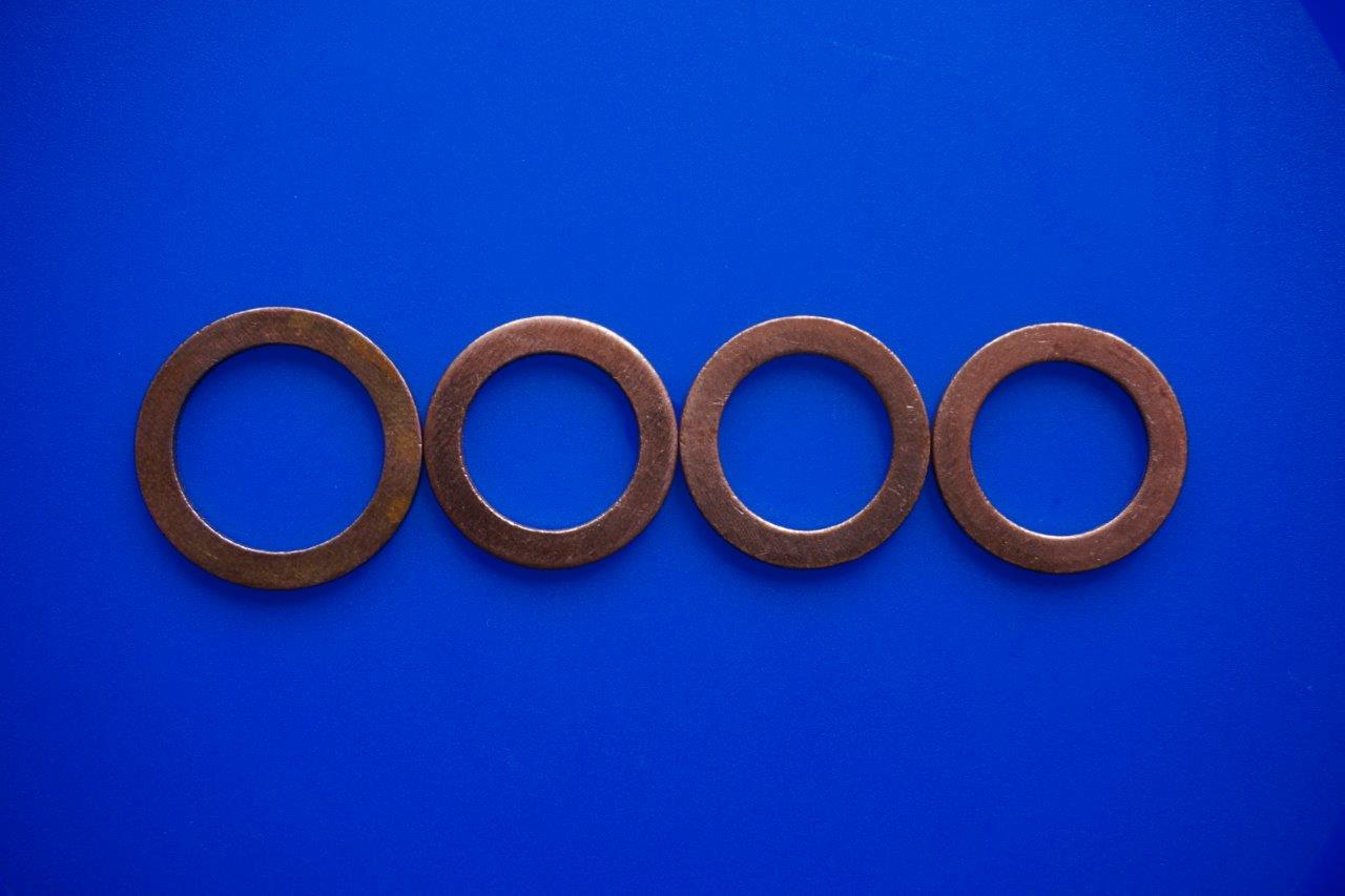

this is so annoying.
i ordered a few things for the oil changes on my wife's Audi and my car. i figured the price was right i may as well throw the drain plug seals in on the order. the drain plug seals that arrived are again small! they are identical to the one the dealer gave me in my original post.
i believe i need p/n 007603-014106, which is 20x14x1.5. i'm not sure on that but i am 99% sure what i received is way small.
they sent me 007603-012106, which is 18x12x1.5
i am going to try to confirm somehow. sheesh.

here is the take off from my last oil change (can't believe i was able to find it) and the three i received. width on the bigger on is a tenth or so less than the others, which makes sense as it's used (crushed). but ID is 14mm vs. 12 on the others and OD is 20 vs. 18.
i have no idea what's going on. i bought my car with 1200 miles in 2013 and have done all of the drain oil changes. any that weren't drain were vacuum dealer changes.
Attached Thumbnails oil change drain plug-dsc01644.jpg   oil change drain plug-dsc01645.jpg

The oil pan gasket is 14mm X 20mm and is copper
The cooler gasket is 12mm X 18mm and is aluminum
Both are 1.5mm thick.
