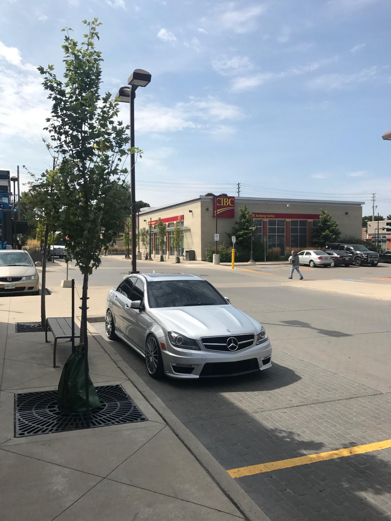

Here is my car with the following:
H&R Coilovers running on lowest setting up front. No perch in rear.
15mm spacers front
12mm spacers rear
15mm spacers front
12mm spacers rear
It does look great, just don't understand why one would want to increase the front track another 3mm from OEM over the rear.
If you stand in front of the car and look straight down the side the front axle is already wider than the rear in stock form. Adding another 3mm in front to that does not make sense, unless there is some benefit. I believe it was originally done by Mercedes to better the handling.
Did you also need to use the "crash bolts" to stop pulling to the right?

Old Aug 31, 2017 | 09:45 AM
MTV10's Avatar
Joined: Aug 2014
Posts: 1,060
Likes: 98
From: Montreal, QC
E55 AMG & C63 AMG
Increasing the track up front fills out the fender. Car is sitting flush all around. Why would you want a more sunken look? You've got the wide fenders up front... fill em out !
