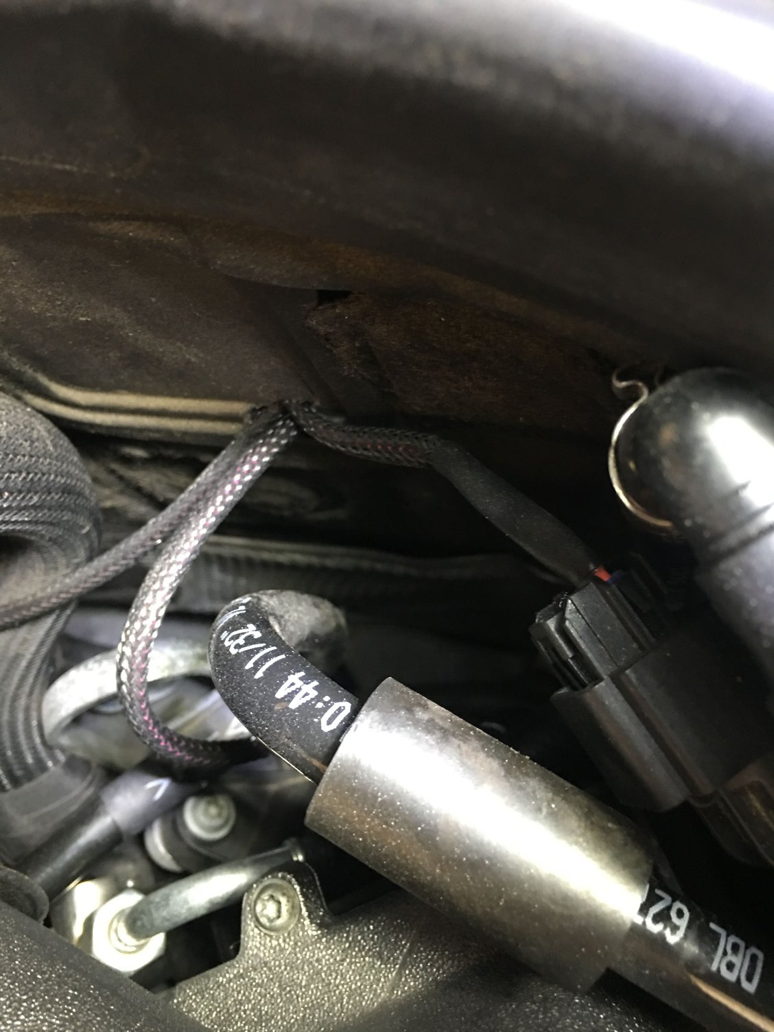

Hey would you be willing to post a closer pic of your control unit with how the two fuel lines connected? Just curious cause the two vids he did were shot kinda far back and so I can't make out the details. I know I'm sure it would be self-explanatory if I had the unit in my hand but I'd like to reference an install. Helps with the confidence you know...

With the airbox out its easier to see, but I didn't do that. The blue connector is the fuel line attached to the ethanol sensor. The brain box is tucked behind where the spring perch is at. Hopefully this helps. When you get the pieces it will make sense. The silver nut and metal fuel line is attached to the fuel rail. It's pretty easy.
