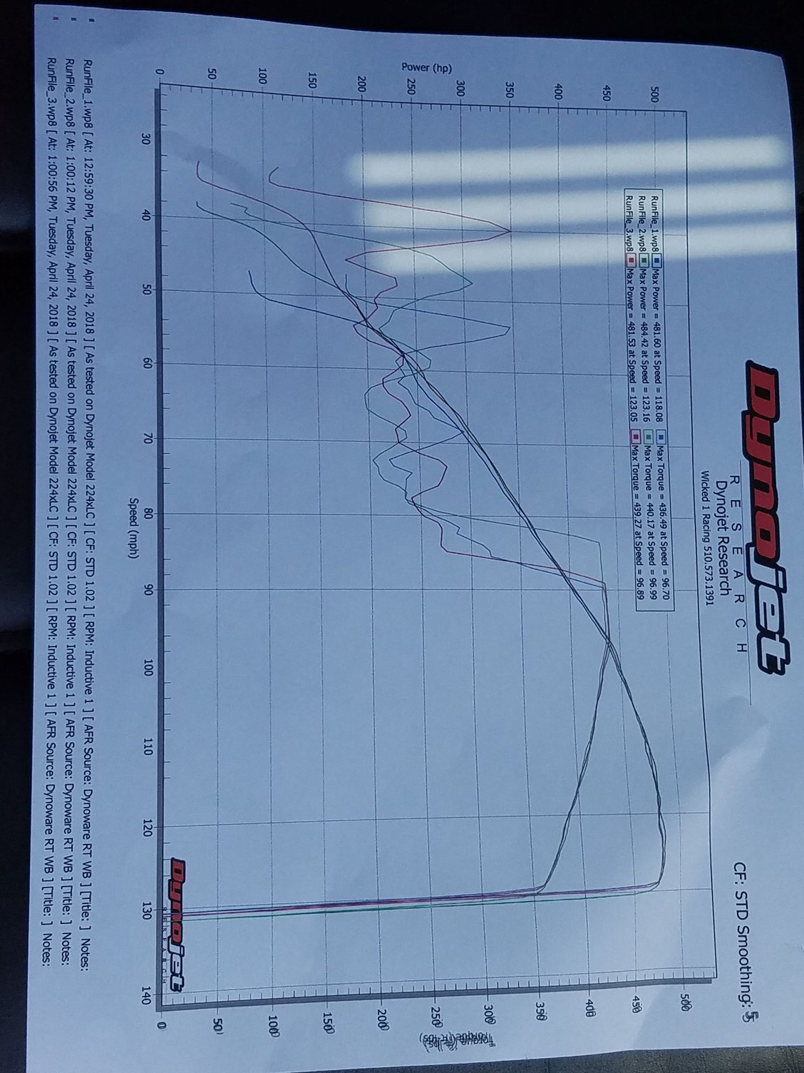

09 c63 amg dyno number
mmbh headers with x pipe stock catback stock air filters with 550 injectors e85 stock fuel pump
nice! What tune are you running? Are you catless?

I have the eurocharge v5 tune and I do not have a cat I was expecting to hit 500hp but the car performance amazing

Could you please explain what's going on with that graph??!
Or am I missing something?

The scribble lines they missed up and put it in sport mode the 3 consistent lines are on m mode
tbh 480 at the wheels with a decat and tune is actually pretty damn good.
If your car can put down the same figures on another dyno, i'd say it's as good as having a 500whp glory dyno

Looks like the dyno lost its rpm signal.i would redyno and make sure it's in dyno mode and get the air fuel.
especially since you have bigger injectors

Just realised it's an E85 car.
TBH it's still not an awful number. Wasn't CaptnCharisma at around 470whp, albeit on stock headers/cats...but then he was running the correct E85 tune for it. Maybe you need the aggressive E85 tune loaded to your ecu.

Do you think I should get the v7 tune and ask Jerry for a more aggressive tune

By their own admission, the claim was up to ~520whp with their V7 E85 tune when used with headers, so yes you probably should speak with them about a better tune.
Look up the original E85/Flex Fuel thread from the autumn and you'll see what I mean.

Your going to get about 17whp with the flex fuel kit and 80% e85 without a retune. If you retune for that high percentage of e85 then your going to have to run e85 all the time and basically lose the option of running pump if you want to mix.
You should ask eurocharged for the v7 regular tune. It makes another 10-20whp over v5. Probably put you at 500whp without tuning for e85 and then be married to it.
But if you plan on running e85 only then get the v7 e85 tune and pick up another 10-15whp
