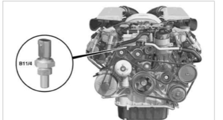

thanks! I have a new thermostat so just going to replace it! Although giving. It a womp with a mallet would be such an easy solution !! it did happen after a very very cold night. Where is the engine coolant temp sensor located? Is this an easy DIY?
