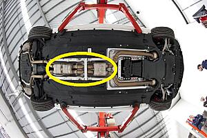

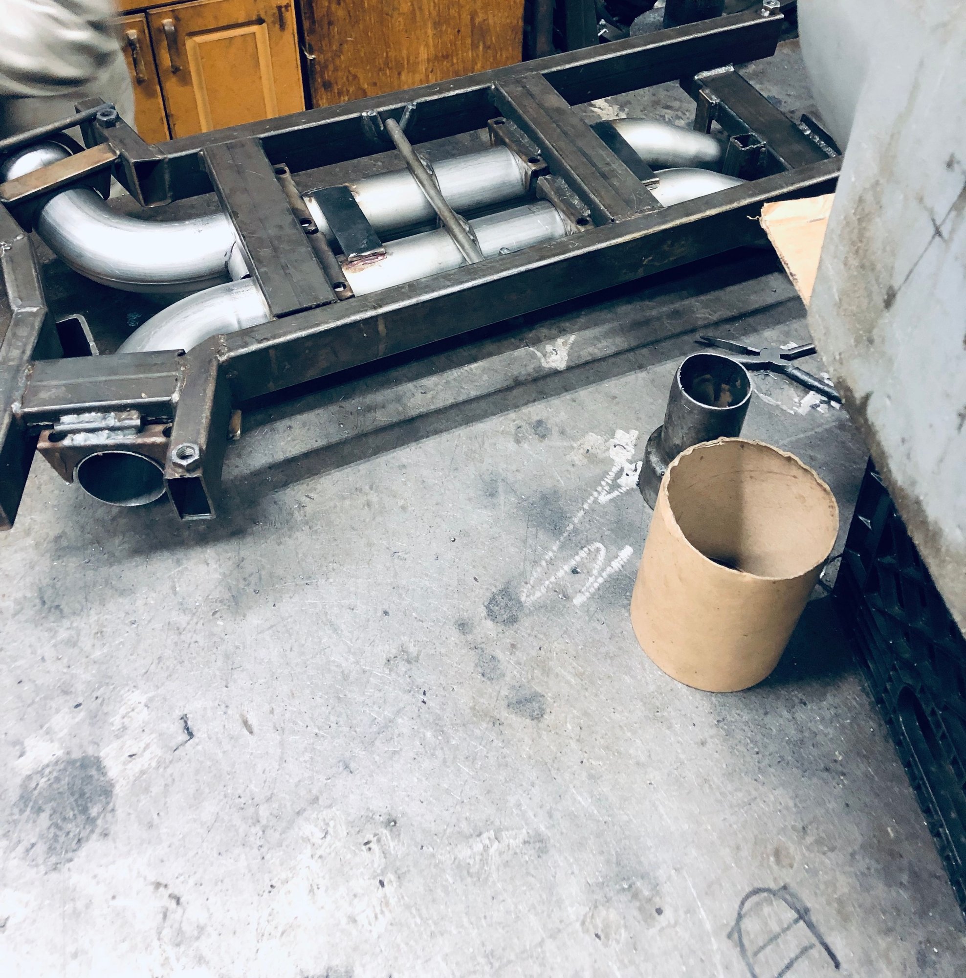

I plan on removing this entire section, and replacing with either strait-pipes or an X-pipe...
Probably gonna have them welded in permanently, but might splurge for some V-band flanges.
FWIW - the forward section (right-side) is the secondary cats, the rear (left) section is the resonator.
And Mikes Power-Pipe replaces only the resonator...
I thought Mike's power pipe only replaced the secondary cats
This is incorrect
Mike's pipe replaces the secondary cats which are on the RIGHT in this pic
It DOES NOT replace the resonator.
Taking out the resonator causes a drone in the car at cruising speeds.
It's best to keep that

Originally Posted by 95gsrturbo
This is incorrect

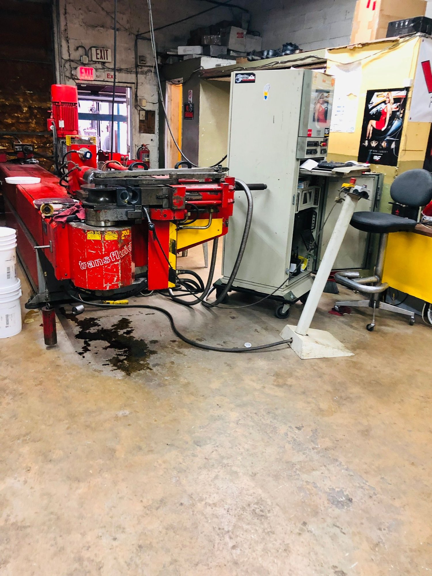

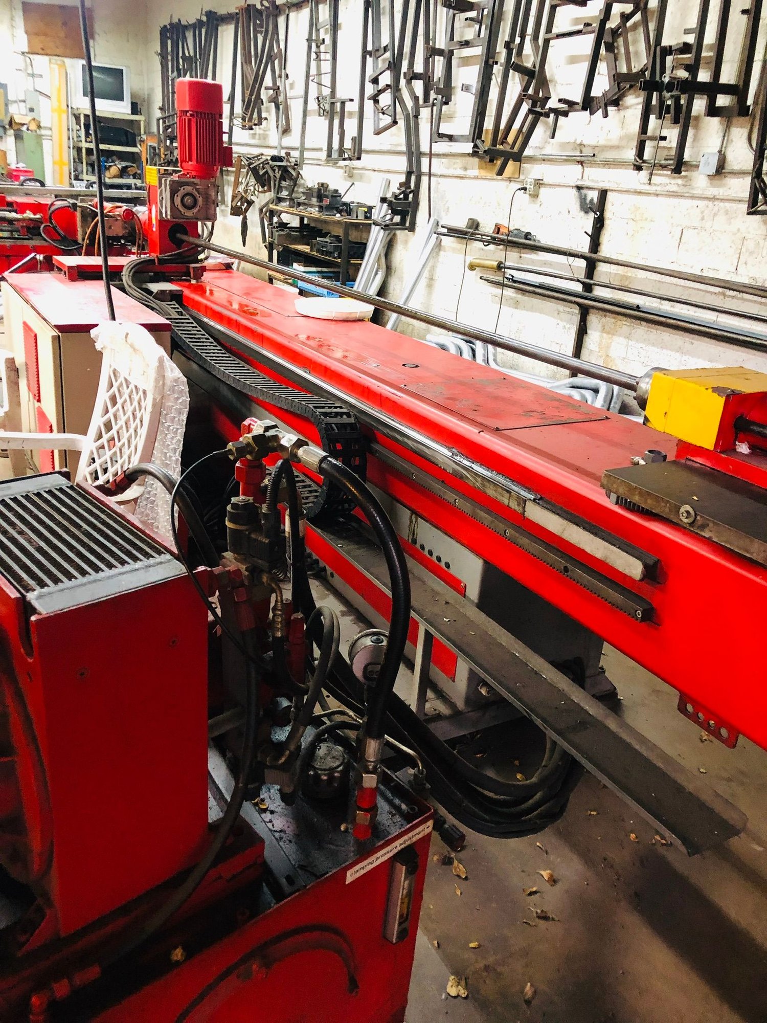

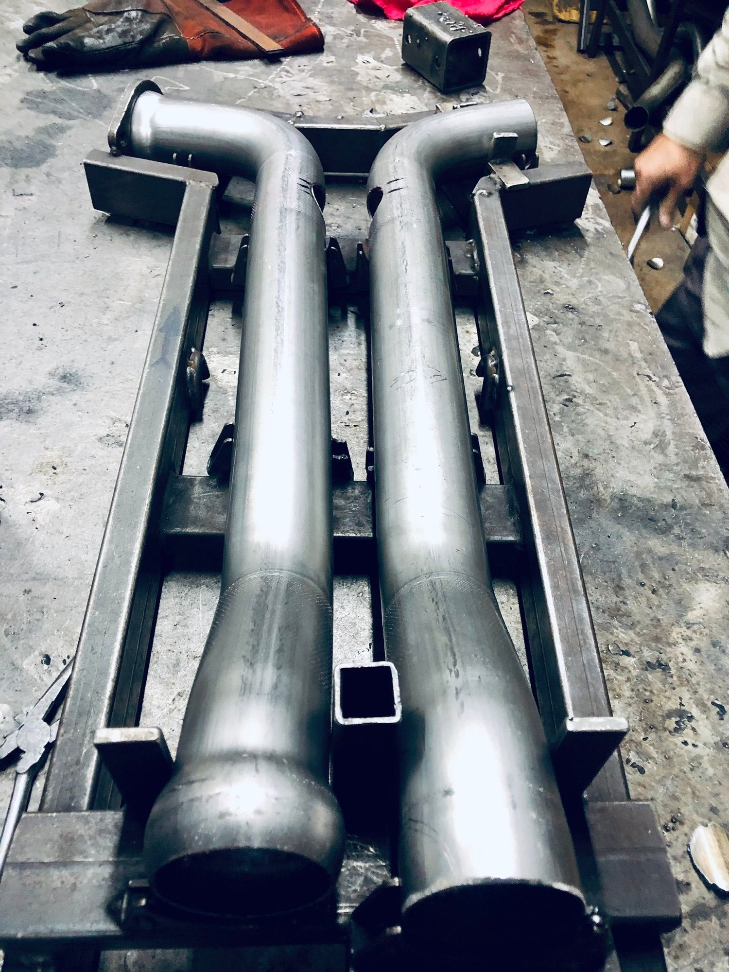

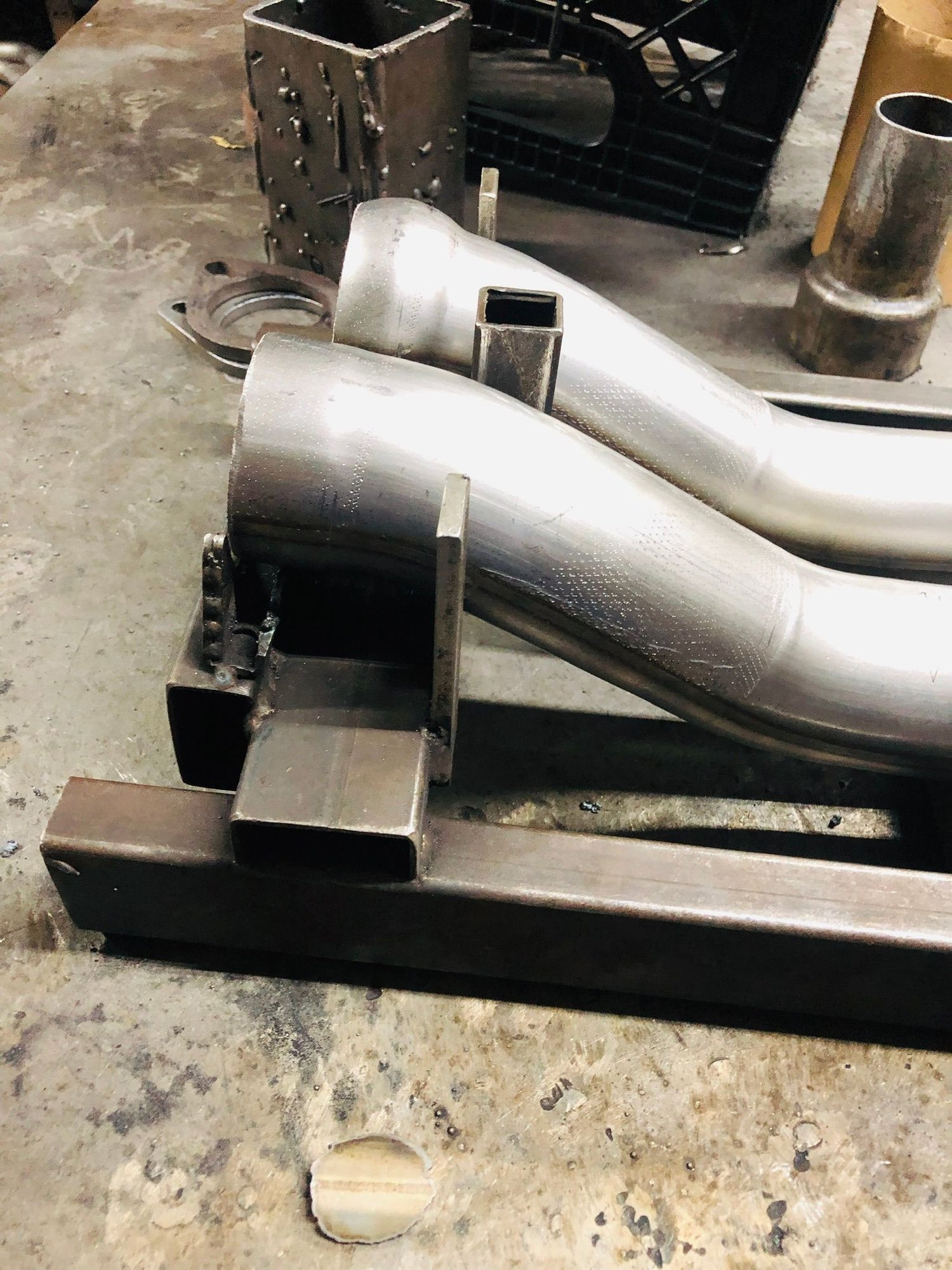

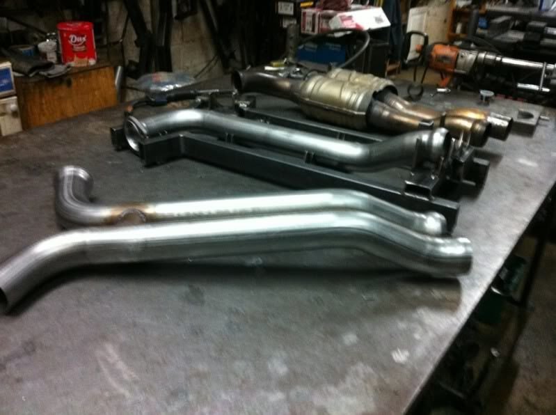

My power pipes remove the secondary cats NOT the resonator. If you do a resonator delete the I will make you an H power pipe to keep the balance and flow equalized between banks.
straight power pipe ( only if you have a resonator )
H power pipe ( only with a resonator delete )
power pipes are US mandrel stainless steel
NOT cheap China steel or aluminized piping which is bent at any muffler shop using a regular bender. The mandrel bender ensures a true 2.5 inch diameter bends.
As I always say don’t go Honda Civic with cheap exhaust mods and expensive car.
Disclaimer : I don’t have anything against Honda people..lol fine folks I was one of the back in my youth.

Originally Posted by Travis Decker
Is the oem exhaust stainless?
If not, how do you weld the Vband to the OEM exhaust? I am guessing the Vband is stainless wince the power pipe is stainless?
Are you welding stainless to non stainless?
There is no welding. The V-band allows you to clamp the exhaust together without an exhaust leak.
Scroll back up to Dadcar's pic. On the left you'll see a clamp with 2 bolts that's the V-band. It's also the location you make a single cut.
What I liked about Mike's design is that it's easily reversable
