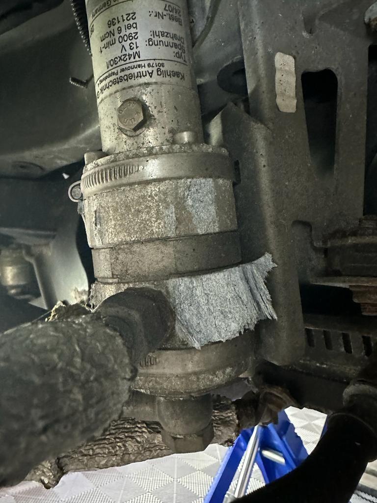

CLK differential pump
Is it still possible to get hold of a rear differential pump and cooler for the CLK black series and are there any alternatives? Thanks

hi it’s actually because the pump has corroded. I assume we have to replace whole unit or can we manufacture the part that corroded as it’s pure aluminium . Picture attached

If you can't get an OEM replacement and are simply looking for a functional equivalent, a Tilton oil/diff cooler pump in place of the OEM one should work just fine. It is held in place by two worm gear clamps. You may need to get an adapter for one or both of the fittings depending on size, but that should be about it.
