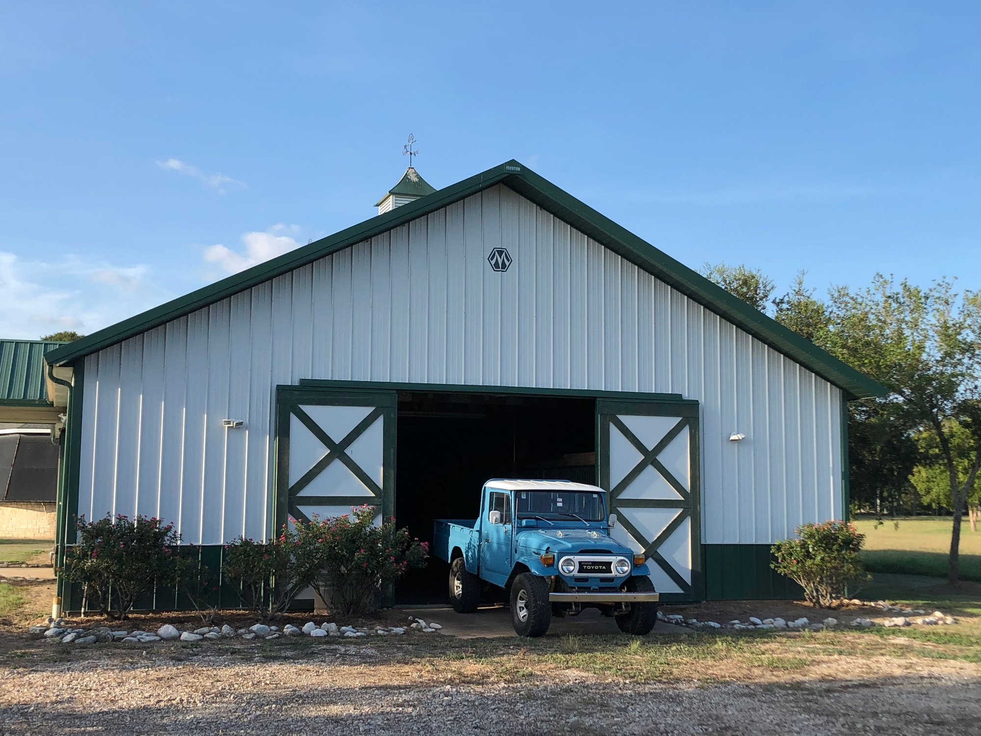

Thanks - Agreed on the 105....... I want a 4dr pickup once they hit the 25 year import mark..... this is holding me over for now
