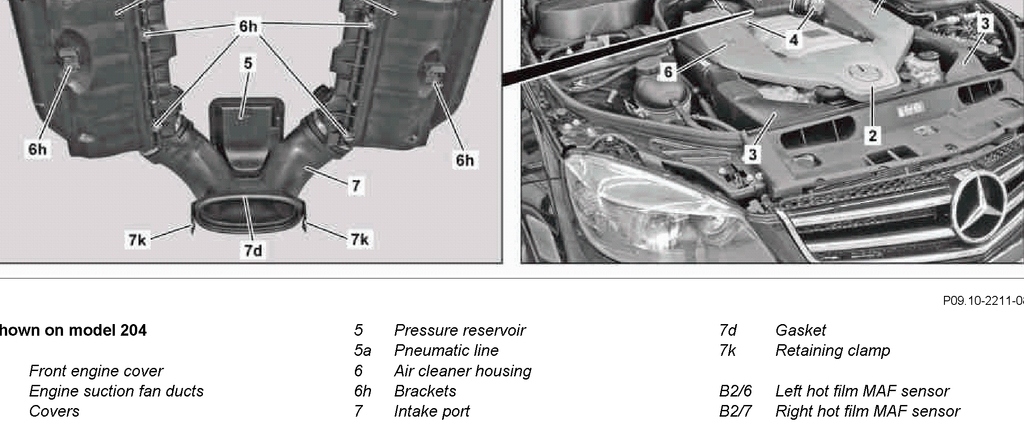

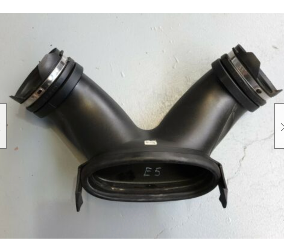

Any one can explain What is the purpose of these little box sitting on top of the Y intake collector. I found out by blowing air into the little tube on the bottom right corner that the box has some air leakage all around.. anything to be concern?!

I always thought it was some type of intake resonator. Blowing air pay cause the seal to open up while sucking air into the engine might not leak, I would test it when running on the car to see if it leaks. Other models with the M156 didn't have the box at all, so assuming it is something to help with intake noise.

It’s a Heimholtz resonator to reduce intake noise. Or a brake booster canister. I’ve seen it described as both in various MB literature. It shouldn’t leak.

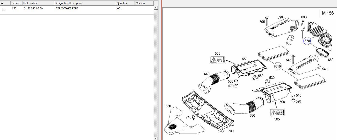

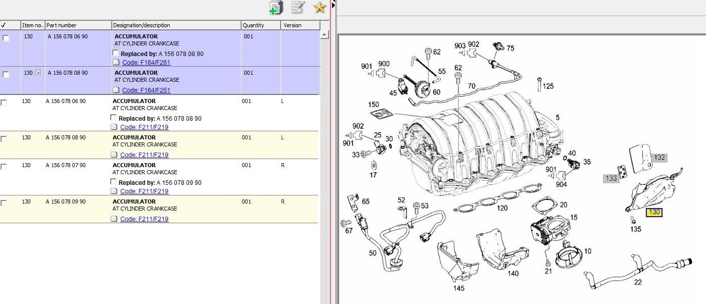

All M156 engines have a vacuum reservoir, older engines have a metal canister attached to the block I think. I don't know why they redesigned it. I attached a WIS PDF showing the difference.

Sorry for the delay,
Looks like the black reservoir was used initially with the W204 C63. As EPC shows it did not have the metal reservoir installed at all.
Keep in mind that part # A1560900329 can be used in any M156 regardless of the model.

I'm trying to install the old setup on my c63 and was looking for the metal canister part number.
