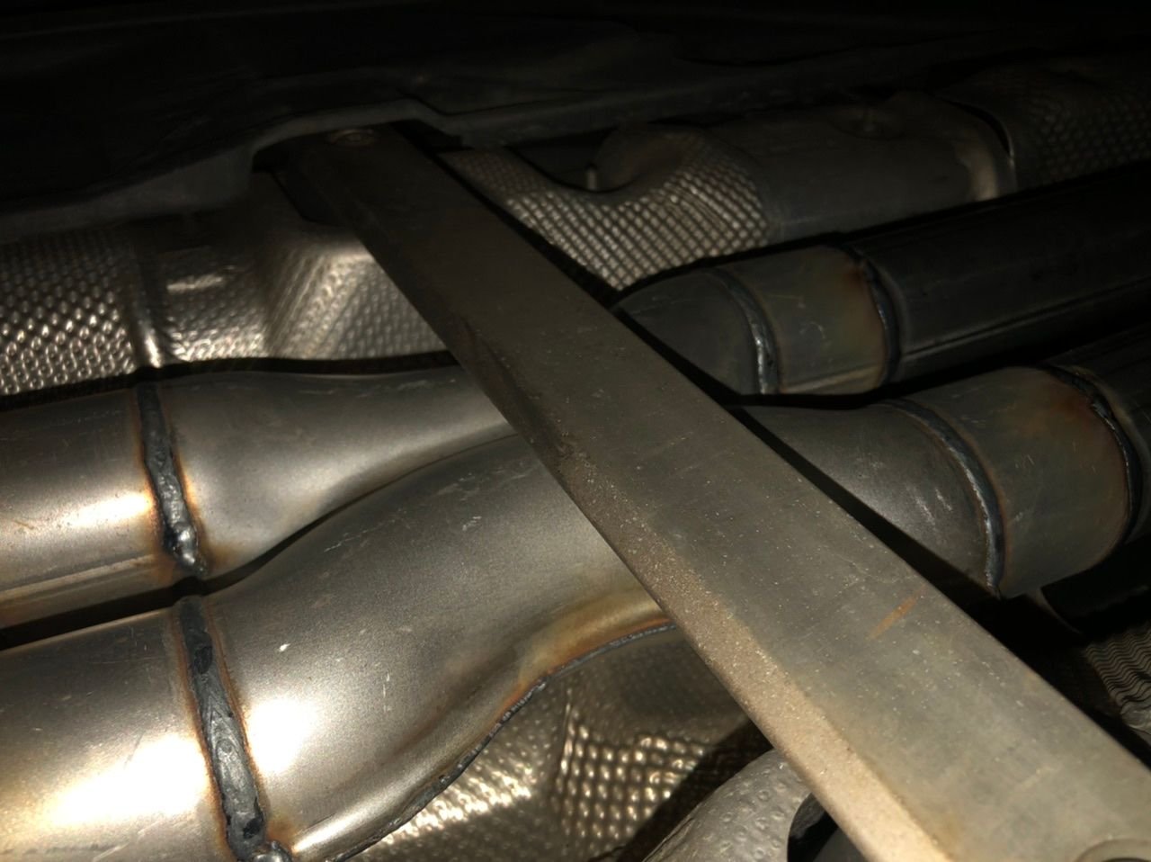

I decided to get the piping redone and it only cost me $100. Initially, I had 2 straight pipes that replaced the secondary cats and resonator. I decided to put in a x-pipe. The muffler shop installed the x-pipe directly above the support bar that goes across the bottom of the car. My question is, doesn’t the x-pipe need to be a little farther up toward the primary cats? Does it make a difference where I have it now? Here is a picture. Sorry, it’s upside down, but I think you get the point. Thank you.

nice welds...you're fine where the x-pipe is.

only bad part is it's aluminized piping and will end up rusting over time, but that's what all the generic muffler shops use. Finally some decent welds though!!!! Everyone of these deletes i see usually make my eyes bleed, between press bent cheap piping, leaks, rust and horrible welds. They did a good job on yours!
