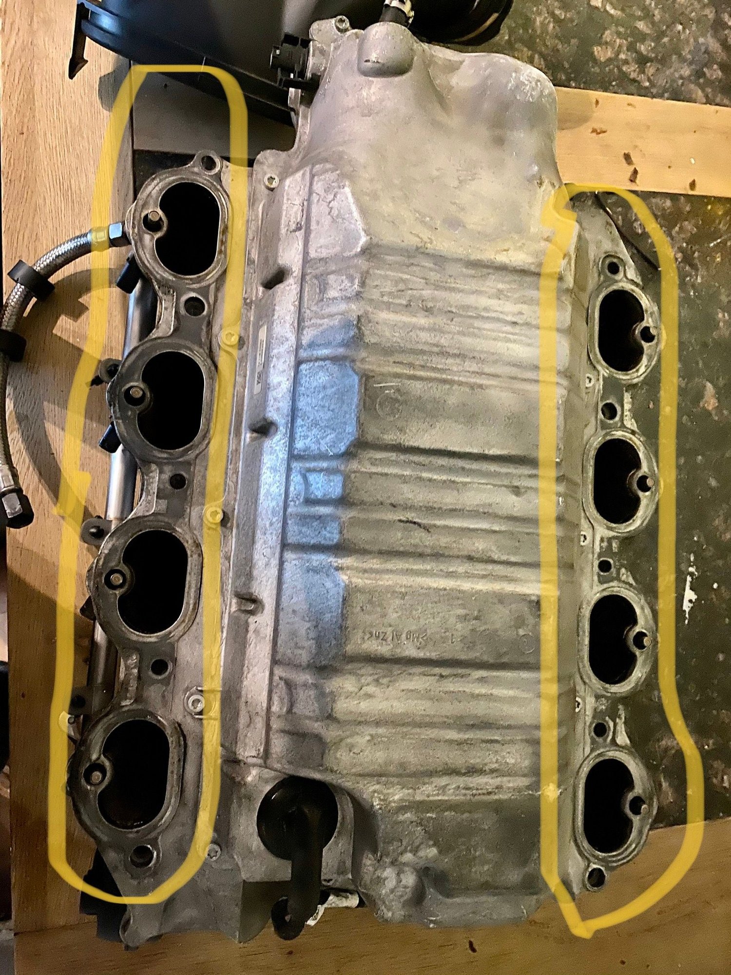

Thanks again for the replies . I have bought some gasket sealant and have the car stripped down for tomorrow . I am picking 4 gaskets up from the dealers along with 10 more bolts . I am about the clean the surfaces down on the manifold and on the cylinder head , where did you put the sealant on the metal on both sides of the cylinder head and the manifold before putting the gaskets on?
and the torque pattern and the sequence of 10nm then 90 degree then 10 degree still applies ?
Check my photo what I’ve attached and circled, is that part the only part what creates the air tight seal when there mates together , (where the metal is shiny on the photo)

Don’t worry too much about getting the mating surfaces perfectly clean. Just use a plastic scraper and fingernail and do the best you can with that. Don’t use a green Scotch pad whatever you do.
You have to make RTV-gasket-RTV-Sikky-RTV-gasket-RTV sandwiches (light coat on all surfaces not a bead) and get it all together with the intake torqued down before it dries. It’ll be a little messy since they’re not held in place by studs and the thing will try to move on you while you get the bolts in. I put the sandwiches on the heads first, then lowered the IM onto it carefully. Sorry I don’t have pics but you’ll figure it out.

yeh we’ve located the area it is right near the pcv valve at the back of the engine we can’t tell it if it the gasket or a split in any air lines , going to go and buy a can of brake cleaner now to try it and hopefully this will let us know. It just comes up on the scanner misfire 1,2,3,4 and this maf code , car is fine for 20/30 seconds then the engine light comes and flashes .. 😐
