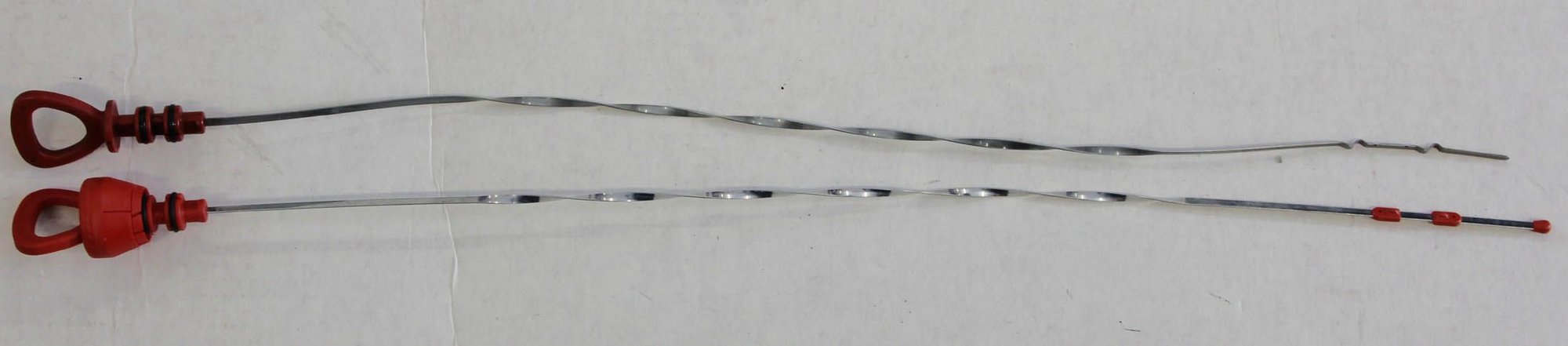

My dipstick is twisted. No clue how it happened but just noticed after owning the car for a year.
Trying to purchase a replacement but every dealership has tried locating but shows discontinued.
I've read that there were some issues with the dipstick popping out at high RPM which is possibly why they discontinued it but is there a replacement?
Part # 156-010-17-72
My dipstick is twisted like the one pictured here
My dipstick has the same handle as the one on the top of the image but has the level notches like the bottom one.
Yes, I've already scoured the forum for this and didn't find a solution

the bottom one is the revised part. you won't be able to find any previous variation new from the dealer.

I have the below revised dipstick on my E63. Mercedes released a service bulletin, talking about the dipstick being forced out a high RPM's.
So my tech replaced mine back in 2017. But it's the same M156 engine, so search for one using the E63 as a search perimeter.

Here's an update:
Found this listing
https://www.mbpartsus.com/p/Mercedes...ner=googlebase
Cross referenced the superseded part number 156010177205 in the Googles
Found this listing on Pelican Parts
https://www.pelicanparts.com/More_In...=0&SVSVSI=7316
Ordered. Will update once received.
