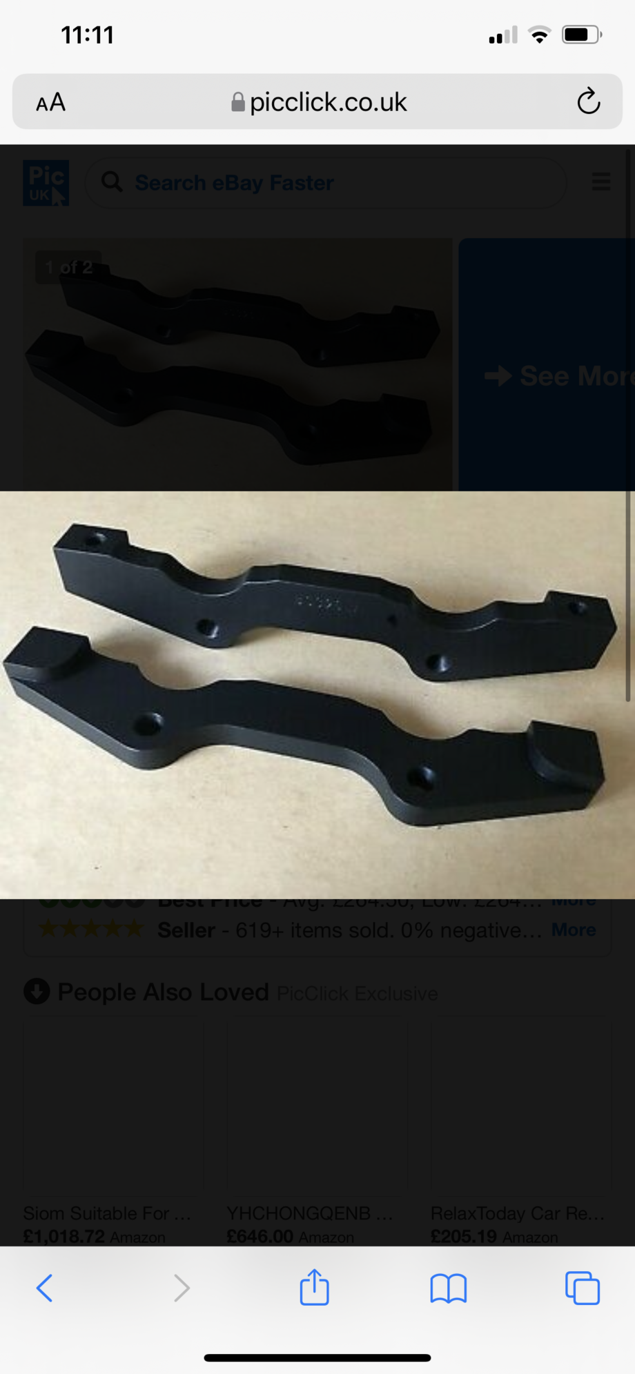

Originally Posted by PhuongNguyen
Has anyone thought about using 15mm threaded steel spacers? The 390mm rotors are pushed out 15mm each side. So the caliper will need to be pushed out 15mm. Using a 15mm threaded spacer between the stock caliper and bracket will extend it. You’ll also need 15mm longer cap bolts
Even if you could, I highly doubt that you have more than 15mm clearance between the wheel spokes and the brake caliper.

?? you’re going outwards towards the wheel. Not sideways. You’re extending the calipers out 15mm to cover the bigger rotors.

Yes which will put them closer to the spokes of the wheel. There’s not a lot of real estate between the caliper and the wheel spokes to begin with

Both. The spokes on most wheels likely curve inwards.

why would a spacer move the wheels towards the spokes? Also do you not understand what the custom brackets do? They are thicker for a reason. They move the calipers outwards about 15mm to cover larger 390mm calipers. You aren’t able to use the 18” c63 wheels when upgrading to the 390mm caliper.

how would a spacer move the calipers laterally towards the spokes? What do you think the custom brackets do? Hold the calipers in the exact same position? Go compare the stock brackets to the custom ones. The custom one moves the calipers outwards about 15mm to cover the larger 390mm rotors. You have to get at least 19” wheels regardless. 20” depending on barrel design.

compare the two. Why would it push laterally towards the spokes? LMFAO

Spokes curve inward the further they get away from the center of the wheel.
If you move the caliper away from the hub toward the barrel it can come in contact with the inward curving spokes.

if that’s the case then the custom caliper brackets will do the same because they themselves move the calipers outwards about 15mm. Do you not understand that part??

Correct.

Actually can we buy the oem black series caliper adapter for 390 disc?

nope, you have to buy the entire caliper to get it. MB doesn’t sell it separately.

same size calipers as black series, just with a different carrier bracket on the BS fronts to accommodate the 390 rotors. The rear BS brakes are a bit different with the knuckles being casted a bit longer on the rear calipers to accommodate the 360’s.
couple thousand for the front calipers from the black series. Not worth it.
