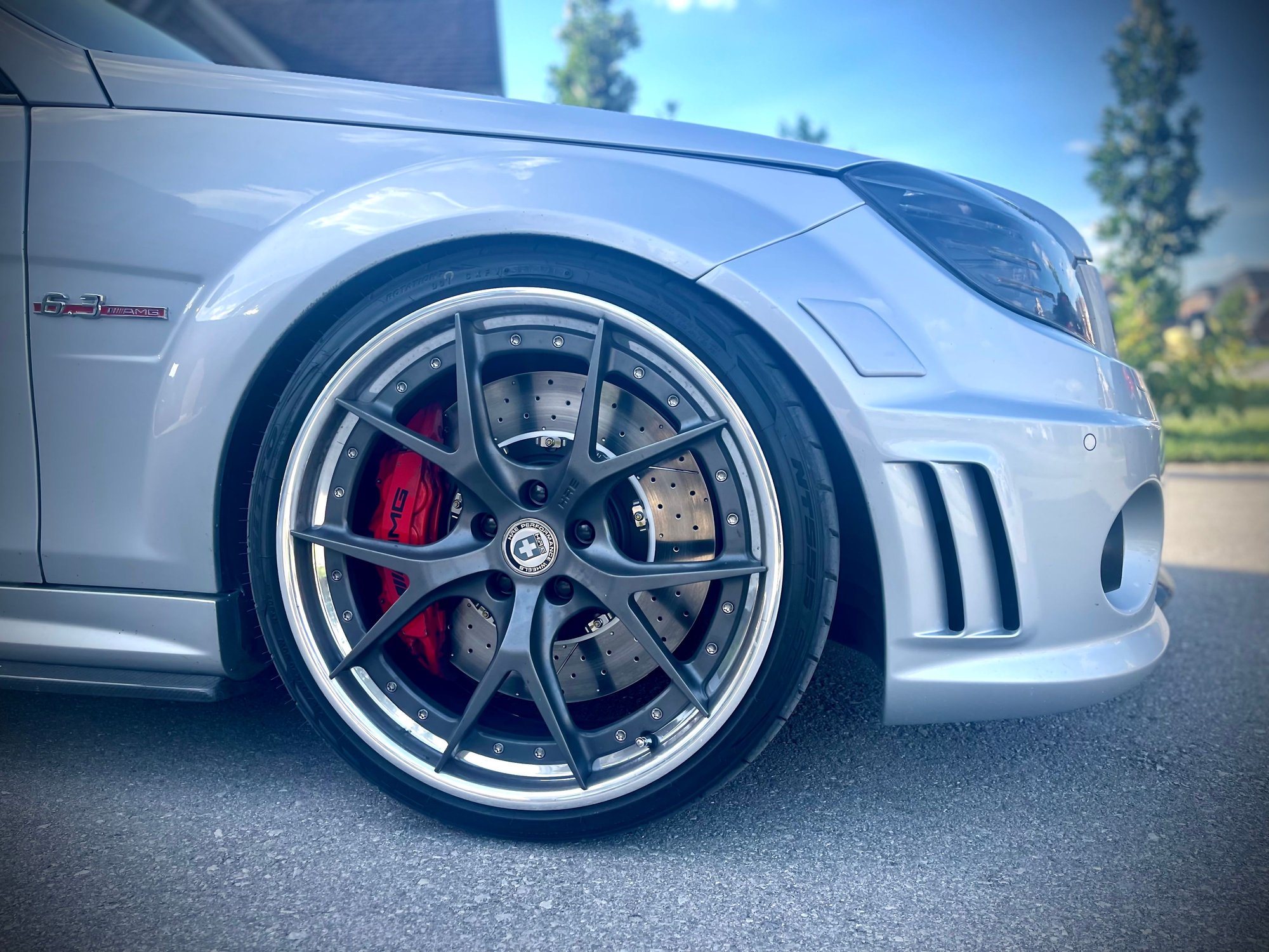

Old Jun 23, 2021 | 09:56 PM
  #135
Kriston's Avatar
Joined: Jan 2010
Posts: 2,276
Likes: 409
C63 AMG
was a long time coming, but finally got them on. They fill up the 20 inch barrels quite nice. Running Brembo OE replacement pads / stainless lines and Motul RBF. Really like the initial bite on the 390’s.
Old Jun 23, 2021 | 09:59 PM
  #136
cm60k's Avatar
Joined: Aug 2006
Posts: 7,053
Likes: 398
From: A.D., U.A.E
Waaaaaaa, Gorgeous..

Looks really good, I’m not a huge fan of 20+ inch rims but you car looks solid. Like the rim design as well suits the car 👌
Old Jun 23, 2021 | 10:15 PM
  #138
Kriston's Avatar
Joined: Jan 2010
Posts: 2,276
Likes: 409
C63 AMG
thanks, 20’s aren’t my go-to either for the w204. However with the wide body 19’s looked a bit small with the step lipped design on S101. I had done 20’s with my BBS LM’s years ago as well and went back to 19’s after.
the S101’s however are the most aggressive looking setup I’ve had on the car.
