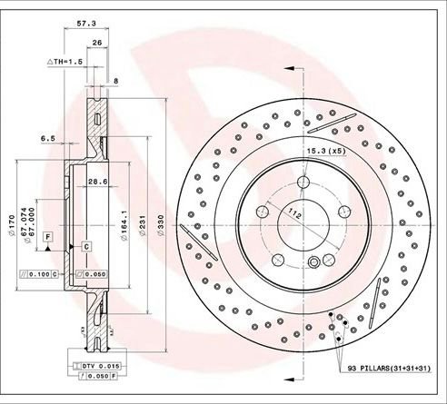

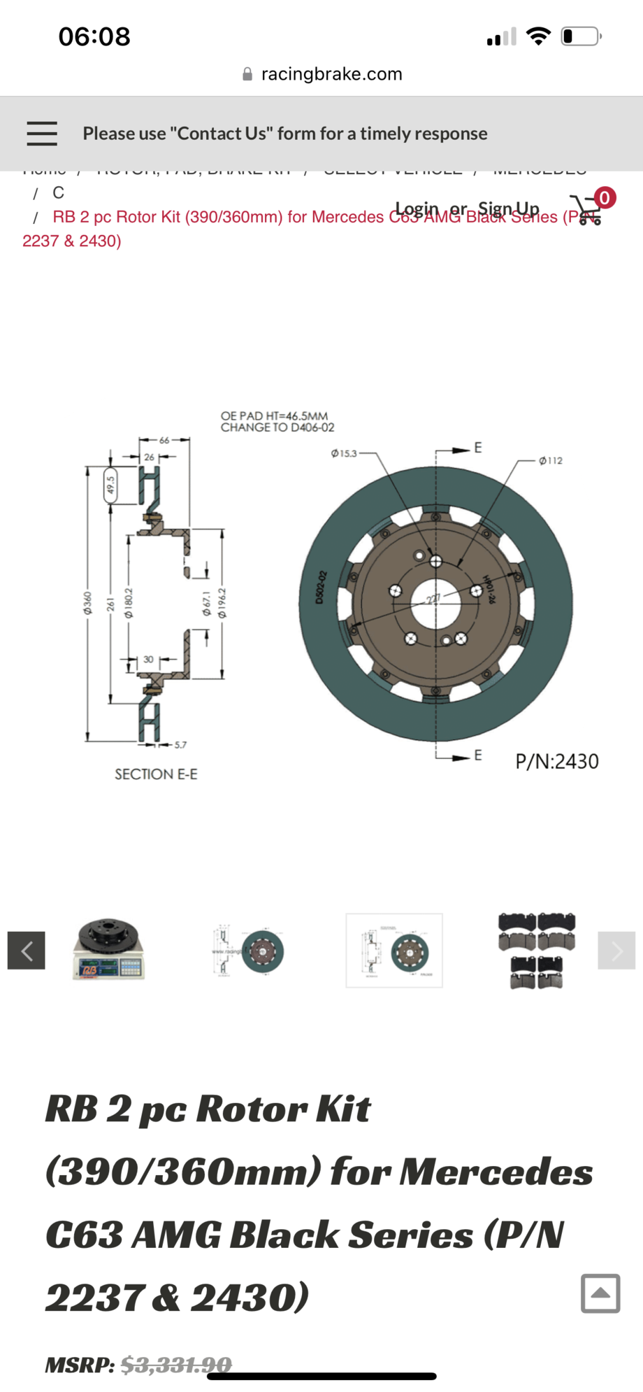

So if I am correct when using the handbrake the internal shoes push up against the inside sides of the 165mm pad on the disc? So a larger one they would not contact.
The reason I said about a 180mm is if you look below at the dimensions in the third picture the RB 360mm looks like it has a 180.2mm pad and the one I want to use in the second picture has a 180.1mm pad. So how does that RB 360mm work if the only other part replaced is the rear calipers which you have to do anyway. Sorry if I am missing something here with all this.
See below.
First picture stock 330mm rear discs
Second picture 360mm one I am thinking of using
Third picture RB 360mm rear

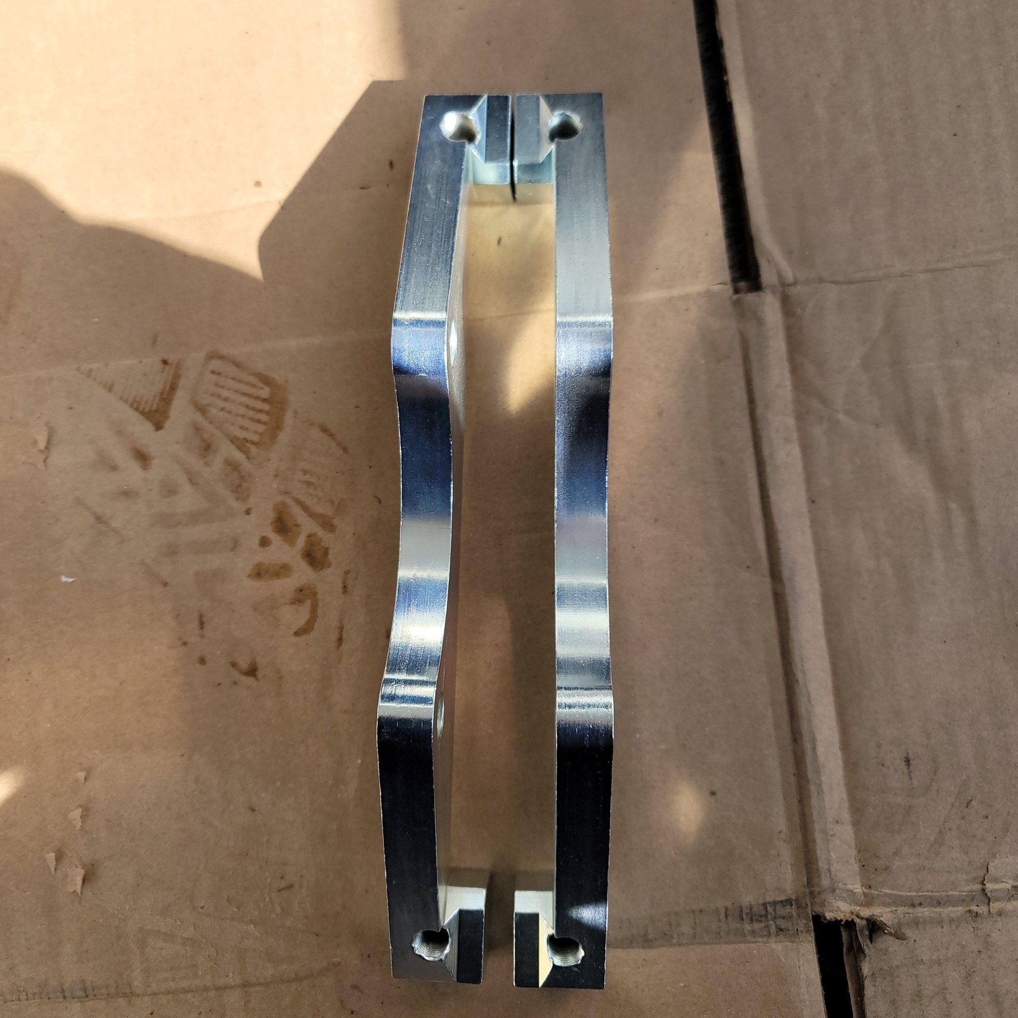

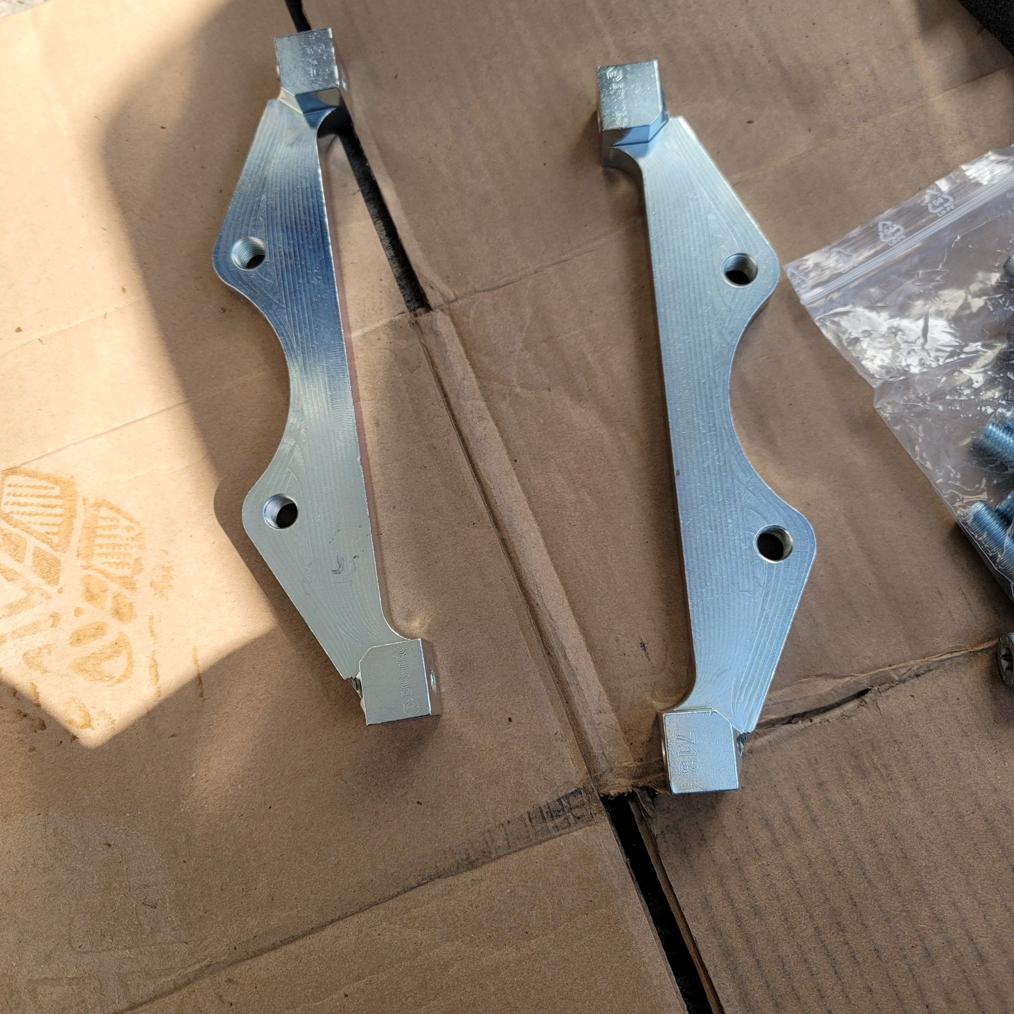

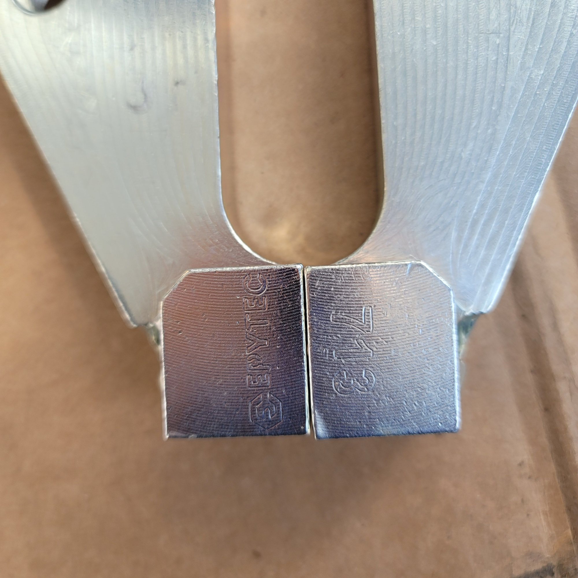

So Epytec now ships to the states via their eBay store. I purchased the w211 brackets and am waiting for them. They just cleared customs. Here's to hoping they fit! They have 204 211 212 and many other options listed so hoping they did their due diligence on the 211 since their seems to be some discrepancy and fitment confusion across chassis
Old Apr 12, 2024 | 11:01 PM
  #191
PNW_E63_AMG's Avatar
Joined: Jul 2022
Posts: 47
E63 AMG
Epytec w211 shipping to USA

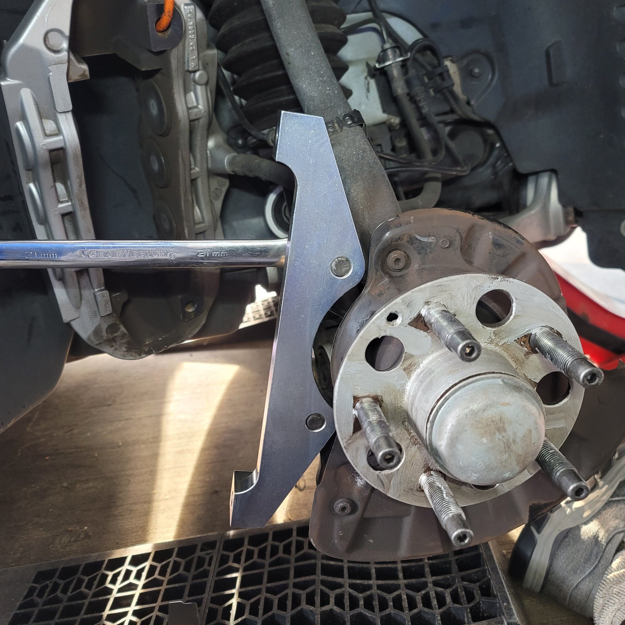

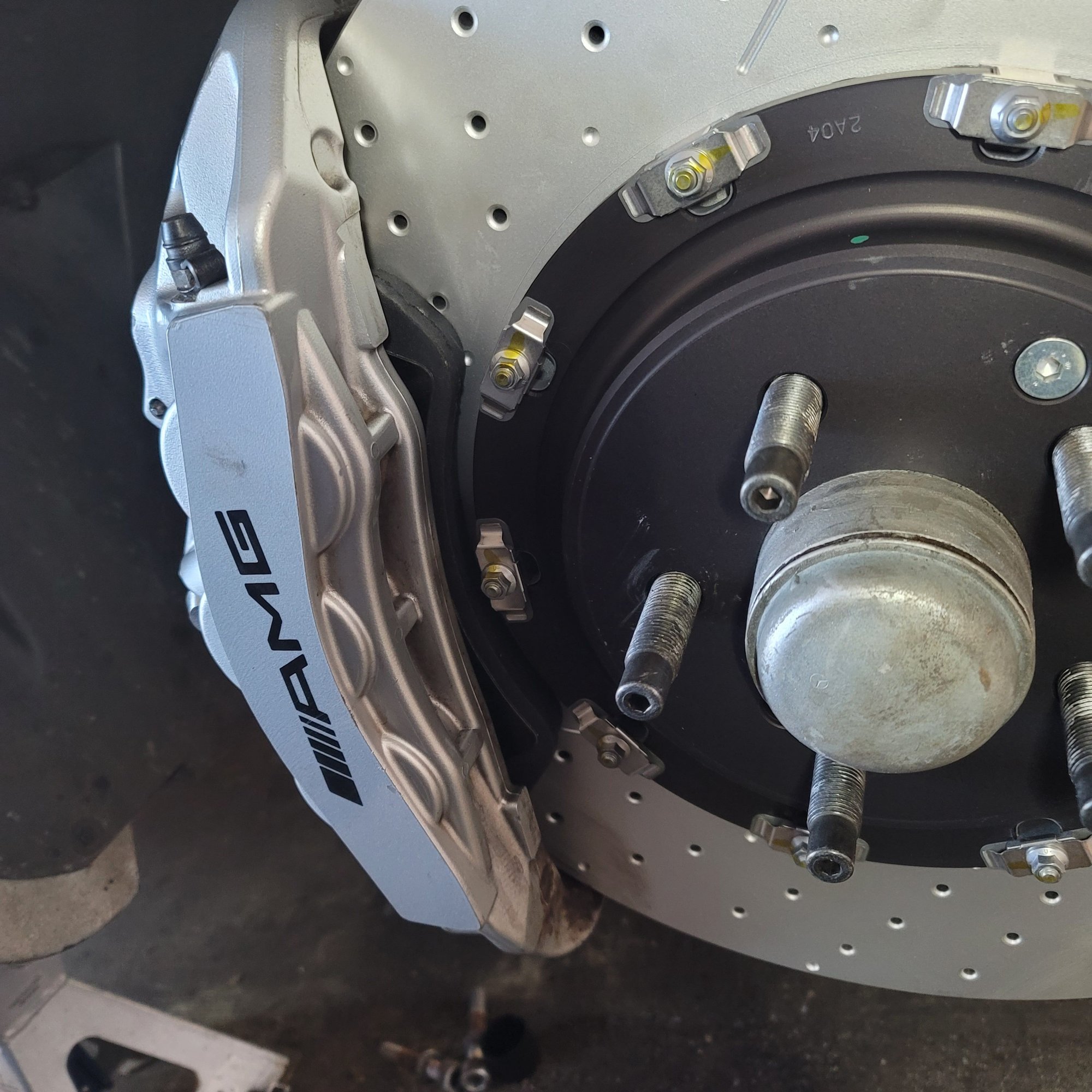

And they're here and they fit perfectly!

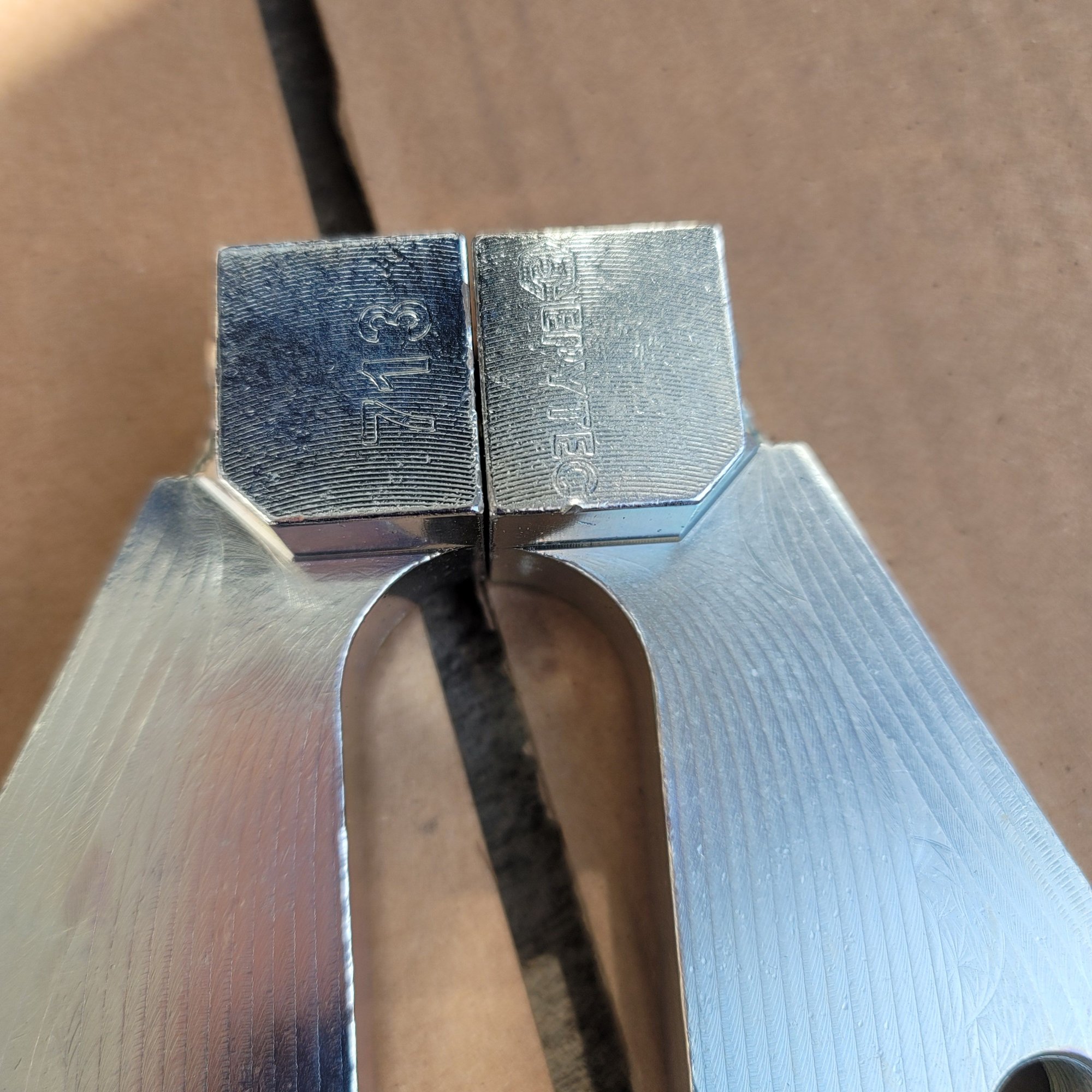

Let's beat a dead horse. Since this is my family hauler I didn't really want to do spacers nor an aluminum bracket. Lo and behold Epytec out of Germany now ships to the states via their Ebay store! Just giving this information for you to do what you will with. I needed new brakes and the 390s were cheaper so here's the new setup.
w211 E63 uses Epytec part number 713 made of STEEL.
https://www.ebay.com/itm/32511615237...Bk9SR8aU4dXaYw
W211 e63
Part number 713 for W211 E63

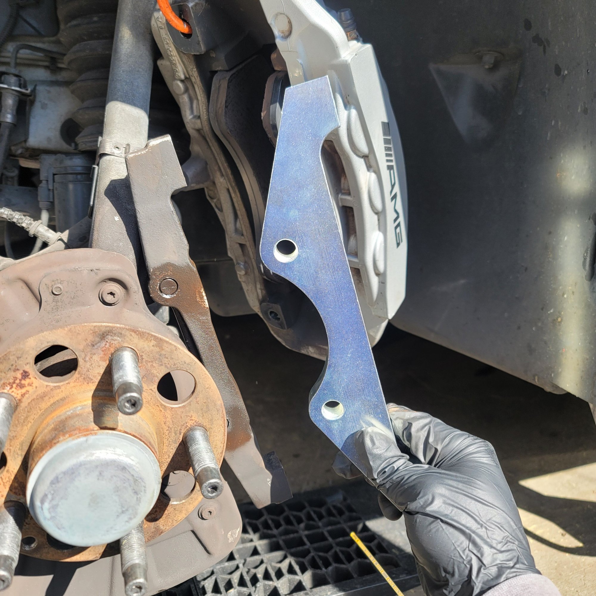

I didn't see the bracket for the w204 listed and messaged them asking if they have a bracket for w204 available. They sent me a reply saying they won't break eBay's rules and they can't sell anything not listed... haha I'm guessing something got lost in translation
Old Apr 13, 2024 | 10:54 AM
  #193
Joined: Jul 2022
Posts: 47
E63 AMG
weird, I'm sure I saw it. I'll try to find it for you.
its there. Part Number 890
Ebay Item number 323558442235

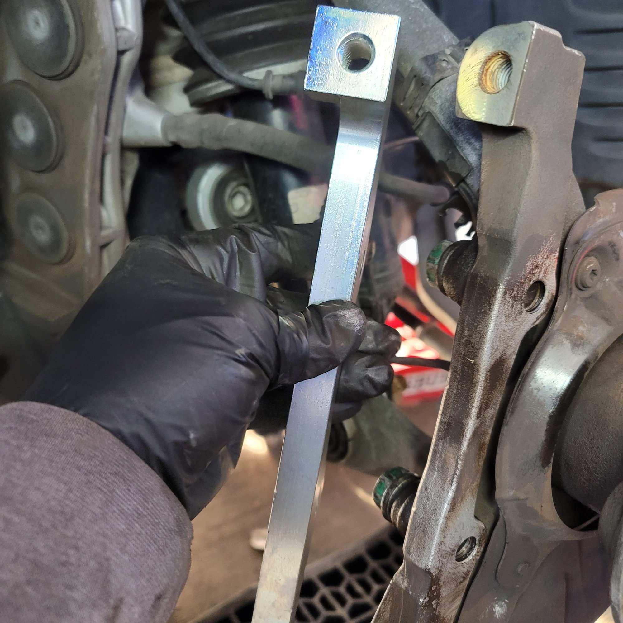

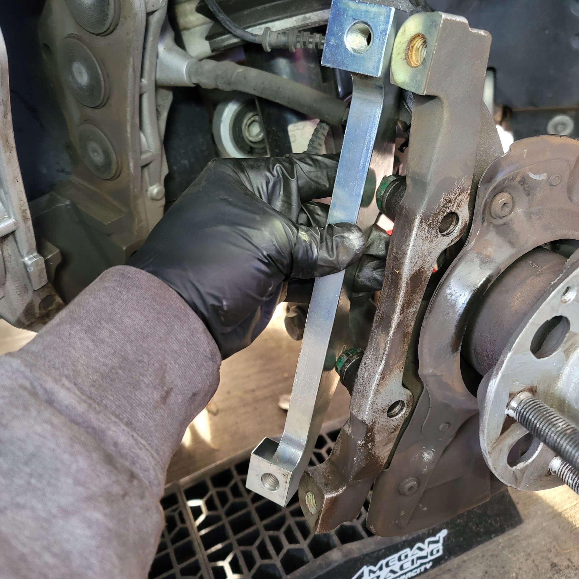

For anyone interested in the Adapter Brackets described below, long sold out via this forum, and then sold out on eBay:
(Front Caliper Adapter Brackets for 390mm Rotors, guaranteed to fit OEM MB 507 Wheels, any MB OEM 19" Wheels, and likely All Aftermarket 19" Wheels):
I have an extra Pair of Brand New, Never Mounted Adapter Brackets.
$325 Shipped to Continental USA, or local pickup in Southern California (Bakersfield, or Santa Monica to Torrance areas)
I've been using these Adapter Brackets for 4+ years without any issues with the 507 Wheels, and under some very severe braking conditions.
Please Note: they do not come with the Caliper mounting Bolt hardware
You may likely need new/longer bolt hardware, but I am not 100% sure, as it's been more than 4-5+ years, and I believe my technician Matt simply re-used the RacingBrake hardware left over from the RB kit i had purchased.

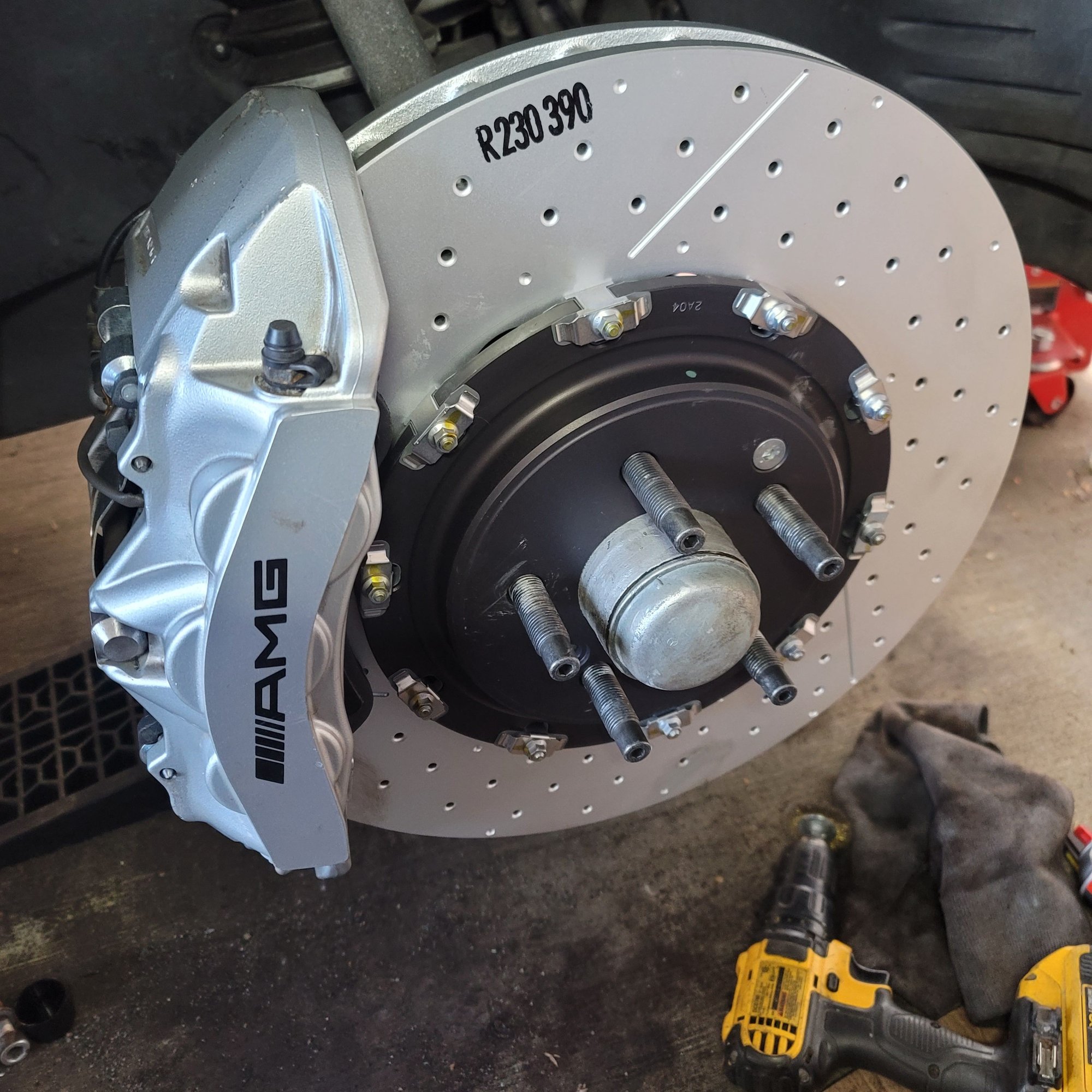

Old May 19, 2026 | 06:29 PM
  #197
Lemons6245's Avatar
Joined: Oct 2023
Posts: 35
2015 C63
Guess I should have done more research, but did not realize that there was a interference with some 390 brackets and 507 wheels. Is anybody running the running the EPYTEC bracket on stock 507 wheels? I read through this while thread and couldn't find that answer and my brackets are on their way to me now.
