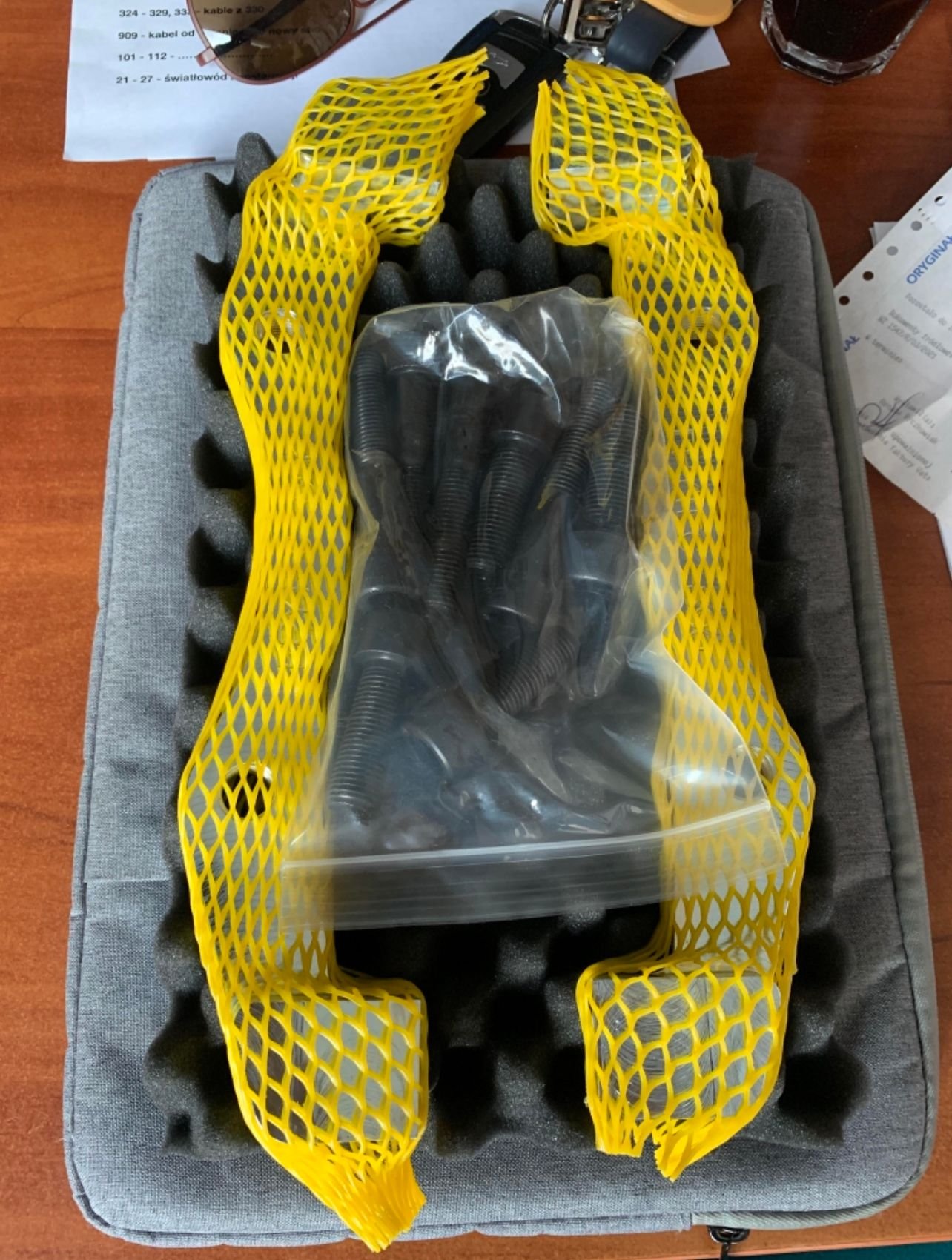

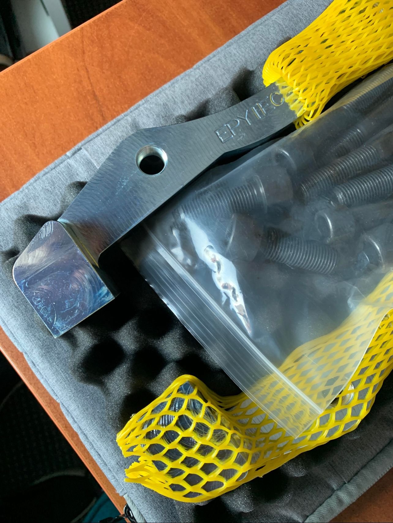

Look what we got here. The quality looks great!

Holy fancy packaging.
