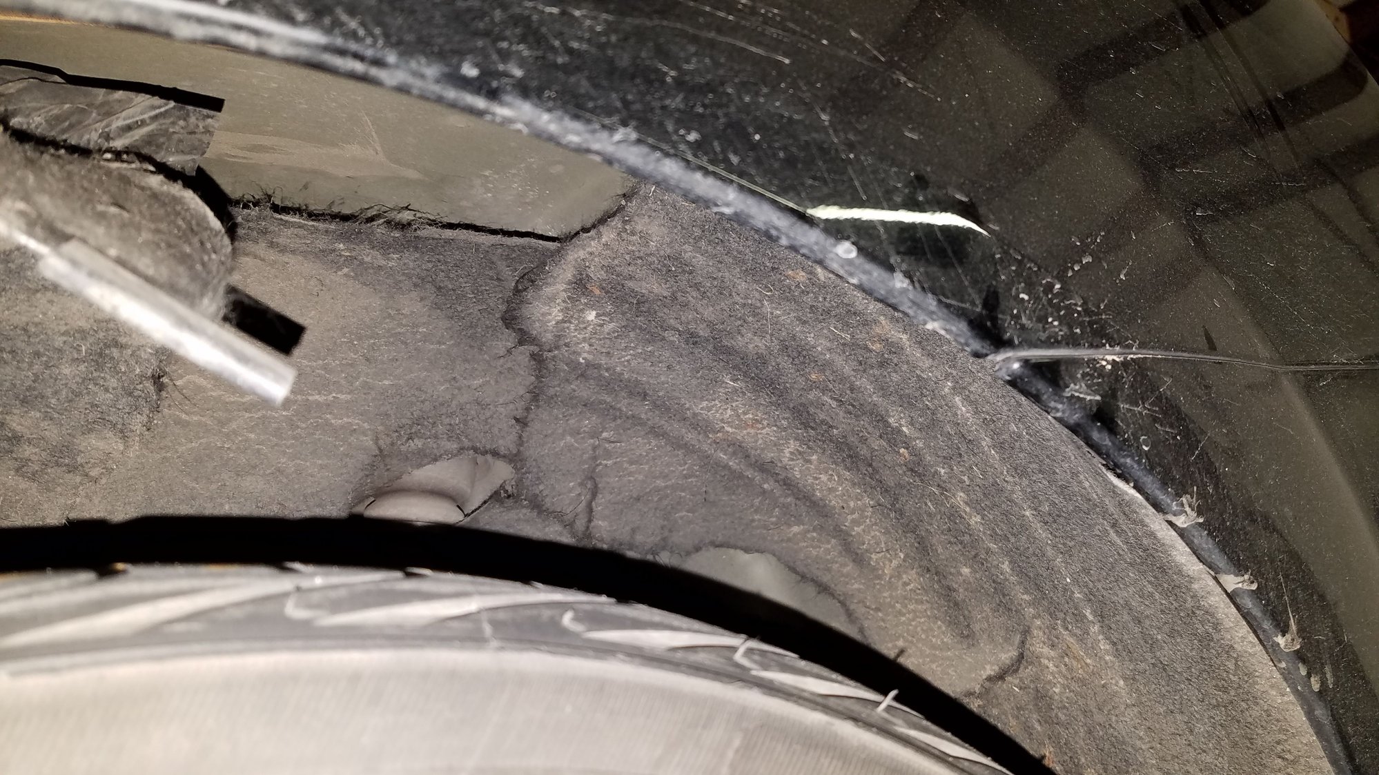

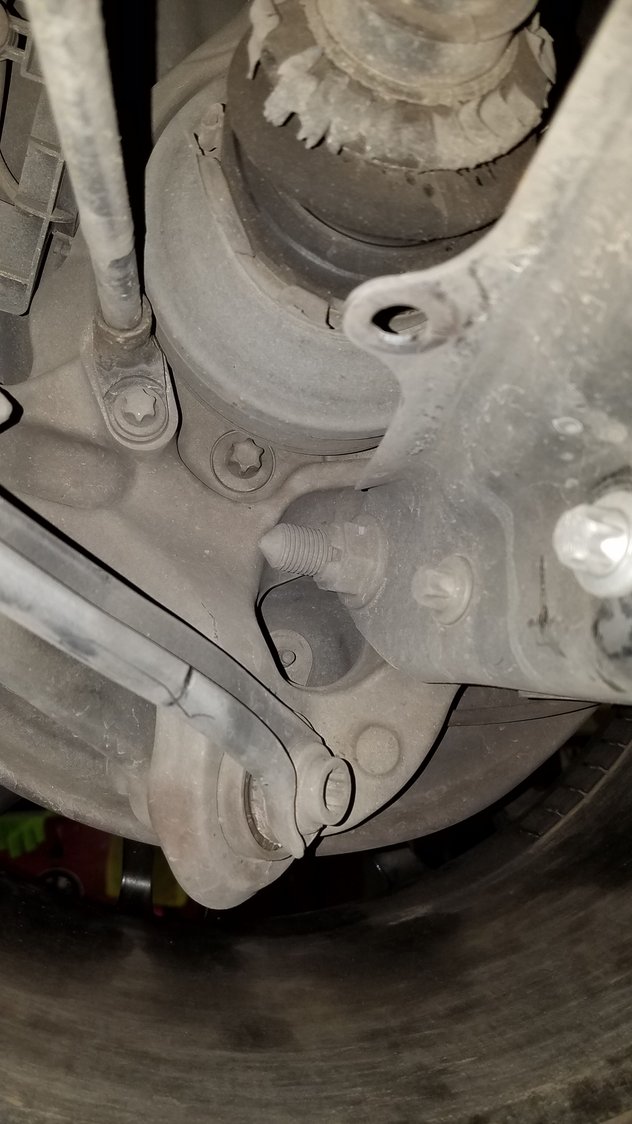

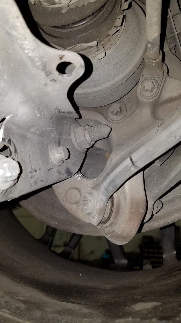

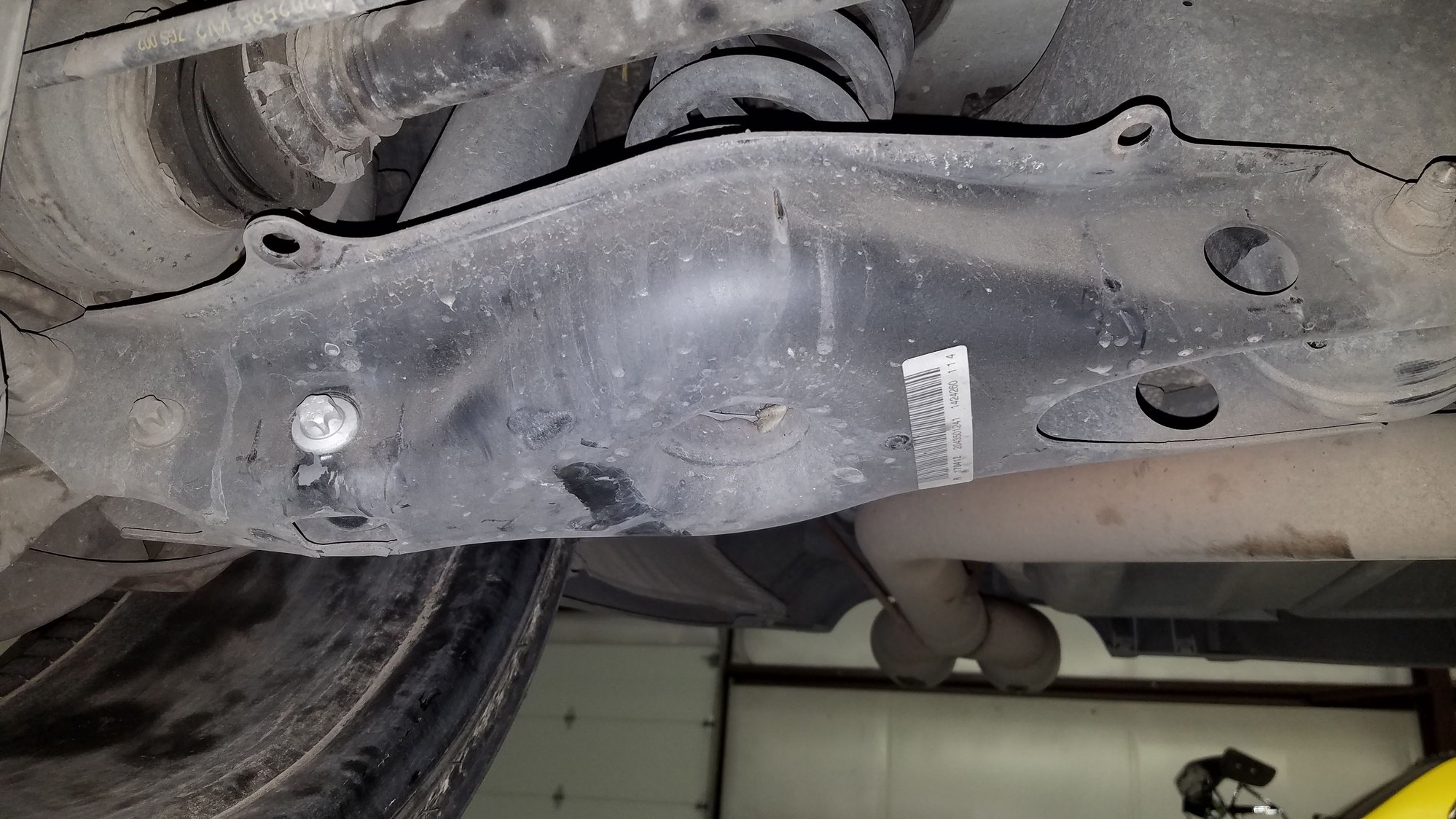

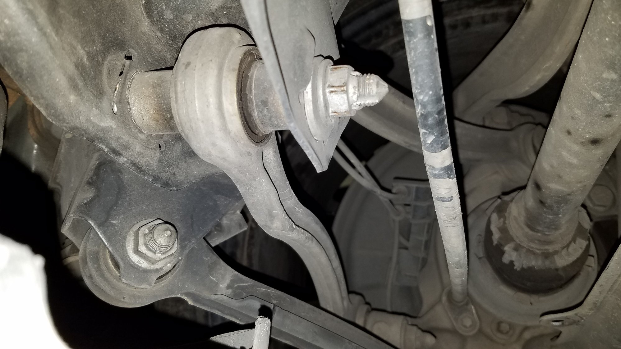

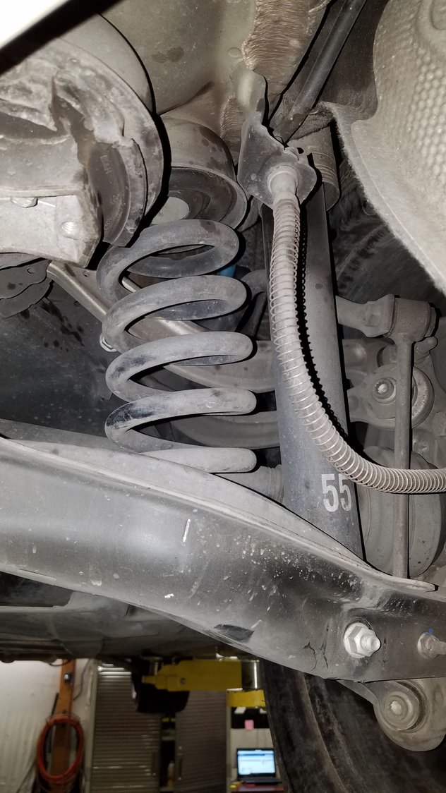

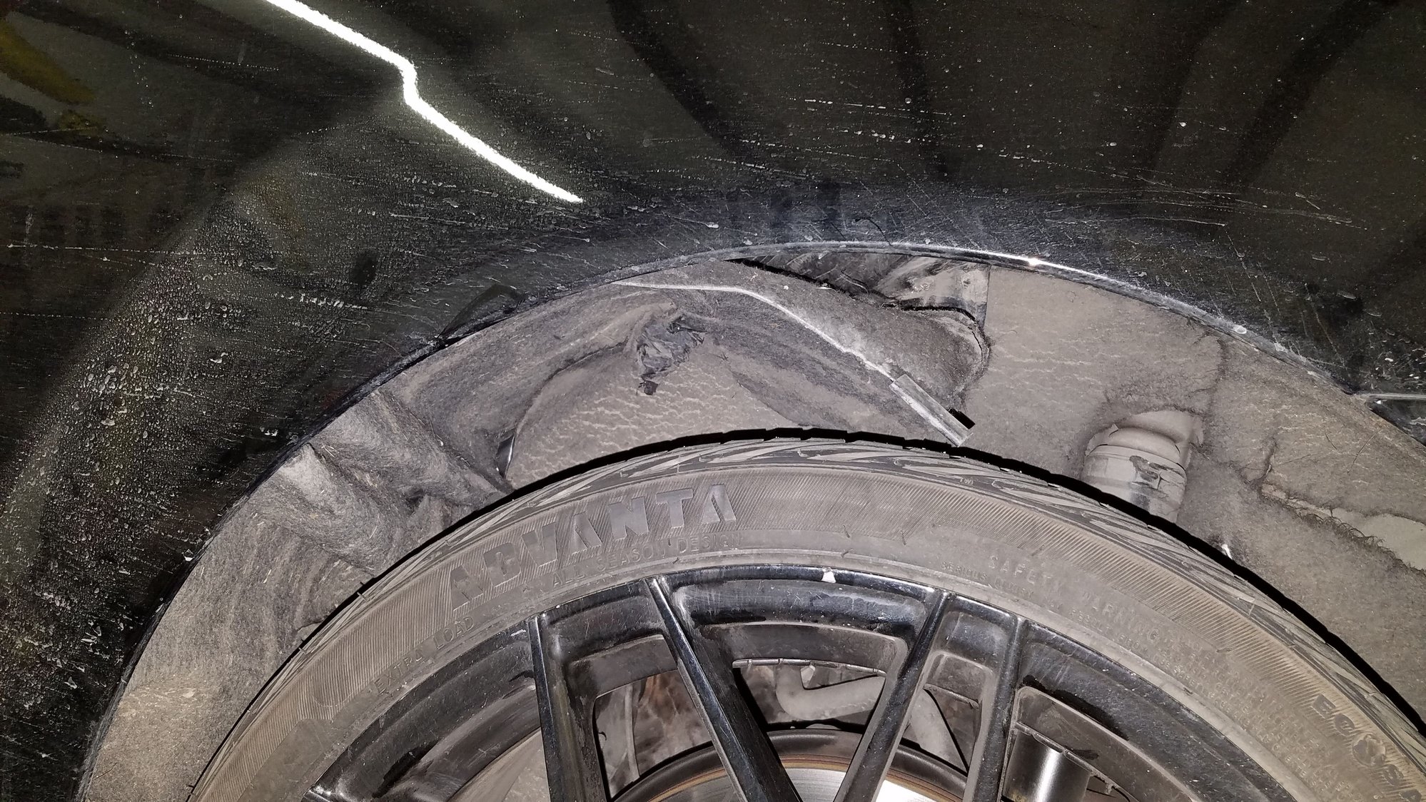

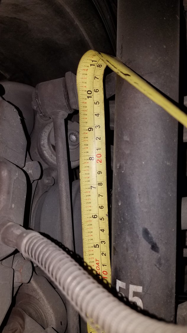

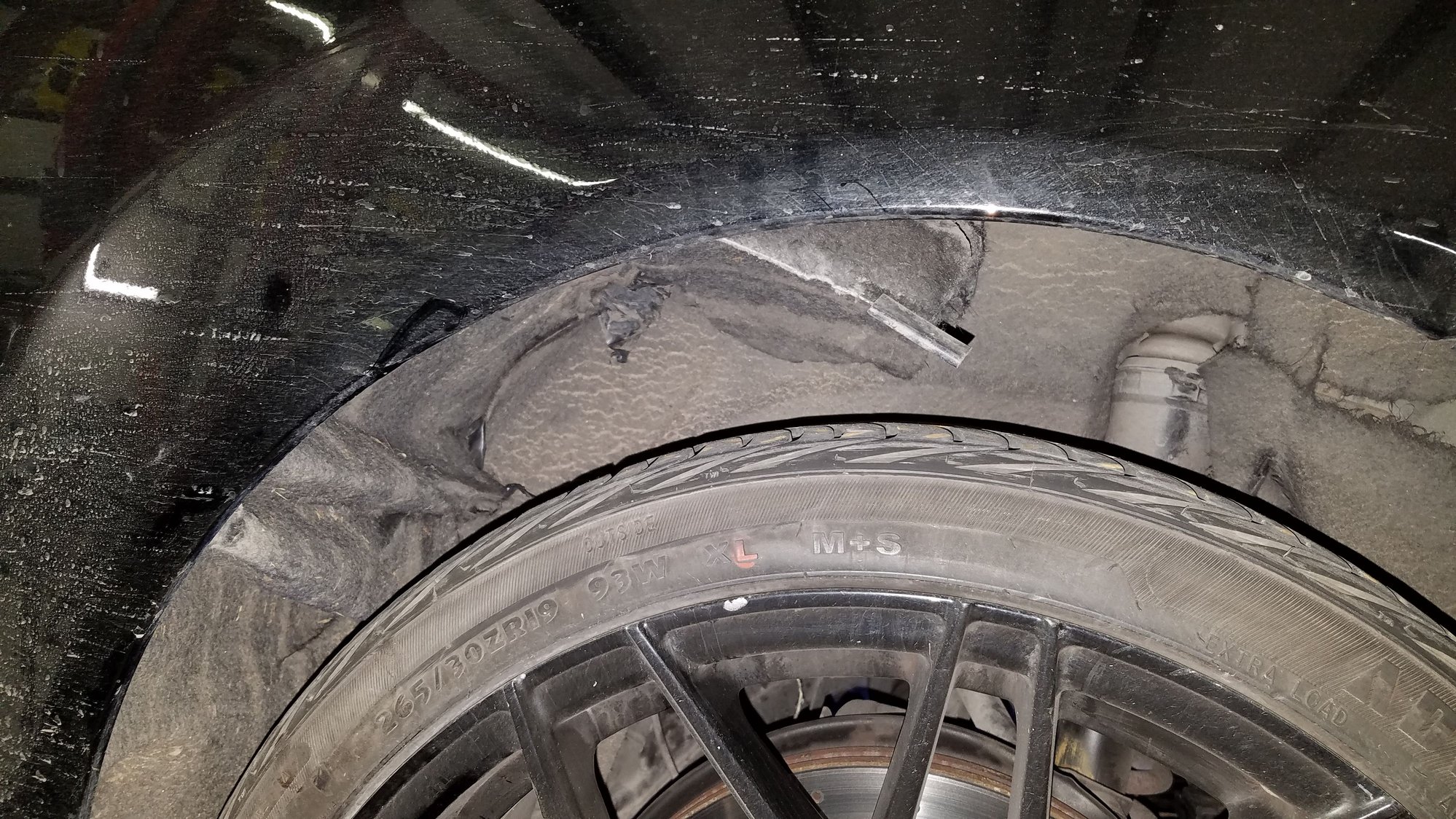

Initial pictures and free form tech notes. They are going to take some time and do a proper estimate/write-up soon. Looks fairly extensive but we are all on the same page with replacing with best combination of OE or Aftermarket. Tech notes are below if interested:
"2/2/2021 -Quickly assessed front suspension - found components of front suspension appear to be in proper order, no visibly damaged suspension, no play is present in suspension. Found RF wheel is bent.
2/2/2021 -After assessing damage, can conclude vehicle will NEED the following components replaced: -Both Rear Lower Spring Arms -Both Rear Shocks -Both Rear Suspension Springs (due to over-compression)
-LRWheel Bearing (recommend RR as well)
-Both Rear Wheels & Tires
-LR Fender Liner (either permanently removed or replaced)
-Alignment
The following components are not visibly damaged, but given the surrounding damage, highly recommend these components to be replaced as well:
-Both Rear Toe Links and Alignment Adjustment Hardware (due to shifting)
-Both Rear Spring Arm Plastic Covers (mounting tab broken on each cover)
-LR Knuckle (was contacted by broken spring arm - potentially bent - impossible to visually see - can confirm/deny once other components are repaired and alignment is being performed)
-Rear Sway Bar End Links
-Rear Sway Bar (Potentially bent - will know once other components are repaired and vehicle is sitting at appropriate ride height. Will be able to see if links line up with sway bar attachment points.)
2/2/2021 -Initially found LH rear of vehicle appears to be sitting lower than the rest of the vehicle. Raised vehicle on lift and found both rear shocks have bottomed out (limit of compression stroke) with suspension still traveling. This force caused the lower shock mounts to punch through LR lower control arm (and clearly bent control arm, pushing arm into knuckle), and begin deforming RR lower control arm (lower control arms = spring arms) (pictures). Further inspection shows the toe links have shifted within their chassis mounts (alignment adjustment points). Also found sway bar end links (sway bar side) have contacted brake caliper body on both sides (picture of LR, RR is similar). LR appears to have hit harder than RR - LR fender liner is torn due to contact with rotating tire (pictures). Rotating the rear wheels shows wheel bearing noise on LR; RR wheel bearing doesn't exhibit noise, but was subject to similar shock. While rotating wheels to check wheel bearings, found both rear wheels are bent,"

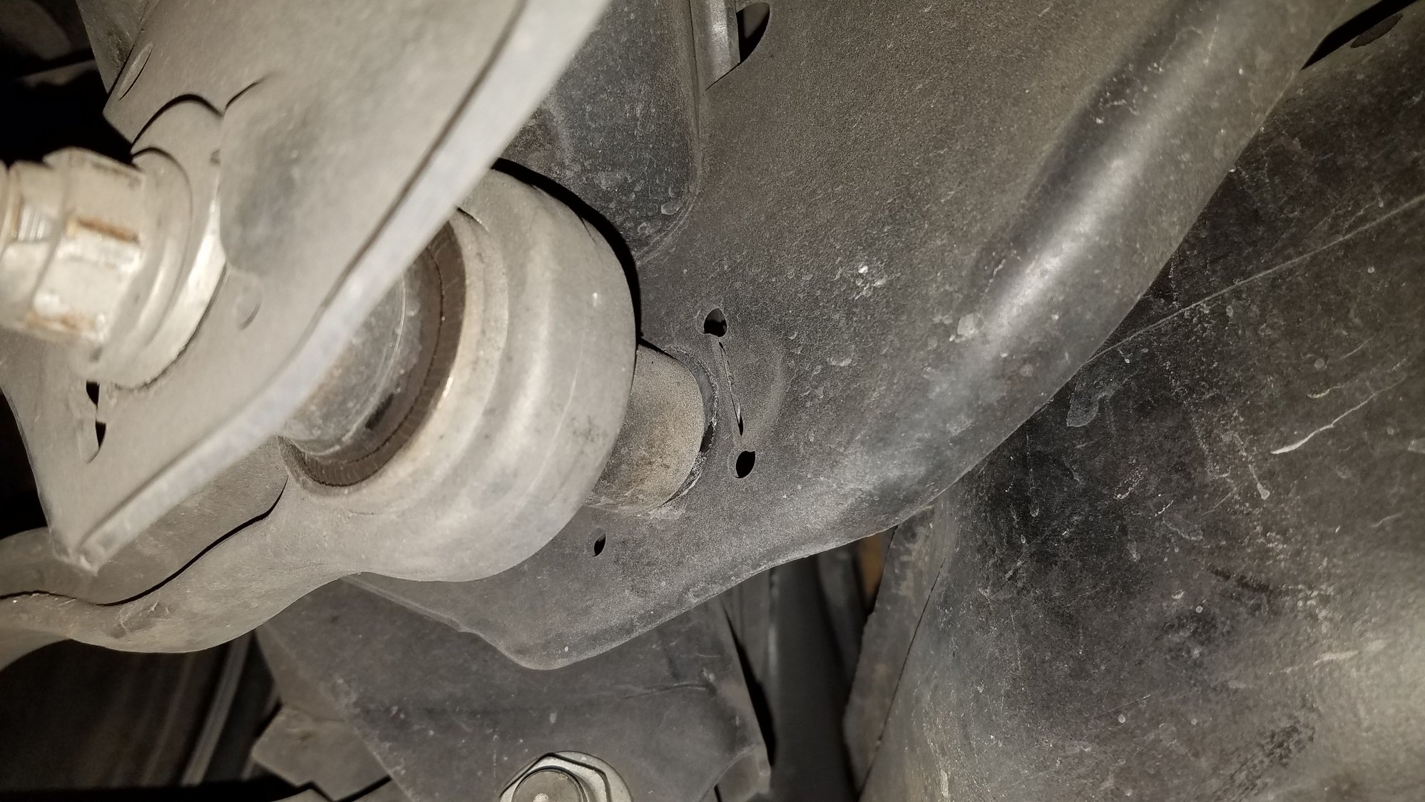

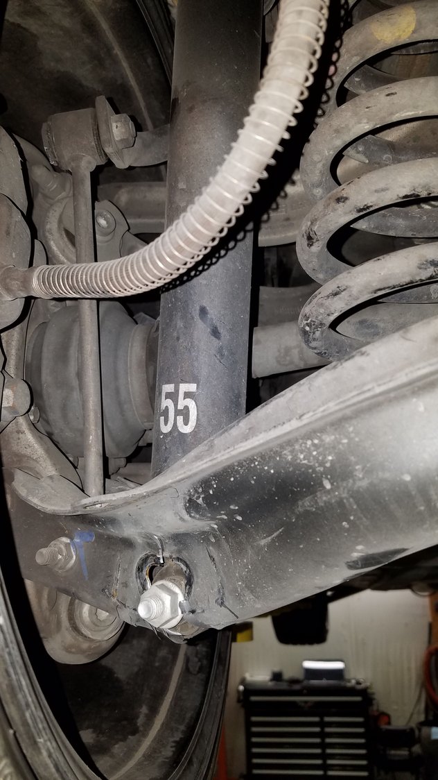

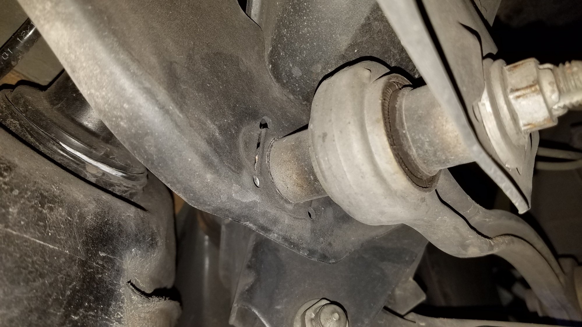

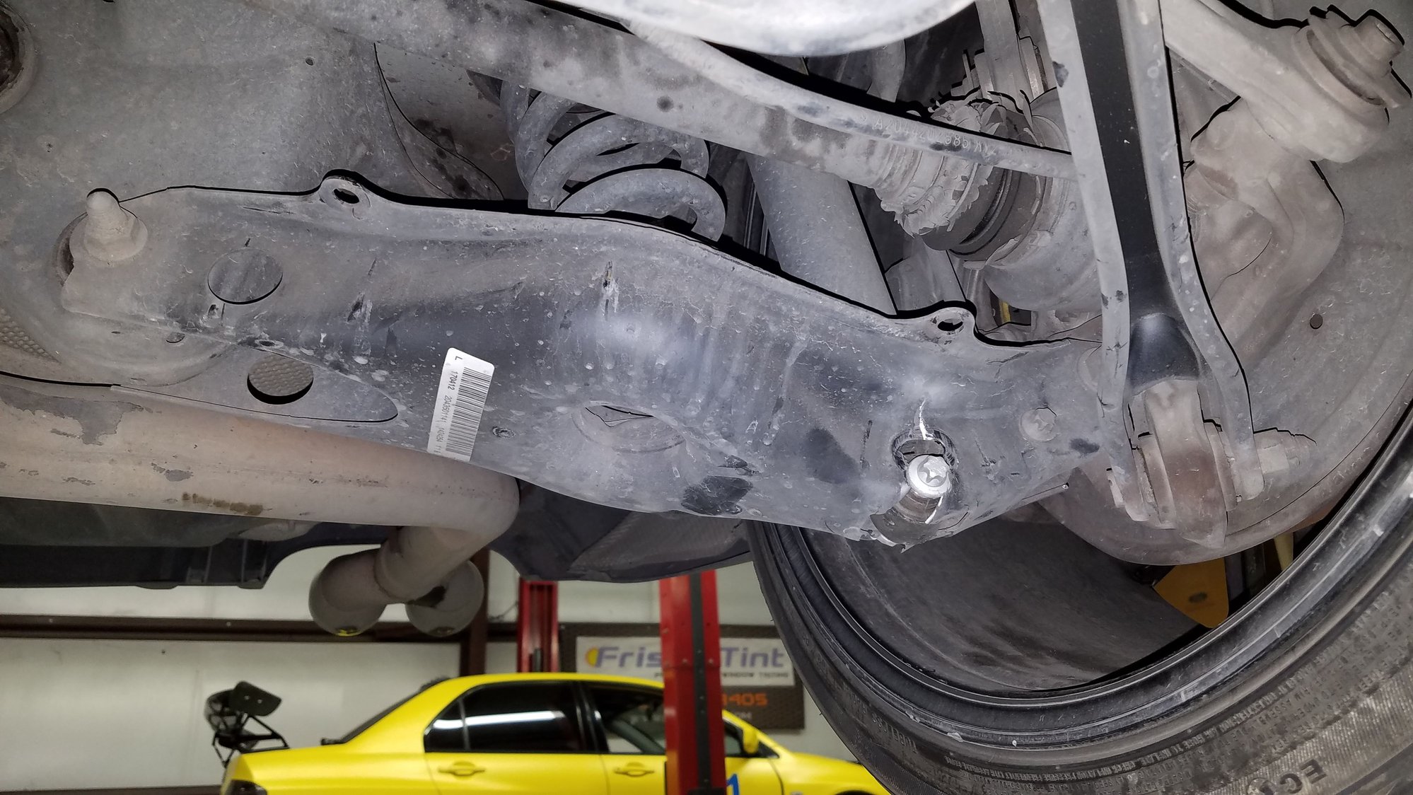

So the verdict is in...$10,000+ in damage using all OEM parts and labor book costs.
Here are the "large" suspension parts:
Suspension - Control Arm OEM Mercedes-Benz Rear Lower Spring/Control Arm Assembly; Fits Right or Left Sides
Suspension - Wheel Bearing - OEM Mercedes-Benz Rear Wheel Hub/Bearing; Fits Right or Left Side
Suspension - Rear Toe Arm - OEM Mercedes-Benz Rear Lateral/Toe Arm; Left Side
Suspension - Rear Toe Arm - OEM Mercedes-Benz Rear Lateral/Toe Arm; Right Side
Steering - Knuckle Assembly - OEM Mercedes-Benz Rear Knuckle/Spindle Assembly; Left Side
Suspension - Stabilizer Bar - OEM Mercedes-Benz Rear Sway/Stabilizer Bar
Suspension - Sway Bar End-links - OEM Mercedes-Benz Rear Sway Bar End-link; Right Side
Suspension - Sway Bar End-links - OEM Mercedes-Benz Rear Sway Bar End-link; Left Side
We are definitely going with KW or Bilstein coilovers all the way around for the absorption but for you experts....
Should we just stay with OE parts above or are they aftermarket options that we should investigate for the rear?
Here are some pics
