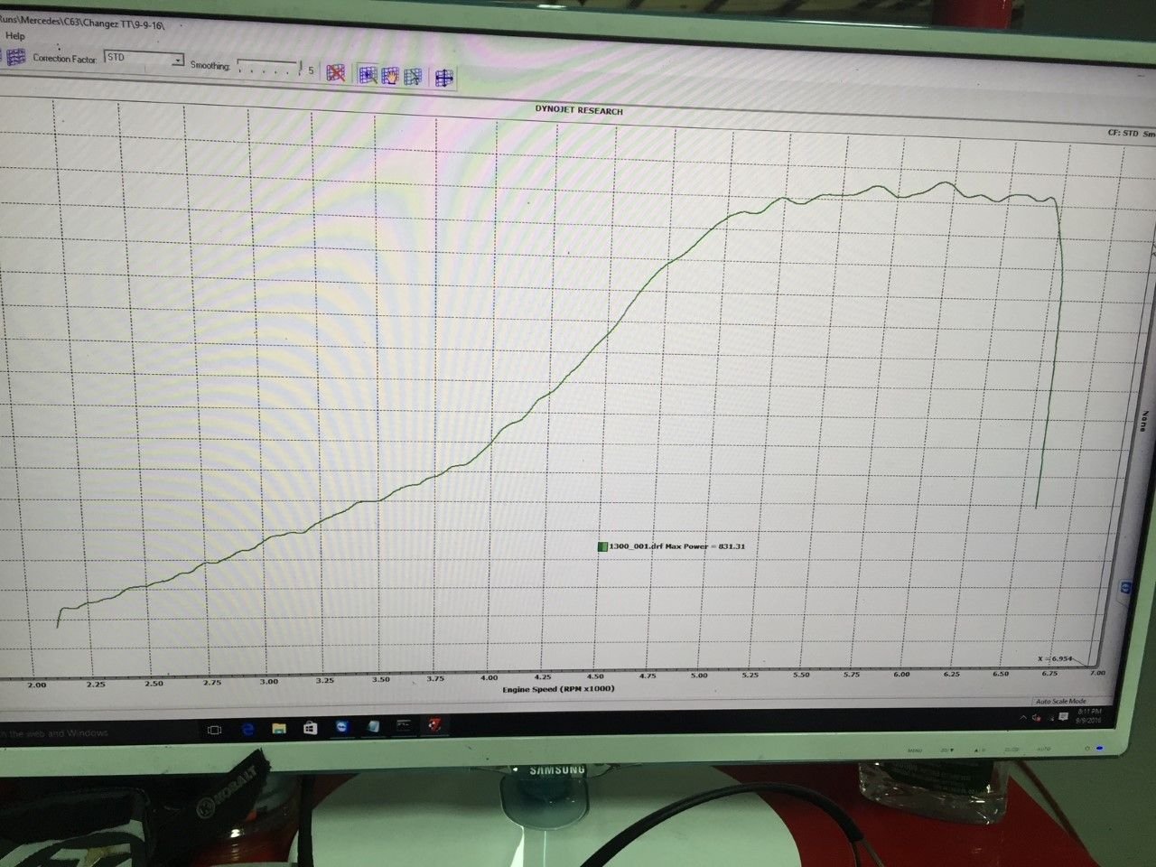

LOL Ran like crap....
FWIW we still have it, the owner of the car actually is a franchise partner now and still has it. He was actually just sending some parts out to make more power so stay TUNED for that one.
You are also correct anything over 6lb will blow the manifold (and did) But, when you have CNC machines in the company that's an easy fix.
We indeed didn't market it as the cost vs sales potential isn't really there. It is a lot of work to not only build and market, but a good amount on the customer to install. But....we know how to do it and could if anyone is truly interested
Oh and then there's this......

Impressive, what size turbos are those?
