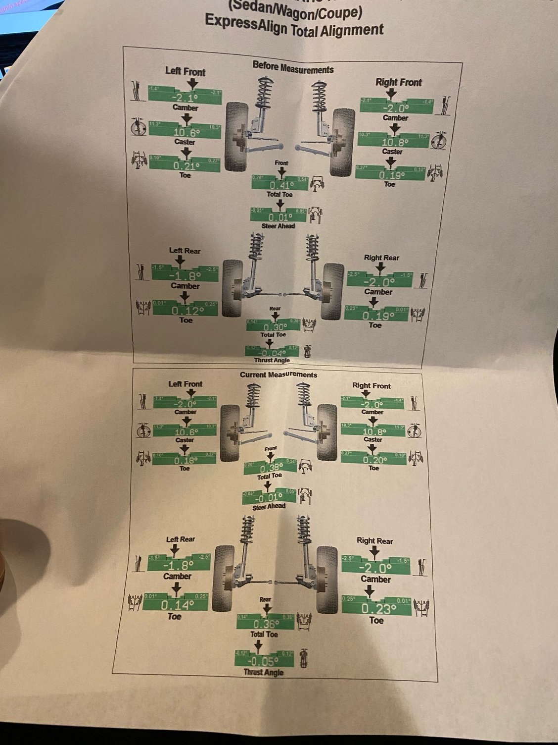

Old Jun 26, 2021 | 08:23 PM
Inturrisi's Avatar
Joined: Jan 2020
Posts: 59
Likes: 10
C63 AMG 507 Edition
How does this look guys? I do not know much about alignment specs lol.
Old Jun 28, 2021 | 02:01 PM
ExtremisTy's Avatar
Joined: Jan 2017
Posts: 30
C63 AMG Edition 507 Coupe
Again, I'm no mechanic, but it looks like you're within spec all the way around. So long as you're within spec, the steering wheel is straight, and the car drives as it should, you've got every reason to be happy.
