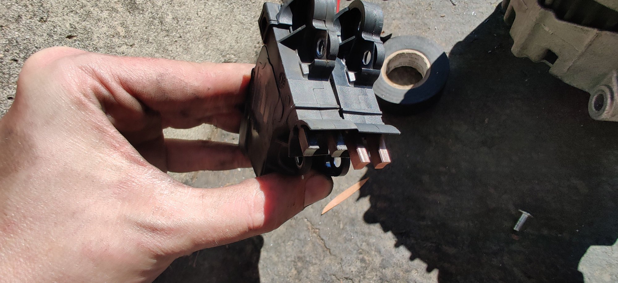

I tried tackling this job last week. The last bolt ended up getting stripped. Very tight space to work without pull down the steering rack. I'm currently sitting at 86k the connection plug that plugs in is very hard to remove any ideas on how to take this off?
Took me 30 mins before. I had to buy left handed drill bit and a right angle drill to remove the last screw which i will tackle today.

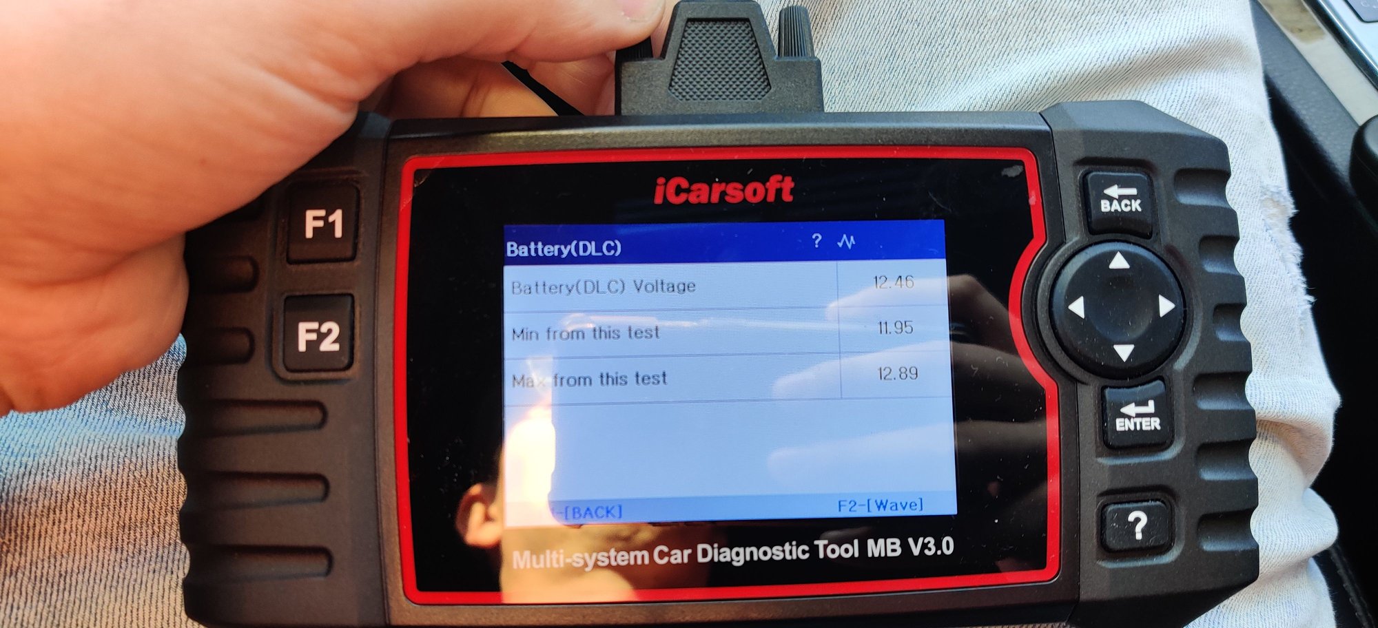

The last two days driving to work the car stop charging it would show 14 volts at start up and then go straight back down to 12.5. So i've been charging the battery. I will report back when i replace the voltage regulator. If this doesn't fix it then a new alternator

Wasn't too bad I couldn't get the last bolt out so I had to remove it. I also noticed under the car coolant leaking. I squeezed two of the big hoses could hear hissing coming from the thermostat housing. The black connector that comes off the housing cracked. At this point since I have everything out. Wondering if I should just buy a brand new Bosch alternator and pass on just doing the regulator.

Replaced voltage regulator also replaced thermostat plastic piece cracked and was leaking fluid. Car charges fine when cold 14.3-5 went for a drive went back down to 12.3-5. Came back parked the car pissed. Can't figure this out last ditch effort is to replace the alternator. if that doesn't work taking it to Mercedes.

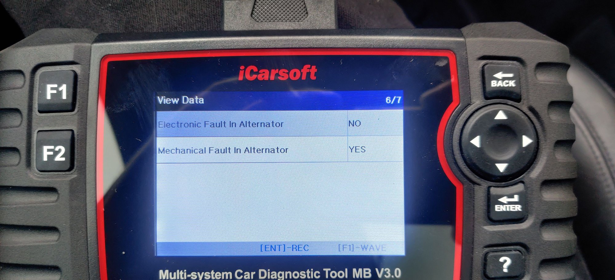

Currently has no DTC codes or check engine lights. I did notice on the alternator test. The mechanical fault in the alternator would say yes then no and just keep going back and forth. I ordered a Bosch alternator going to replace it. Kinda stumped on this one
