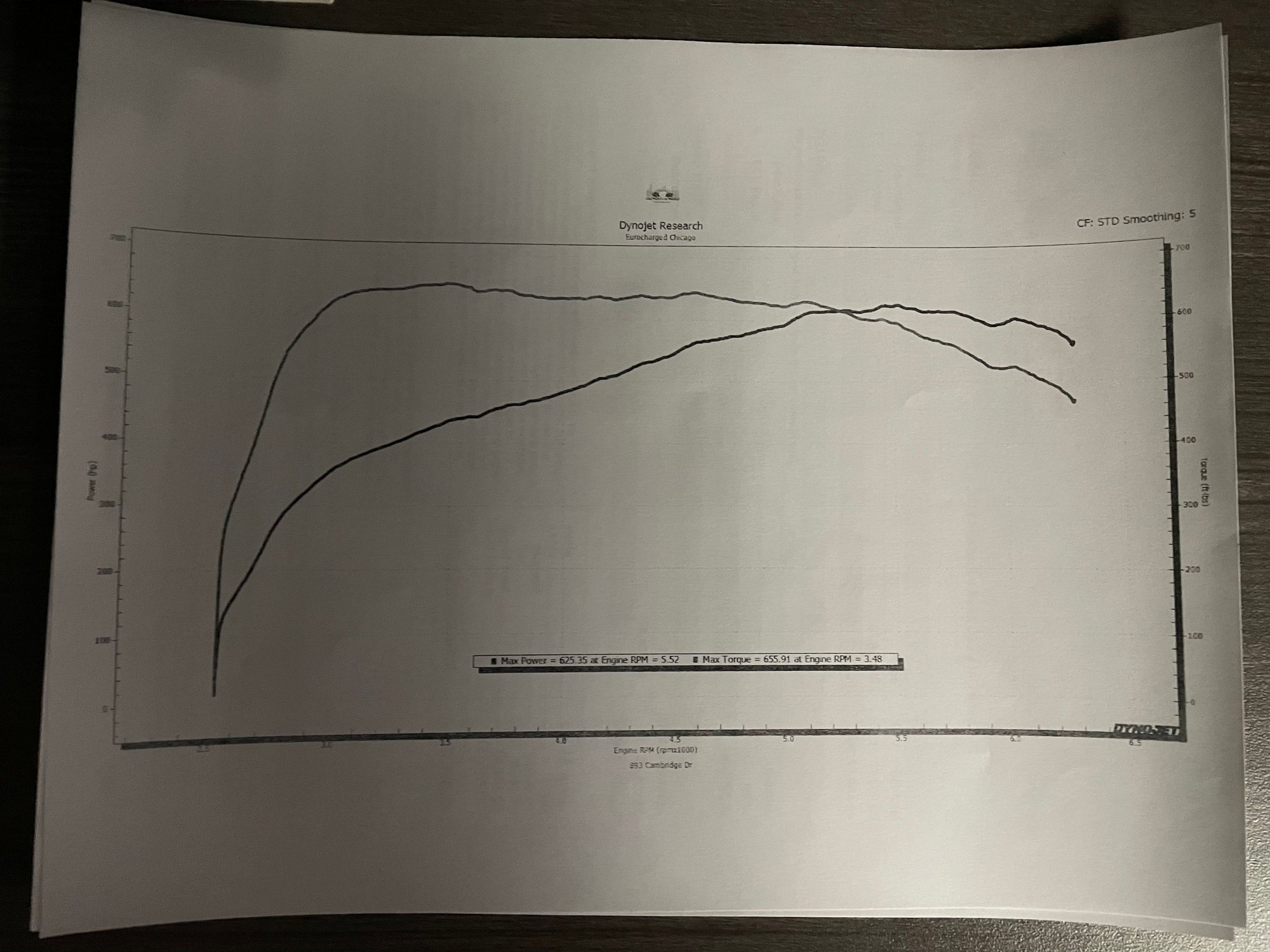

The car was bought through Mercedes-Benz and the previous owner of the car was someone that worked at HPTuners. I’m not sure who installed the SC but I had this problem previously and thought tuning the ecu at ( Eurocharged ) would fix it but still having the same issue. The car accelerates on auto normally, but as soon as you go into manual mode and press the throttle you hear the car rev but barely move ( the rpms don’t shoot up so I know the clutch is good ). I’m keeping the car for a long time and just want to sort out the problems.
Before the tune Eurocharged added catless headers and removed secondary cats and resonator. After about 80 miles I got a check engine light for p0420 -Catalyst system Efficiency Below threshold bank 1 and p0430 bank 2. I don’t think I noticed much of a power gain.
chart below.
Thank for all the comments and help!

Were you there when they ran it on the Dyno? Just one pull...?
I'm a little curious why your power curve trails off after 5500... it should be climbing basically to redline.
