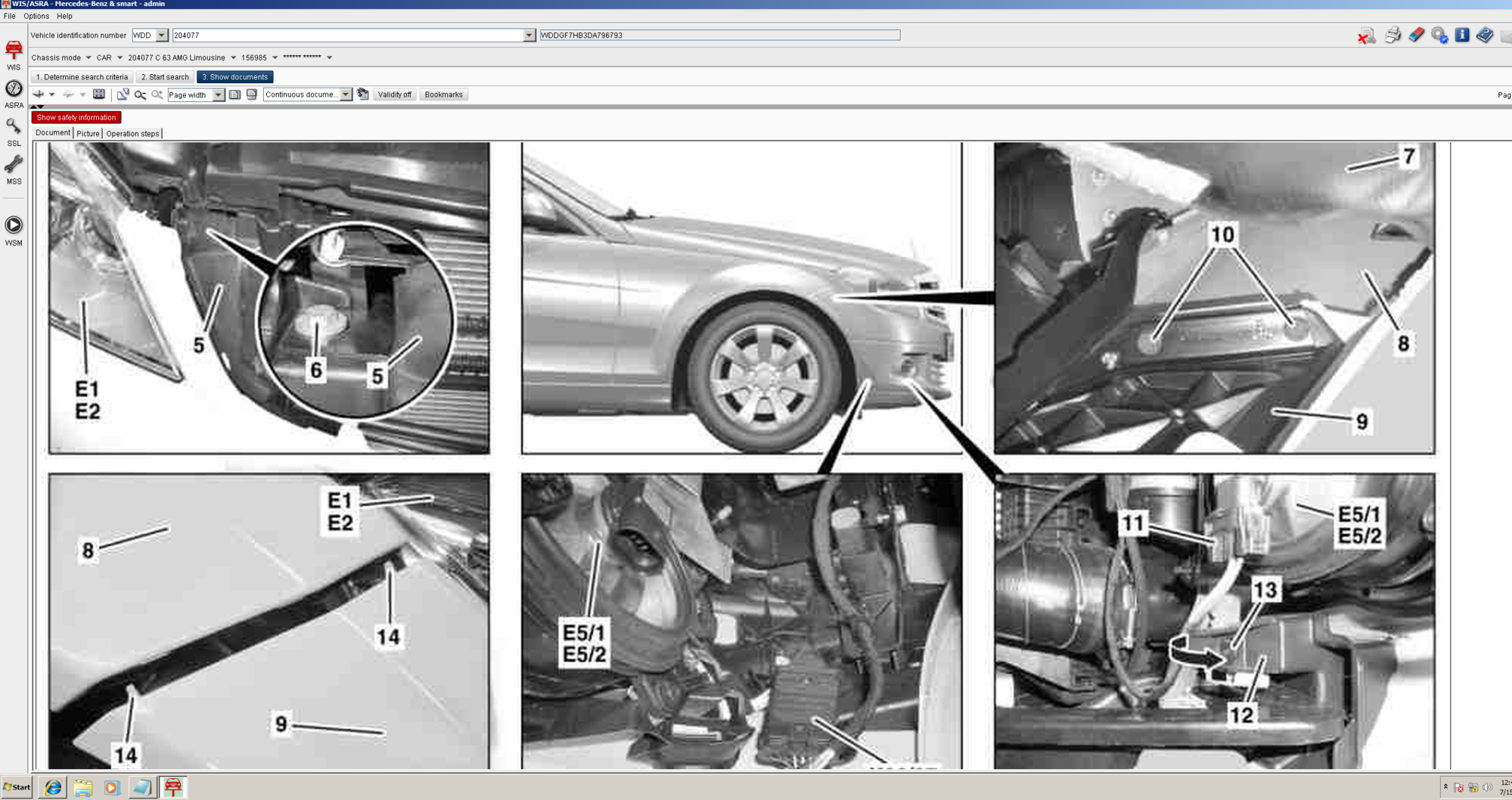

So I checked on the WIS to see the install instructions for the DRL, it shows to remove the front bumper. This might help on how to get started with the bumper https://mbworld.org/forums/c63-amg-w...ml#post6376102.

You can pull them out the front without removing the bumper. There was a post from a few years back about it with details that was just bumped a week or two ago. I’m not going to do the work for you, but a quick search should yield the result. It’s easy.
