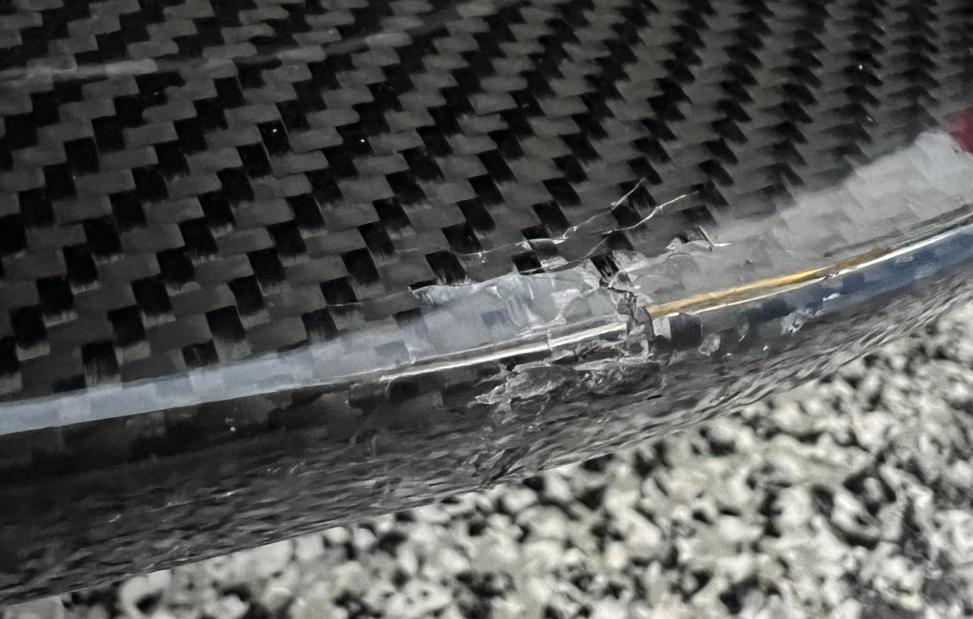

Well it lasted almost a year and wifey tapped a Belgian block today.
Is there a best way to touch this up? The carbon fiber underneath is reasonable. It’s just the cracked clear coat that makes it noticeable.

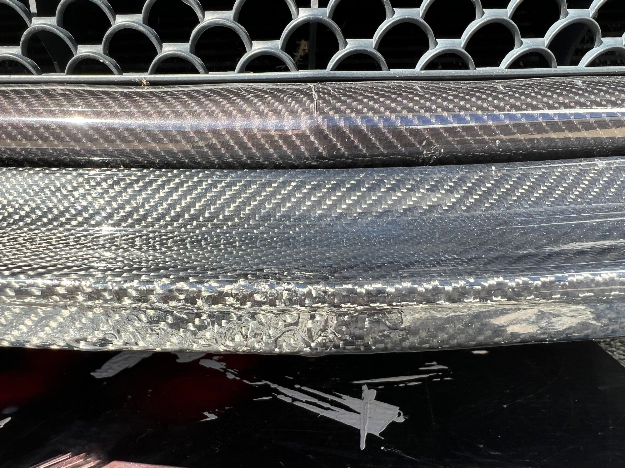

After carefully chipping off any cracked pieces, taping off good areas and drizzling in the resin, it self leveled down to this. I may just leave it alone from here. Nervous to even mess with a clear coat.

Old Sep 2, 2022 | 02:58 PM
chrisridebike8's Avatar
Joined: Nov 2012
Posts: 2,768
Likes: 419
'10 C63
I would agree. Leave it. Quit while you are ahead!
Old Sep 2, 2022 | 03:01 PM
hyperion667's Avatar
Posts: 31,274
Likes: 3,916
From: on my way
2012 CLS63
Wow, I think it looks pretty good I miss my aero parts Gave the car such an aggressive look.
Old Sep 2, 2022 | 05:10 PM
AMGSPY's Avatar
Joined: Feb 2020
Posts: 165
Likes: 53
2014 C63 507 Coupe
I think it looks really good too! I'm pretty picky and I could live with that. Good work and Congrats!
Old Sep 2, 2022 | 05:33 PM
roadkillrob's Avatar
Top Answer: 1
Joined: Aug 2016
Posts: 2,405
Likes: 724
12 C63BS Magno Alanite Grey, 25 X5 Msport, 08 BMW E93, Ducati Hyper 698
Looks good - when I fixed mine I had a body shop do the clear as I didn't want to tackle it either myself. As long as you used resin and hardener that has UV inhibitors in it like west system 207 hardener then should be no issues not clearing it, if you didn't use a resin/hardener with UV inhibitors in it, then that spot will yellow over time.
