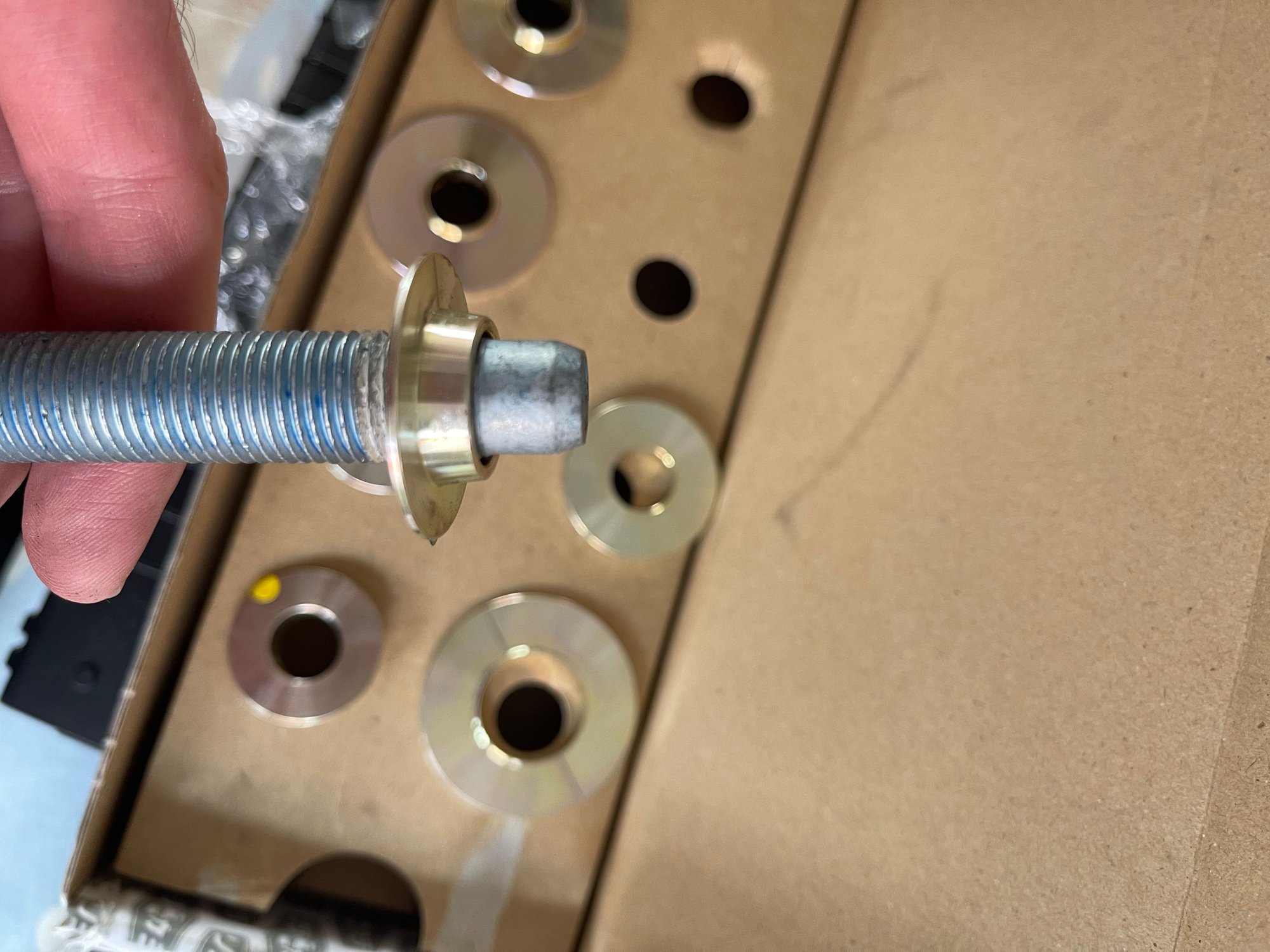

As above was getting all my suspension parts fitted today, Installed the spoon ridgid collars on the rear fine but then came to the fronts and the collars they have sent the internal hole is too small! Pretty annoyed as it means I will have to come back and pay for another geo/alignment.
Do you think they have supplied me the wrong size or for some reason on late model w204 c63’s mine being 2013 they made the subframe bolt bigger?. The reason I think it could be this is the small little ultra racing bars below the bottom bolt closest to the engine has the same issue being too small for the subframe bolt to pass through (at least with this I can use a drill to enlarge the hole) but I cannot do that with the little ridgid collar washers being thin and flimsy.

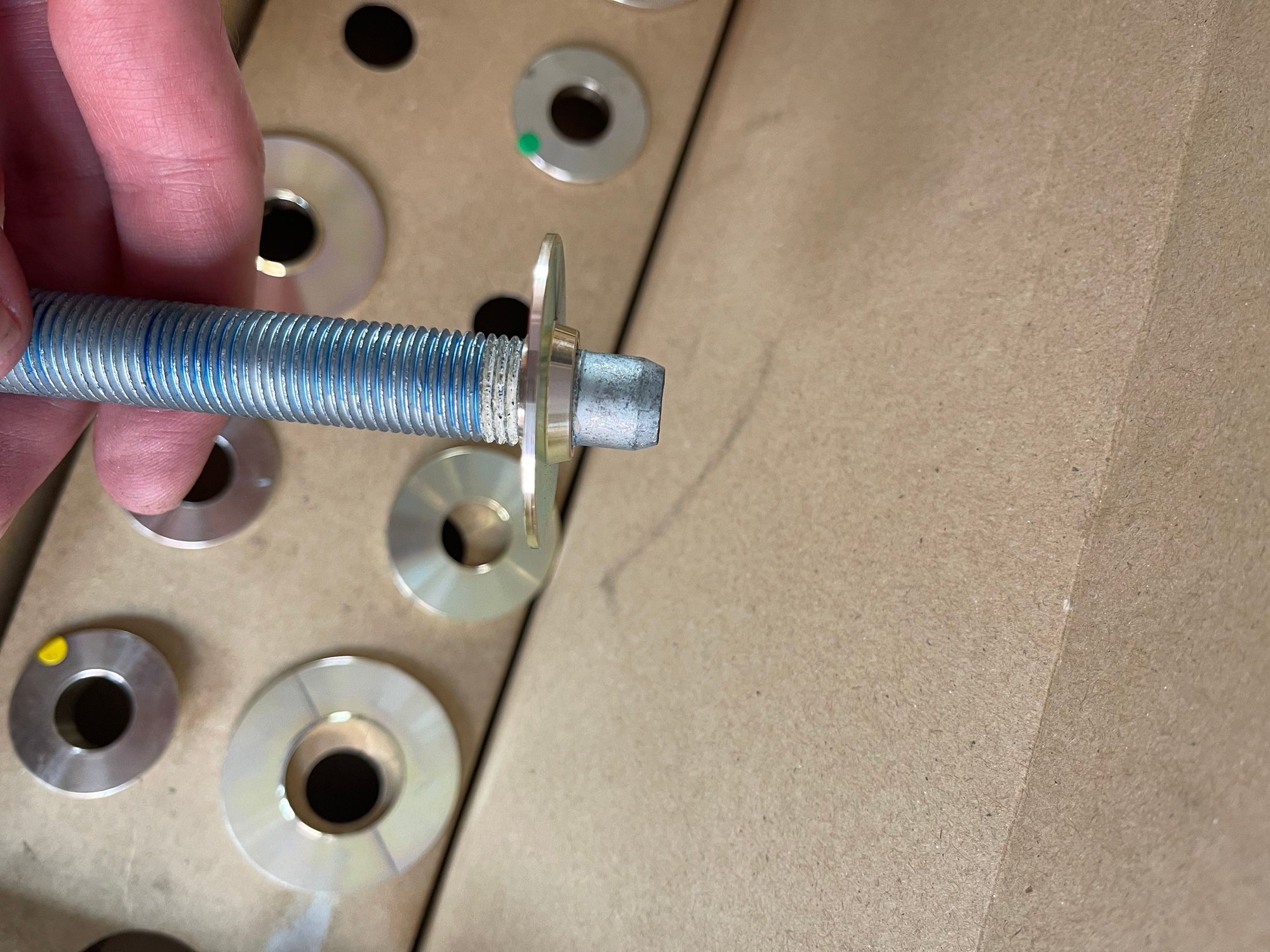

New spare front subframe bolt from Mercedes, as shown front Ridgid Collars too small.

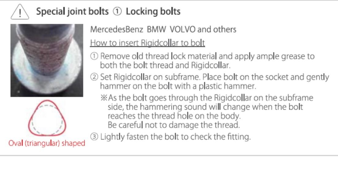

The front ridgid collars Spoon has got back to me with the below. Surely doing this will damage the threads on the subframe bolts and also the internal threads on the car that the subframe bolt goes into? They have said the collars for the Mercedes are triangular so remove the thread lock off the subframe bolt and hammer them in!! The rears didn’t need this at all.

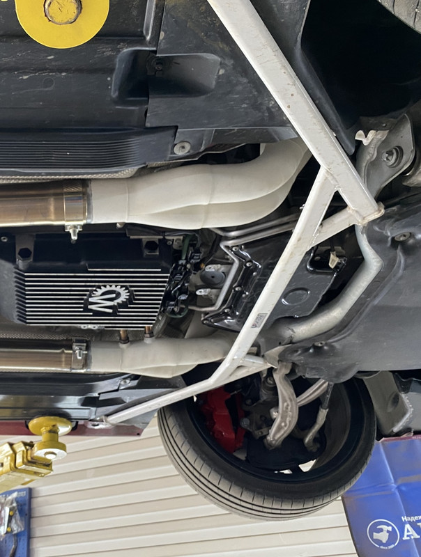

Originally Posted by Phil_T
Lastly does any have pictures of their large front underbody Ultra Racing brace that crosses over? Id like to see which undertrays you had to trim or remove completely after the install.

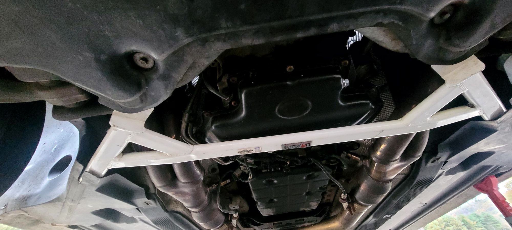

The Last undertray will need cut a bit that covers tranny area. The 2 side undertrays that go along rocker panel will need a slight cut on the folding seem as well. I'll upload a couple pics as soon as I can.
AS you can see i have my rear tray off in the pic but I had to cut just a smidge more where my header cuts out was anyway, the rest will be snug but you can bolt it right over it really with no issue.

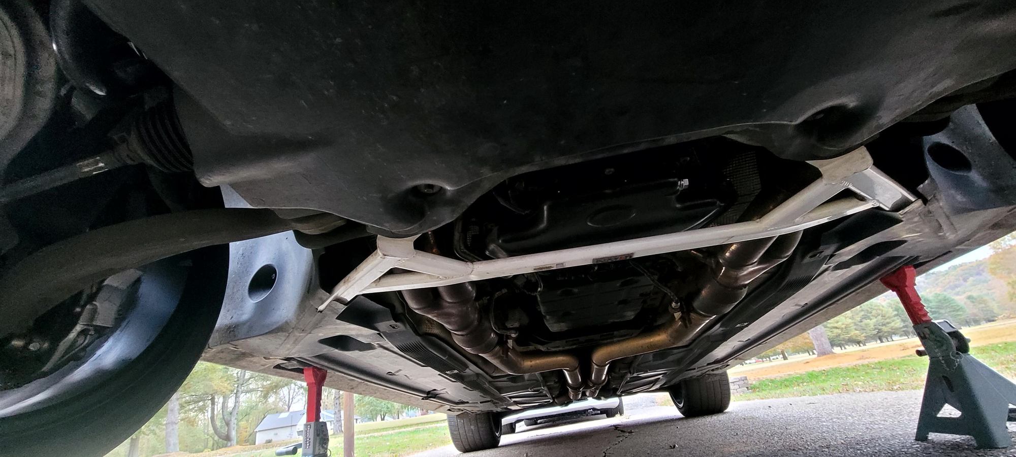

This is my. No problem.

Thanks, My original installer did not fit back them small triangular side pieces on the very ends of the bar fixing points so you can see the floor which looks odd.

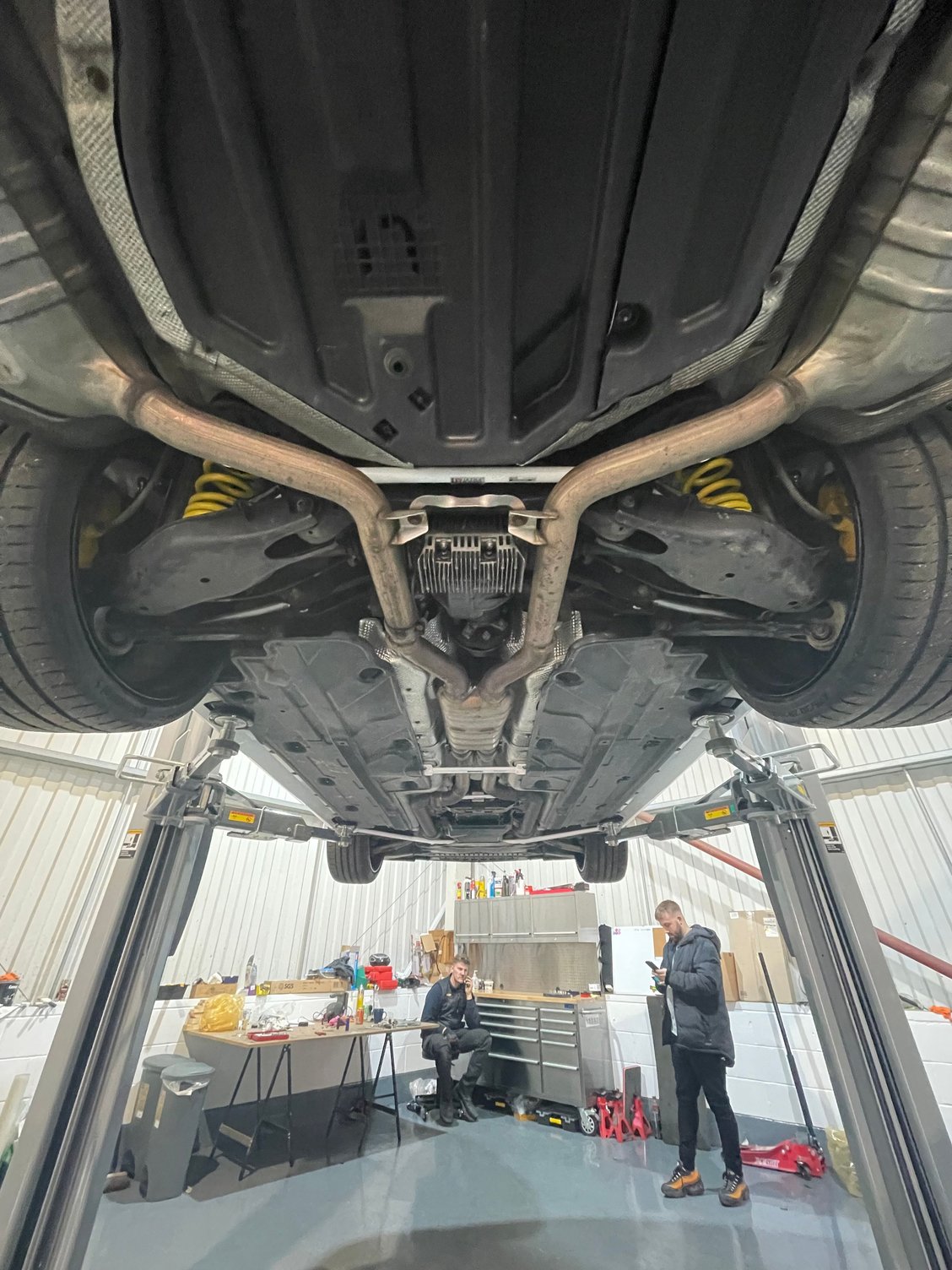

In the end I managed to get both side undertrays fitted over the bars without any trimming, the middle trans cover fitted back on with just the side circular parts around the cats cut.
Can any help with fitting the Spoon Ridgid Collar front set for these, as the subframe has to be dropped did you have to use an engine hoist to support it from the engine bay?
My installer only works on BMW’s but is willing to do the job but seems to think because you have to drop the subframe to fit the upper collars it needs an engine hoist to support from the engine bay.
